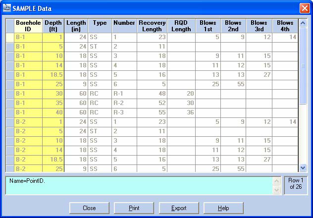

The View Entire Table option in the Tables menu provides a quick way to look for particular data values across multiple boreholes.
Using View Entire Table to Locate Information
  1. Go to INPUT and open a project with at least a few boreholes.
  2. Click on tab with a lot of data, such as the Sample tab.
  3. Select Tables->View Entire Table. The multiple-borehole record list window for the SAMPLE table appears.
  4. Notice that all SAMPLE records for all boreholes are listed, initially in order of Depth within each Borehole ID (PointID).
  5. Click on the light blue column header cell for the Type column. Notice that the list sorts into Type order, enabling you to locate all samples of a given type across all boreholes. You can do this with any column displayed.
  6. Click the Close button.
