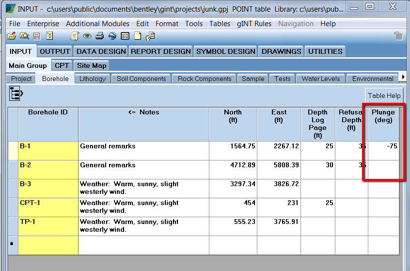

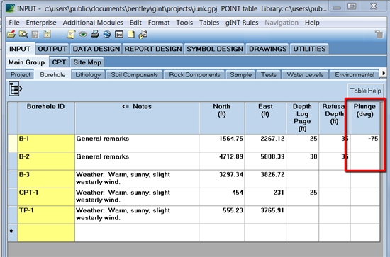

  1. In INPUT, enter the angle of the borehole in the Plunge  field on the Borehole (or Point) tab/table.

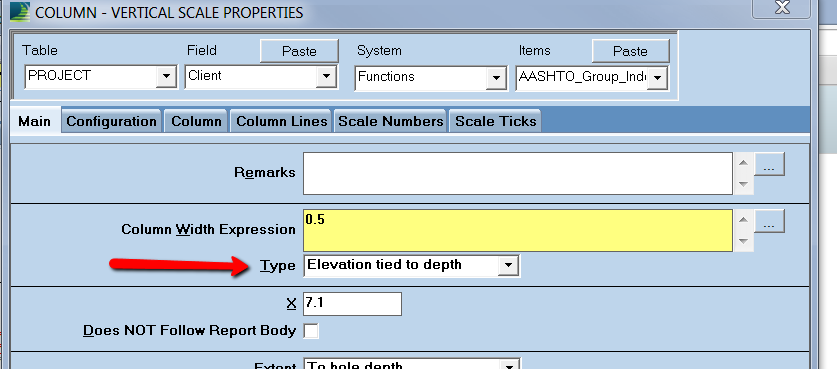

  2. In a vertical scale column properties, there are two elevation Type options: Elevation and Elevation Tied to Depth.
    Select Elevation Tied to Depth.

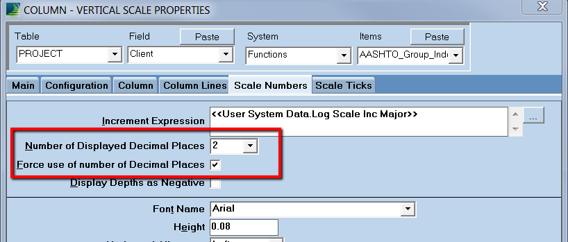

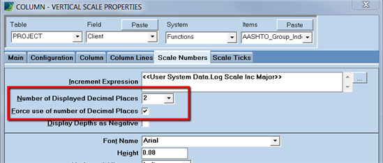

  3. This is likely to cause the elevations to print with many decimals.  To fix this, in the column properties, go to the Scale Numbers tab.  Select desired Number of Displayed Decimal Places, and check Force use of number of Decimal Places.
