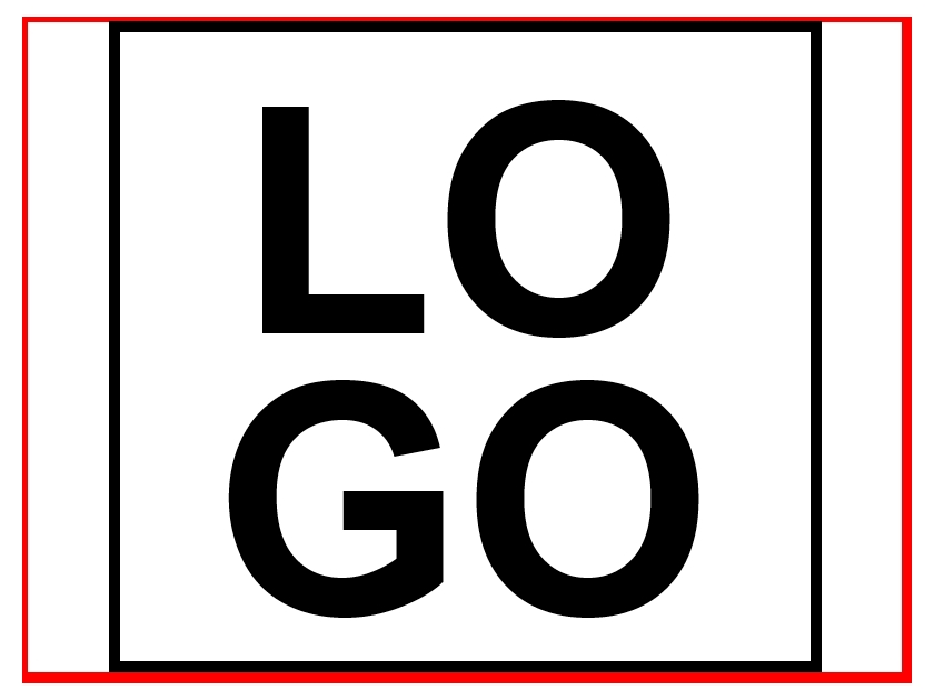

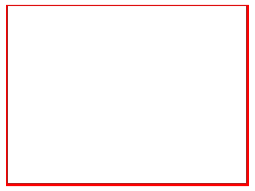

As maintaining the aspect ratio of a logo is important (that is, if a logo is resized the ratio between vertical and horizontal sizing must be retained) the placeholder provides an insertion point but doesn't change the shape. Instead, there is a buffer around the edge of the placeholder, illustrated by the red rectangle below:
Where a logo is inserted into the placeholder position it is expanded until the border of the logo meets this buffer. At this point the logo size is set. The following image illustrates how a logo is sized in the context of the buffer (again, represented by the red rectangle):
In this example the contents of the black rectangle are the logo image actually nominated as 'Logo1'.
