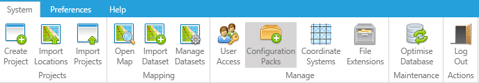

With no project open go to 'System | Configuration Packs':

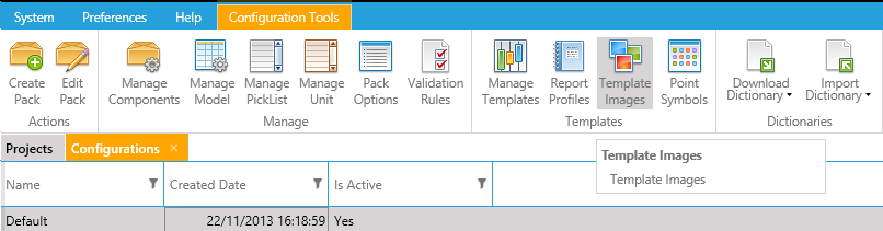

From within here, select the configuration pack that your project belongs to, then select 'Template Images' from the ribbon;

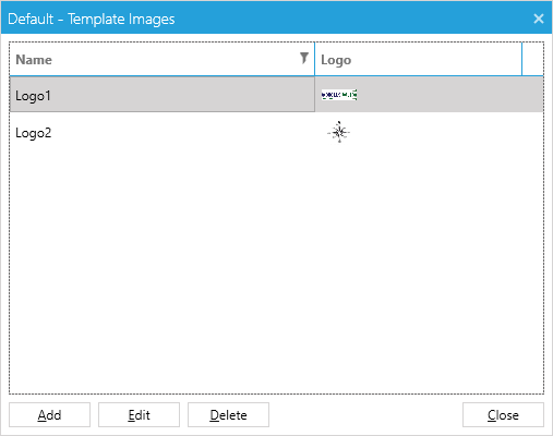

From the 'Template Images' window select the logo that you wish to replace and select the 'Edit' button:
A browse window will then open - select your required logo file.
Note: HoleBASE3.1 users were restricted to .bmp files for their logo selection. HoleBASESI does not have this restriction, supporting all conventional image file types.
