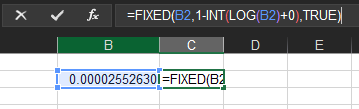

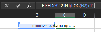

The best way to control significant figures in KeyLAB is to use an equation below.
=FIXED([Number],[number of significant figures-1]-INT(LOG[Number])+0),TRUE)
