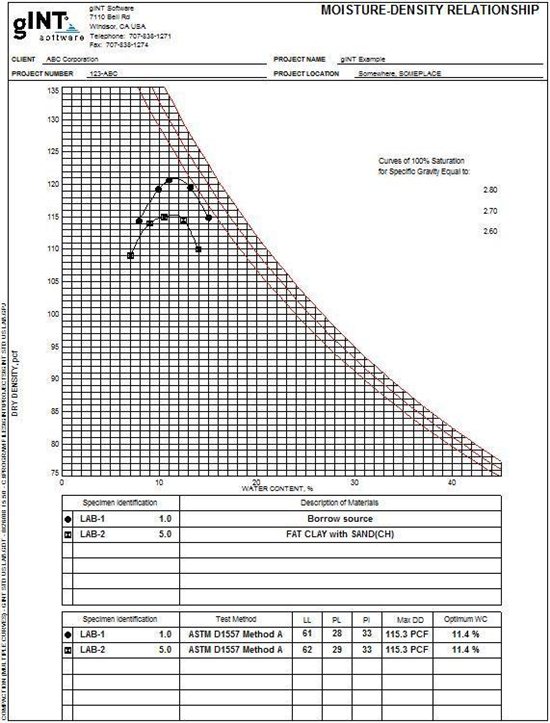

Draw Curves on Graph Reports from Equations
Curves defined by equation can be drawn on Graph Reports.
The curved red lines along the right edge of the Moisture-Density plot below were drawn by specifying a curve equation as part of the report properties:
Curves on CompactionPlot.jpg (102.88 KiB) Viewed 119 times
In addition, the right-most curve was used to trim the graph to create the clear white space at the right where no data would be plotted. Curves drawn in this way can have output conditions applied so that they will not be printed unless the output conditions are met.
A similar capability is the Fixed Curve, in which the curve expression (or a drawn shape) is defined and stored with a user-defined name in the Symbols library. Such fixed curves can then be selected in the report properties and applied to the Graph report, but cannot be edited in Report Design.
