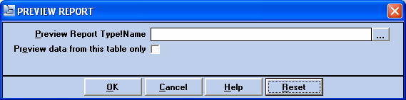

  4. Select Tables->Preview Report. The PREVIEW REPORT dialog box opens.

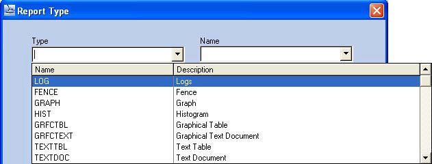

  5. Click the Browse   button to the right of Preview Report Type!Name. The ‘Report Type’ dialog box appears.
  6. This is for selection of a report type, such as Logs, Fences or Graphs.

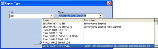

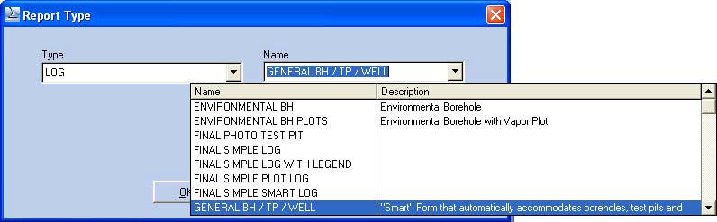

  7. Select ‘LOG’. Click the drop-down arrow on the Name property. A new selection list appears.
  8. The list contains all the log report forms in the current library.
  9. Select ‘GENERAL BH/TP/WELL’.
  10. Click OK. The ‘Preview Report’ dialog box reappears with a report name.

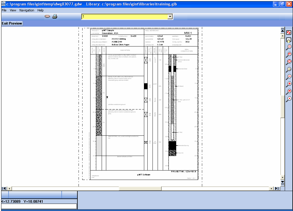

To preview your data in the preview report you specified, do the following:
  1. Select File->Print->Preview or click the Preview   icon.
  2. Click OK to preview the report. The program displays the report in preview mode.
  3. Click the Exit Preview   icon or tab to close the preview and return to INPUT.
gINT remembers your most recent settings in INPUT and opens the same report form if you preview again in the same INPUT table tab. This creates a one-click means to get from the data input grid to a preview of the report.
