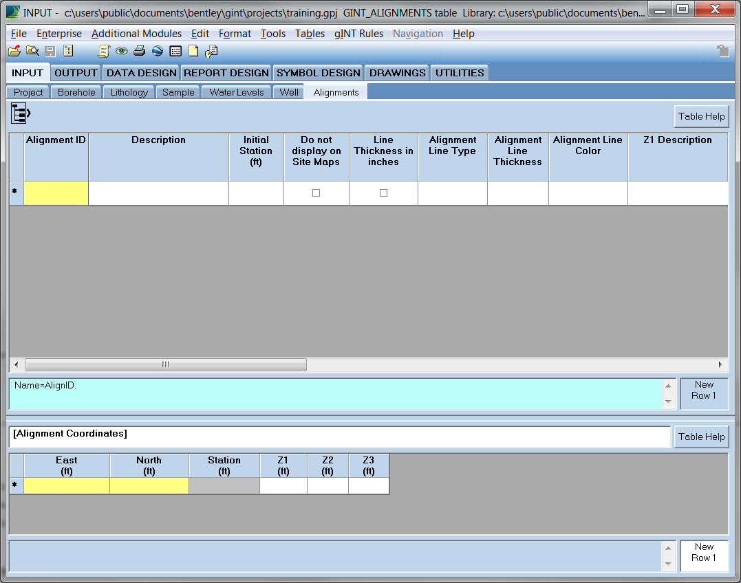

Select Additional Modules -> Alignments Support. This adds the alignments support module, indicated with a checkmark next to the menu option.

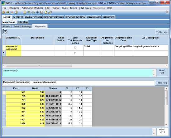

Notice that there is now an Alignments tab in the Main group. Click this tab. The split screen for alignment data entry appears:
The upper grid is for the GINT_ALIGNMENTS table, captioned as Alignments. You create one parent record here for each road alignment or stored baseline.
The lower grid is for the GINT_ALIGNMENT_COORDS table, captioned as Alignment Coordinates. For each parent GINT_ALIGNMENTS record in the upper grid, this lower grid holds the coordinates that define the path of the alignment.
In the Alignment ID field in the upper grid, enter ‘1st Baseline’.
In the lower grid, if the East column is to the right of the North, drag the East column header to the left so that it is the first column.
Enter the following values in the lower grid:

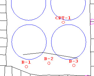

Go to OUTPUT -> Fences.

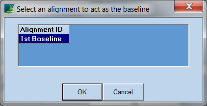

Click the Browse button to the left of Use Alignment (under FENCE OPTIONS). Select ‘1st Baseline’ and click OK.
Notice that ‘1st Baseline’ appears in the Baseline field, indicating that this alignment is providing the baseline for the fence report.
Click the Site Layout button. Notice that the alignment/baseline is drawn just above the three lower points.

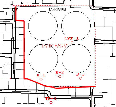

This is the same process for drawing a baseline as was described in “Creating a Custom Baseline.” However, after we draw the baseline, we will copy the baseline points to the Alignments tab to save the baseline as an alignment.
Do the following:
Zoom in on the tank farm area and its immediate surroundings using the Zoom Window tool.
Select Fence Spec -> Deselect Alignment for Baseline.
Select Fence Spec -> Draw Baseline.
Draw a custom baseline from the upper left corner of the tank farm to the lower right, following the tank farm boundary. Click OK.
Close the site layout view.
Highlight the set of East and North values by dragging with the mouse. Press Ctrl+C (Copy).
Click OK. Go to INPUT -> Alignments.
Enter ‘2nd Baseline’ in the Alignment ID cell in the second row.
Click in the East cell in the lower grid. Press Ctrl+V (Paste). This creates an alignment from the points that you drew in OUTPUT.

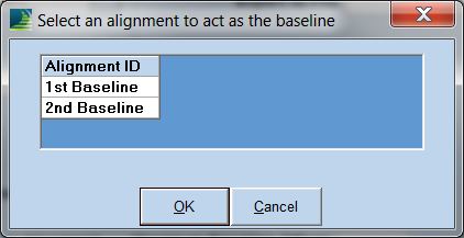

Go to OUTPUT. Click the Browse button to the left of Use Alignment.
As you can see, you now have two stored baselines that you can choose between.

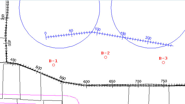

Zoom in on the alignment line just above the B-1, B-2 and B-3 boreholes. Notice that the alignment is represented with a simple series of line segments, with no scale markings.

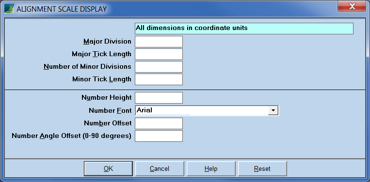

Select Site Map -> Alignment Scale Display.
Enter the following values, then click OK:
| Property | Value |
| Major Division | 50 |
| Major Tick Length | 10 |
| Number of Minor Divisions | 10 |
| Minor Tick Length | 5 |
| Number Height | 5 |
The length and height units are in distance units, not page units. For example, a Major Tick Length of ‘10’ means 10 feet or 10 meters long (whatever your units are), not some number of millimeters or inches on the page.
Notice that the two alignments in the site map now have scale markings.

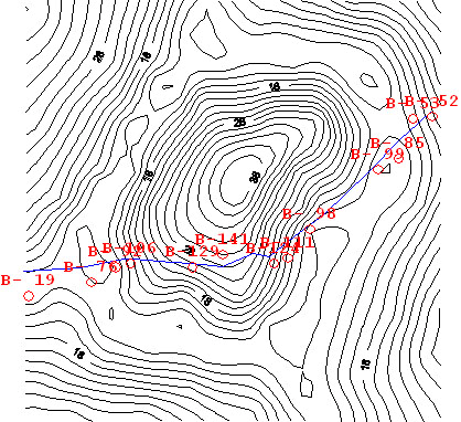

Click the Point tab. Notice that there are 13 boreholes.
Click the Site Map tab. Notice that a site map of a hilly area has been included in the project, and the borehole locations are plotted.
The blue line between the boreholes is the alignment called ‘main road alignment’. Any alignments you define in the project will be plotted in Site Map view.

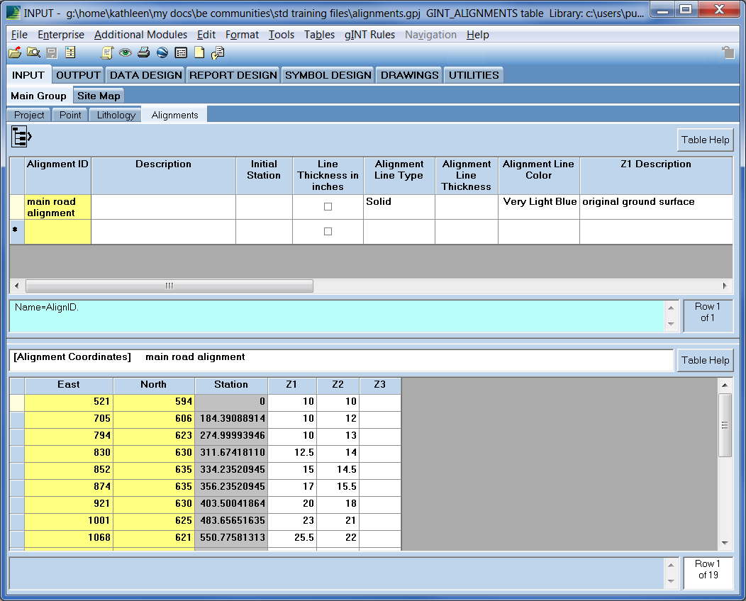

Click the Input tab to close the Site Map view. Click the Alignment tab.
There is one parent alignment (GINT_ALIGNMENTS) record, with an Alignment ID of ‘main road alignment’.
The parent record has 20 child Alignment Coordinates (GINT_ALIGNMENT_COORDS) records in the lower grid, each defining a measuring point along the alignment.
The child Alignment Coordinates records have Z1 and Z2 values, which were not used in the previous “saved baseline” examples.
Station (chainage) values have been calculated for all of the child records.
The set of Z1 values in the child records has a corresponding Z1 Description (‘original ground surface’), Z1 Line Thickness, and Z1 Color in the parent record. The Z2 values also have a Z2 Description (‘final graded surface’) and line and color fields.

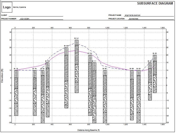

Go to OUTPUT -> Fences. Make sure that ‘STRATIGRAPHY & GW - A SIZE’ is selected in the object selector.
Click the Use Alignment Browse button. Select Main Road Alignment and click OK.
Preview the report.
Notice that the Z1 (‘original ground surface’) and Z2 (‘final graded surface’) curves are plotted for the ‘main road alignment’. The Z1 (original) curve is a blue dashed line, as specified in the GINT_ALIGNMENTS record. The Z2 (final) curve is a magenta solid line.
