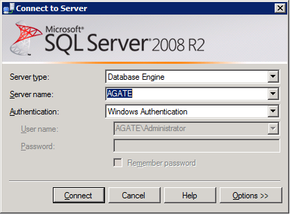

Connect to the SQL database
  1. Connect to a SQL Server instance:

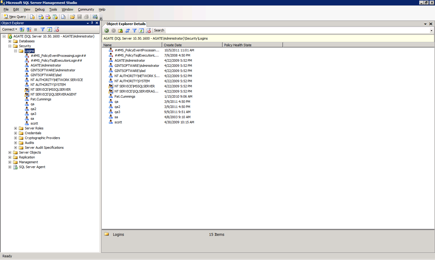

  2. Navigate to Security Logins:
  3. Create or Select a User.
  4. Right-click on a user and select New Login…
  5. Right-click on a user and select Properties.

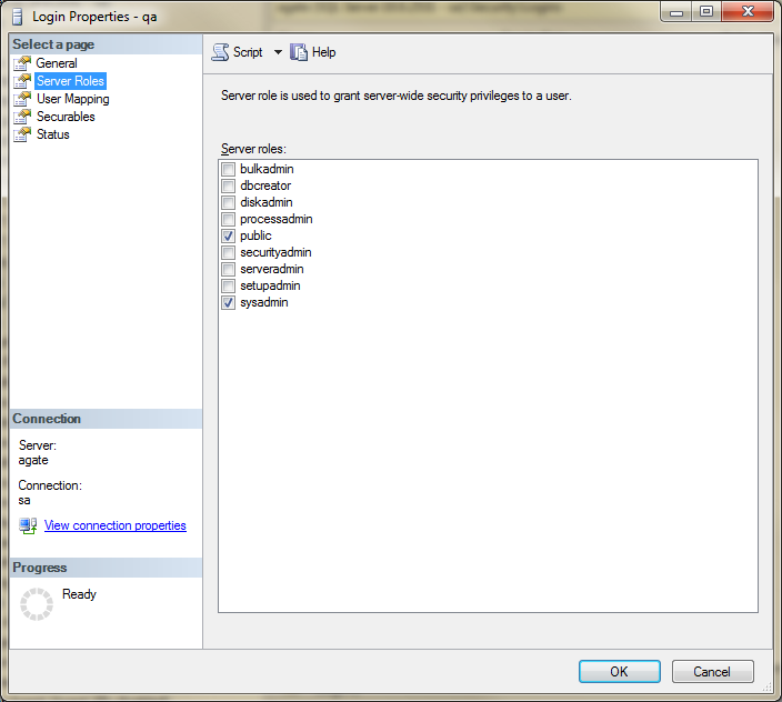

Administrative User:
  1. Select Server Roles.  Check public and sysadmin.
  2. User Mapping: not necessary to select anything given the sysadmin authority.

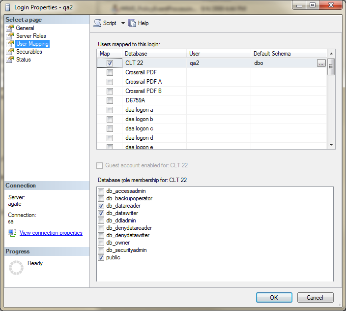

Read-Write User:
  1. Select Server Roles.  Check public.
  2. Select User Mapping. Check the databases that the user can access.  Check the roles db_datareader, db_datawriter and public:
 Read-Only User (qa3):
  2. Select User Mapping. Check the databases that the user can access.  Check the roles db_datareader and public.
