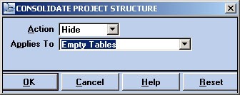

There are several ways to hide tables and fields. To have gINT automatically hide tables or tables AND fields with no data you can invoke the command ‘Consolidate Project Structure’. From the INPUT tab go to Tools > Consolidate Project Structure. The table and fields will remain in the database but will be hidden from view.

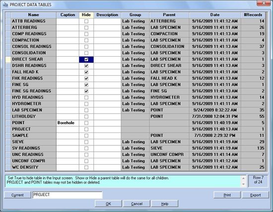

You can also hide tables and fields with data. To hide fields from the INPUT tab go to TABLES > Show or Hide Fields and check or uncheck the box under Hide. To hide tables from the INPUT tab go to Tables > List and check or uncheck the box under Hide.
