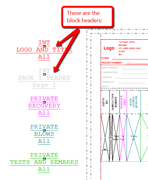

Entities are in an internal or a drawing library block

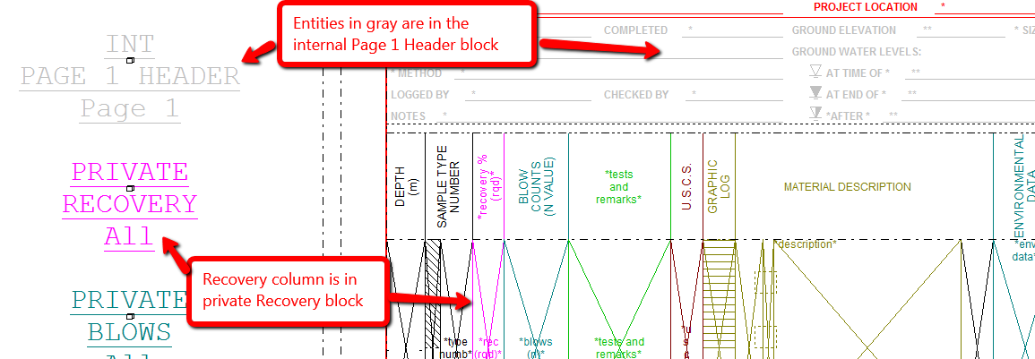

The entities may be in an internal or a drawing library block.  Usually entities in a block are a color other than black.  To edit entities in an internal or a drawing library block you must navigate to that block.  Entities in private blocks are editable right on the Report Design page.
Recovery, Blow Counts, Tests and Remarks and the other columns are in private blocks.  Double-clicking these columns will open them for editing.
To edit the entities in an internal or drawing library block hold down the Alt key and click once on the block header.
This will open an internal block or the drawing library block for editing.

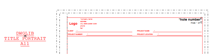

Sometimes there are blocks nested within other blocks.  In the internal block, Logo and Title, only the hole number and page number entities can be edited.  The other entities are in the drawing library Title Portrait block:

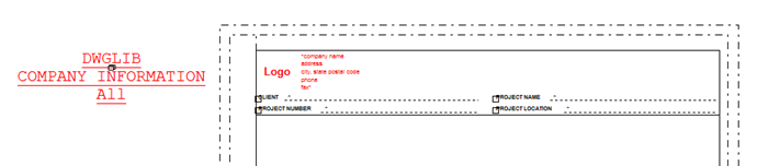

Alt+click on the drawing library Title Portrait block header to open it for editing.  The logo and the company name and address entity are in the Company Information block:
Alt+click on the Company Information block to open it for editing:
