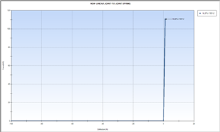

In order to model the Gap elements in Collapse, the Gap elements must be replaced with non-linear joint-to-joint springs (NLSPJJ).
A Gap element is simply an axial non-linear joint-to-joint spring where one portion of the stiffness curve has a slope of zero and the other portion of the stiffness curve is the axial stiffness expressed as:
where
A is the cross-sectional area
E is the modulus of elasticity
and L is the length of the element
Below is an example of a non-linear joint-to-joint spring for a tension element:
Non-Linear Joint-to-Joint Spring
Note that the slope of the force deflection curve is zero when the deflection is below zero. The deflection is calculated as the difference between the initial joint distance for the element and the joint distance for the element after the displacements have been determined, so a negative deflection would represent compression.
