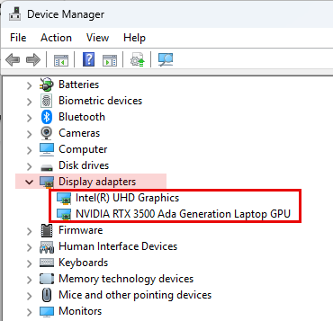

Verify that your graphics card is supported.
The list of recommended graphics cards is available here. Note that there have been some issues with the Intel on-board graphics cards, so a dedicated graphics card is highly recommended.
You can verify the graphics card on your computer by opening the Device Manager and expanding Display adapters.

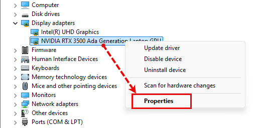

Update the graphics card driver

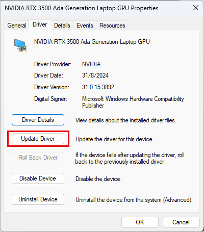

Right-click the graphics card in the Device Manager and select properties to open the graphics card properties.
Click Update Driver on the Driver tab in the graphics card properties dialog.

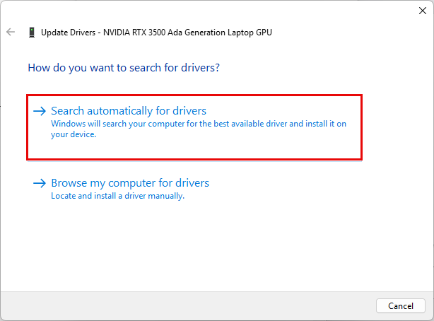

Select Search Automatically for updated driver software to automatically install the latest graphics card driver.
