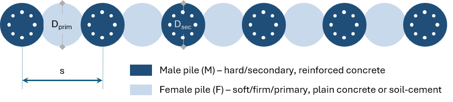

Secant pile walls are commonly used retaining systems in which reinforced concrete secondary piles interlock with primary piles of lower stiffness, typically plain concrete or soil-cement, to form a continuous and water-tight retaining structure. CIRIA C760 Appendix A3.5 describes hard/soft, hard/firm, and hard/hard secant wall variants.
Typical secant pile wall with alternating primary and secondary piles
Figure 1. Typical secant pile wall geometry showing alternating primary and secondary piles and key geometric parameters.
In parts of the secant wall literature, secondary and primary piles are also referred to as male and female piles, respectively. This article uses secondary pile and primary pile terminology throughout because it is clearer and avoids ambiguity when discussing hard/soft, hard/firm, and hard/hard walls.

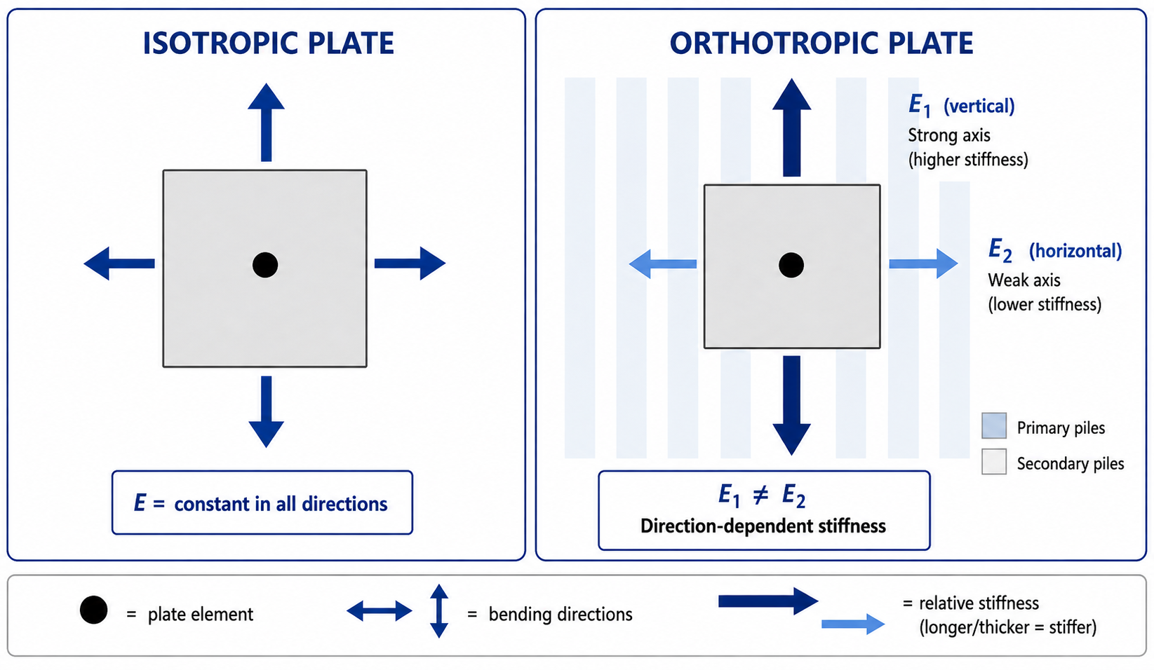

In PLAXIS 3D, secant pile walls are often represented using plate elements. A conventional approach is to assign an isotropic plate stiffness based on the flexural rigidity of the reinforced secondary piles, consistent with the type of expression given in CIRIA C760 Table 4.2 for soil-structure interaction analysis. This can be appropriate for hard/hard walls and for preliminary assessments, but it can overestimate bending stiffness in the horizontal direction for hard/soft and hard/firm walls where a strong stiffness contrast exists between the pile types.
Conceptual comparison of isotropic and orthotropic plate behaviour
Figure 2. Conceptual difference between isotropic and orthotropic plate behaviour in PLAXIS 3D.

A PLAXIS 3D plate resists bending in two local directions. If a single isotropic Young's modulus is used, the same stiffness governs both directions. For a secant wall this may be too restrictive because the wall's vertical and horizontal bending mechanisms are not equivalent:
For hard/soft and hard/firm walls, calibrating one isotropic plate material to the secondary-pile vertical bending stiffness may therefore overestimate the wall stiffness in the horizontal direction. An orthotropic plate provides a practical way to assign different stiffnesses in the two principal plate directions while still using a continuous structural element.
Important modelling note: There is no unique equivalent orthotropic plate for a secant pile wall. The wall is a discrete periodic structure, not a true continuum. Any equivalent plate representation requires engineering assumptions about how the discrete pile geometry is smeared into continuous stiffness parameters.
