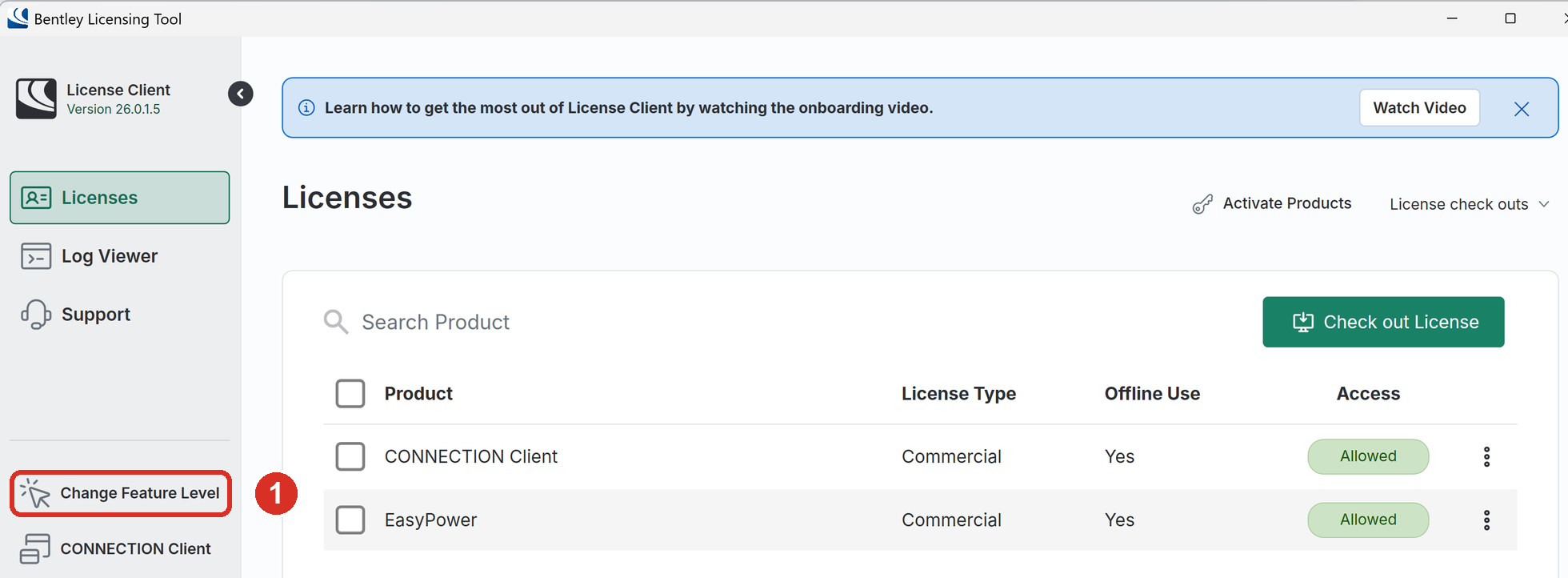

  2. In the left pane of the Bentley Licensing Tool, click Change Feature Level. The Feature Level Selector opens.
Bentley Licensing Tool with Change Feature Level highlighted in the left pane.
Figure 1: Click Change Feature Level (1) in the left pane of the Bentley Licensing Tool.

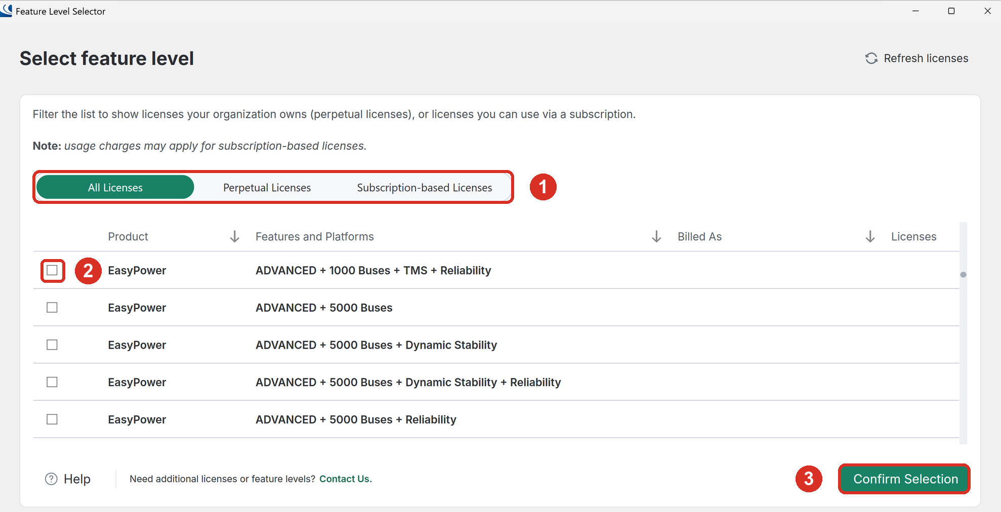

  1. Click a tab to filter the list to show licenses your organization owns (perpetual licenses), or licenses you can use via a subscription. Click All Licenses to show both.
    Note: Usage charges may apply for subscription-based licenses, such as SELECT Open Access.
  2. Select the check box for your EasyPower license entitlement.
  3. Click Confirm Selection.
Feature Level Selector with the license tabs, a feature level check box, and the Confirm Selection button highlighted.
Figure 2: In the Feature Level Selector, choose a tab (1), select your license entitlement (2), and click Confirm Selection (3).
