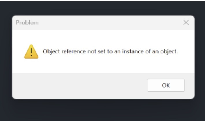

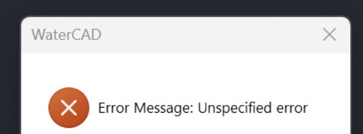

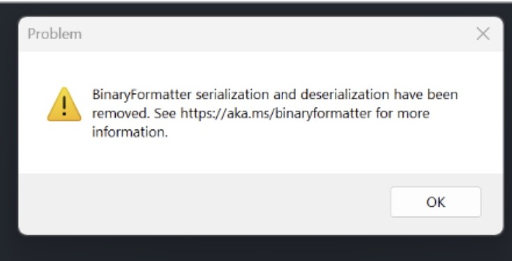

After upgrading AutoCAD 2026 to the 2026.1.2 version (August 5th, 2026 update, 25.1.179.0 or higher) or upgrading Civil 3D 2026 to the 2026.2.2 version (August 5th, 2026, 13.8.1809.0 or higher), integration with OpenFlows products stopped working and the following error messages appear when trying to open the "...for AutoCAD" shortcut:
"BinaryFormatter serialization and deserialization have been removed..."
"Object reference not set to an instance of an object."
 "Error Message: Unspecified error."
This issue is caused by a breaking change made by Autodesk in this minor update, related to to .NET architecture. (for all types of AutoCAD, including Civil 3D).
This update upgraded the architecture from .NET 8 to .NET 10, which breaks integration with OpenFlows products because the OpenFlows components rely on the original .NET 8 used when AutoCAD 2026 was originally released. This is not a change that Bentley could have foreseen or tested for compliance because the update was not available at the time our most recent versions were released (26.00.00.532). Bentley always fully tests our products with the most current releases of AutoCAD, and this update was not available at the time, so we could not have made our integration compatible. Furthermore, historically all minor updates and patches to a major release (year number) did not break our integration, so there has been no need for Bentley to closely monitor for AutoCAD updates and patches (until another new OpenFlows version is released).
