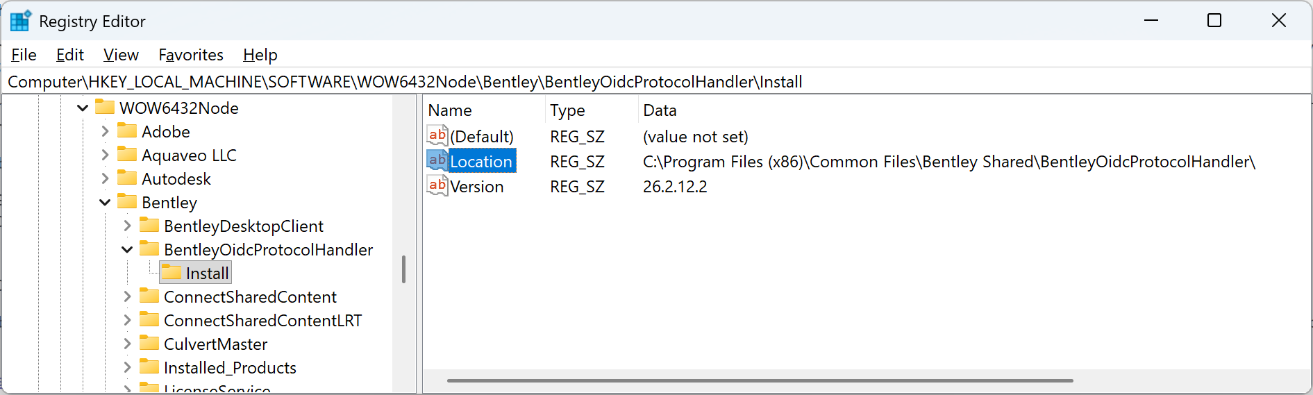

6) Check and repair missing Registry entry: If the above does not help, check for the following registry key:
HKEY_LOCAL_MACHINE\SOFTWARE\WOW6432Node\Bentley\BentleyOidcProtocolHandler\Install\
If the "Install" folder (key) exists, open it and check if the "Location" is pointing here:
C:\Program Files (x86)\Common Files\Bentley Shared\BentleyOidcProtocolHandler\
If it is not, edit "Location" and set it to the above path.
If the entire "BentleyOidcProtocolHandler" folder does not exist, please create it and the "Install" subfolder, add the "Location" item and set it to the path above. As a shortcut, you can download and run the following file, which will merge this into your Registry: OIDC Registry entry for OpenFlows Copilot and background maps issue
