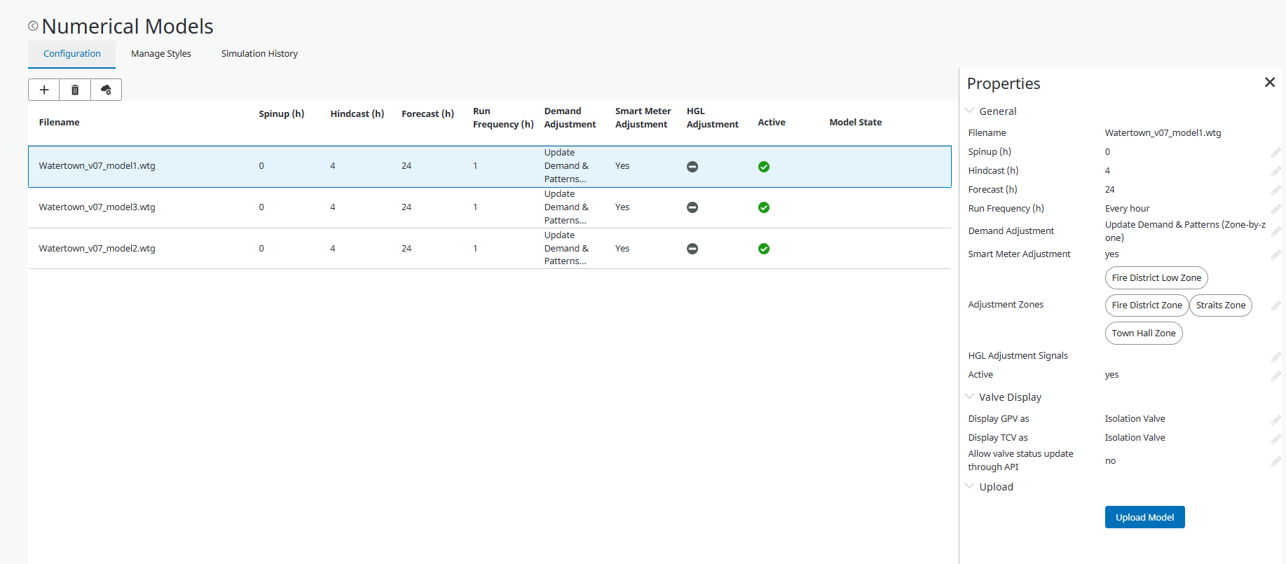

In the administration >> Numerical Models, the user can add several models by clicking in the add (+) button at the top. Once clicking "Add", a new row in the table will appear and the user can upload and edit the configurations of a specific model. For that, make sure to click on the row and edit the right side panel that will appear. To add a second model (or a third model) just click on the "Add" button again and a new row will be displayed related to the second model, for the user to configure.
Figure 1 - Example of three models uploaded into WaterSight

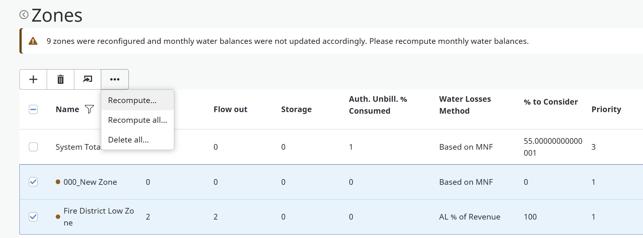

When zones are created or updated, and if any of the parameters that affects the monthly water balance calculation are changed, then those zones will be marked with a orange dot and a message will be displayed for the user to recompute the monthly water balances. To recompute the monthly water balances click on the (...) button and press recompute all or select the zones for which you want to trigger the monthly water balance calculation.

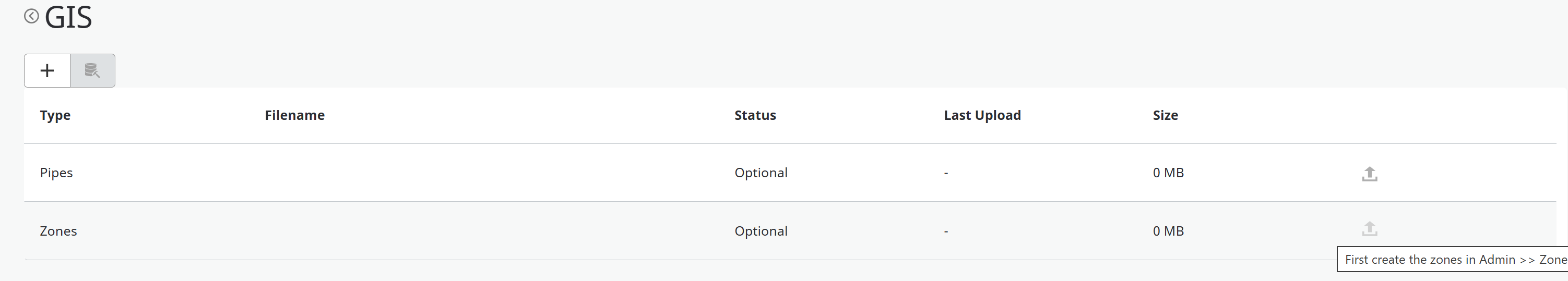

As mentioned above the zone shapefile is not required anymore and the option to upload the shapefile is only available after zones are created under Admin >> Zones. The shapefile upload will only serve to create the zones geometry (to have those displayed in the map) and to associate customer meters to zones (used for the revenue water calculations, and just in case the user did not associate any zone to customer meters - only coordinates).
Note that the zones creation occurs by uploading the configuration template or by manually adding zones in Admin >> Zones. If no zones are created, the zones shapefile button will appear greyed out and no shapefile can be added.

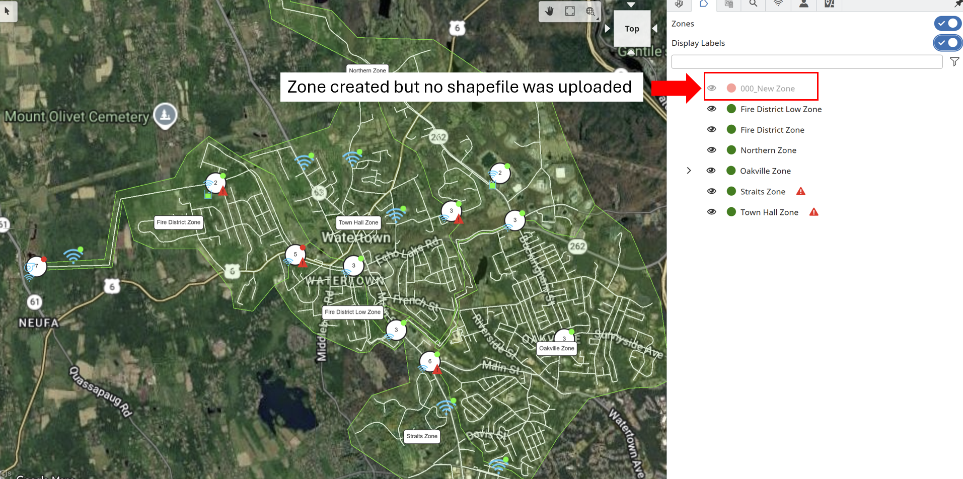

To upload the zones shapefile the user should go to administration >> GIS. More information here about the requirements - Uploading GIS data. Make sure that a column Name exists in the zone shapefile with the same name as the zone created/listed in WaterSight. If a zone is created but if it does not exist in the uploaded zone shapefile with the same name, it will not be displayed in the map but will be listed as greyed out in the side panel - Figure 2.
Figure 2 - Zones display in the Map page
Recompute Zones Monthly Water Balances only for selected zones
Instead of requiring to recompute all the zones balances if one of the zones changed (which could take a long time for systems with many zones), it is now possible to select the specific zones to recompute the monthly water balances for. This is done by selecting the zones from the table and then by pressing the (...) button above the table and then clicking on recompute.

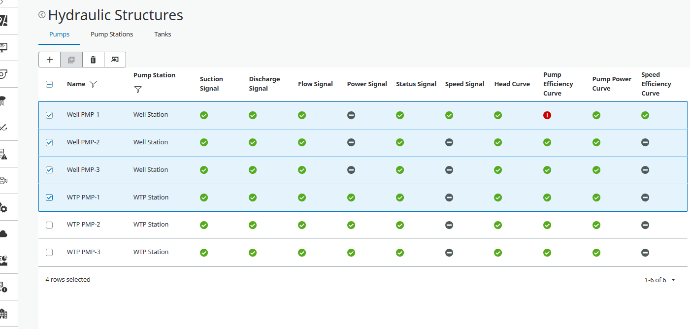

Multi-Select in the Administration for Pumps and Tanks
Multi-select option is now available for pumps and tanks, under  Admin >> Hydraulic Structures.

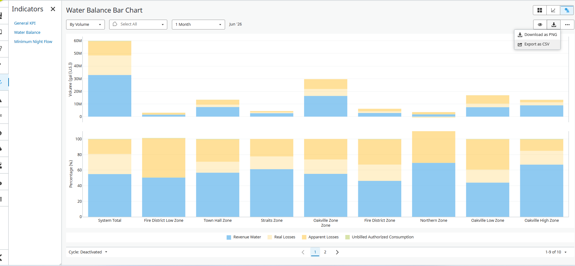

Water Balance export for all zones
It is now possible to export to CSV all the water balance components for all zones. To do this go to Indicators >> Water Balance. On the top right select the Water Balance Bar chart. From that page click on the "Export as Csv" option and all the water balance components will be exported for all zones.
