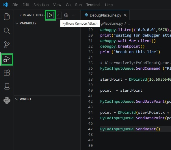

5.  Attach the VS Code Debugger
Switch back to Visual Studio Code and:
i.     Select Run and Debug from the Activity Bar.
ii.    Choose Python: Remote Attach from the available debug configurations.
iii.   Click on the Play button to Start the debugger.
VS Code will attach to the Python process running inside MicroStation.
