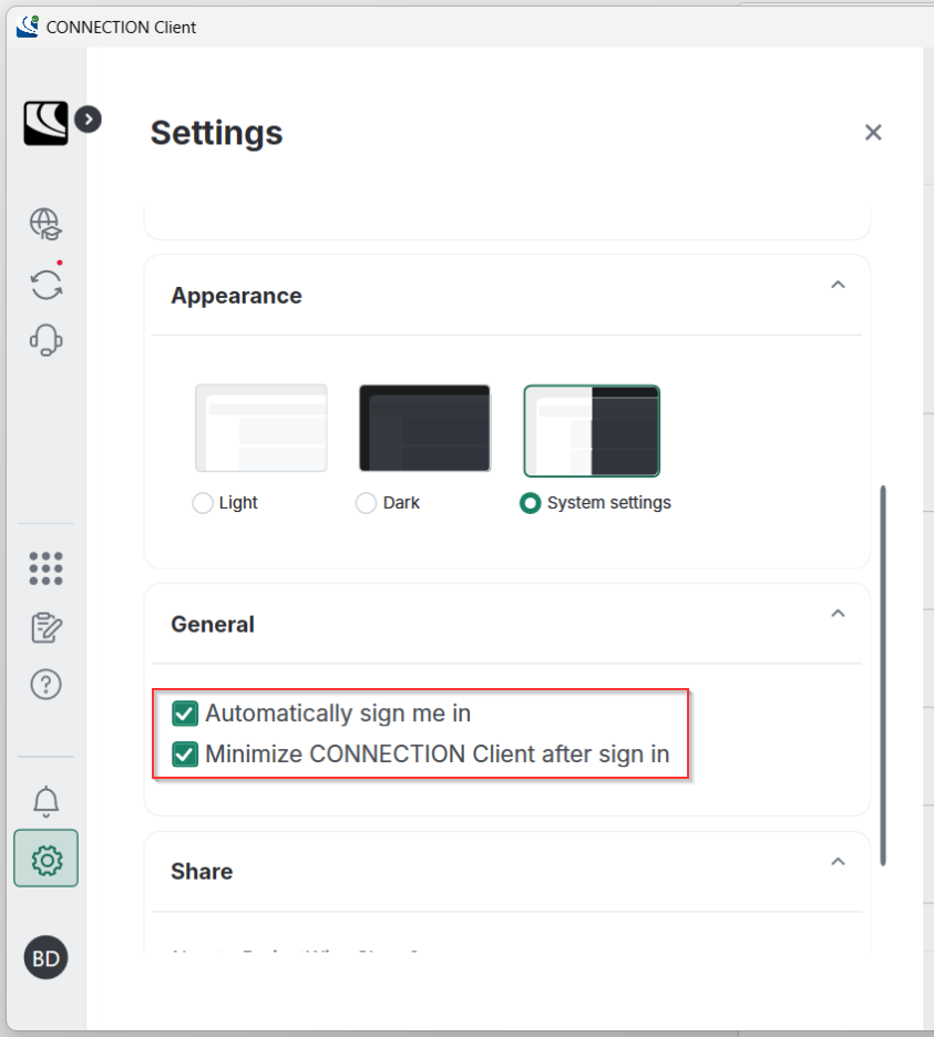

Please ensure that these settings are configured correctly in the CONNECTION Client settings.
To automatically set CONNECTION Client to log in and minimize:
Go to CONNECTION Client settings and check off the following two boxes -
