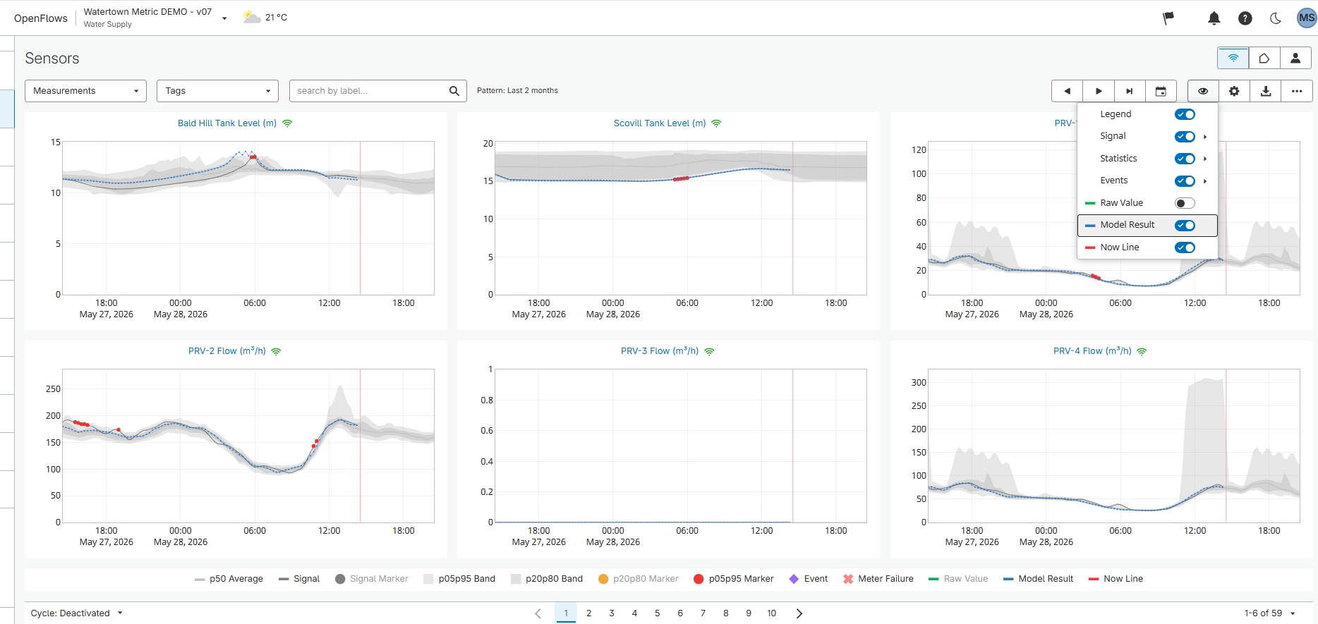

To  export model results for the model elements which are mapped to real sensors, go to the Network Monitoring >> Graphs view, and make sure to turn on Model results toggle inside the eye icon:
Model results will then be displayed with a blue line in the graphs. To export the model results just click in the download button located on the top right:

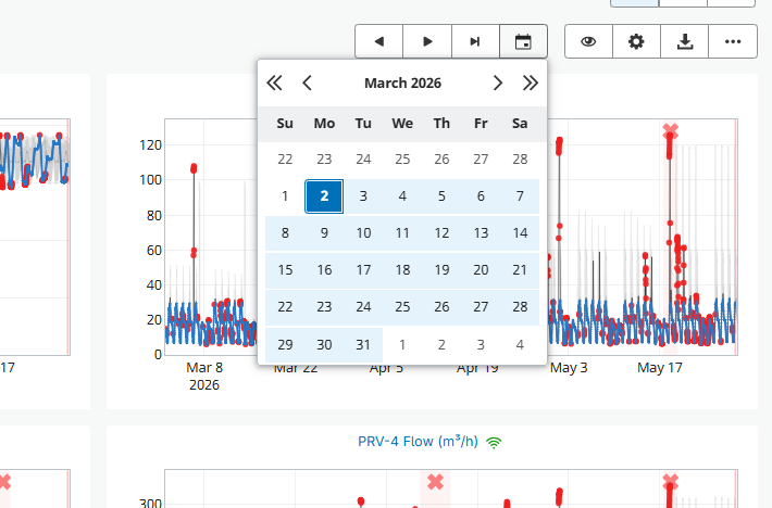

Two excel files will be generated per each sensor (or zone or large customer), one with the model results and another one with the signal and confidence bands (pattern) results. By default results will be exported only for the most recent days, but user can change the period by selecting another period on the calendar icon, and then clicking export to CSV again, as shown below.

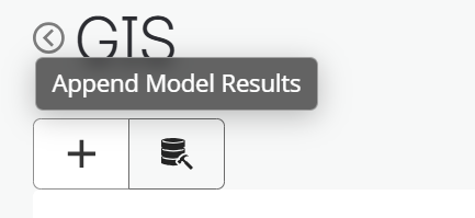

3- After successful upload of the shapefile, make click on the "Append Model Results" button located on top of the table.

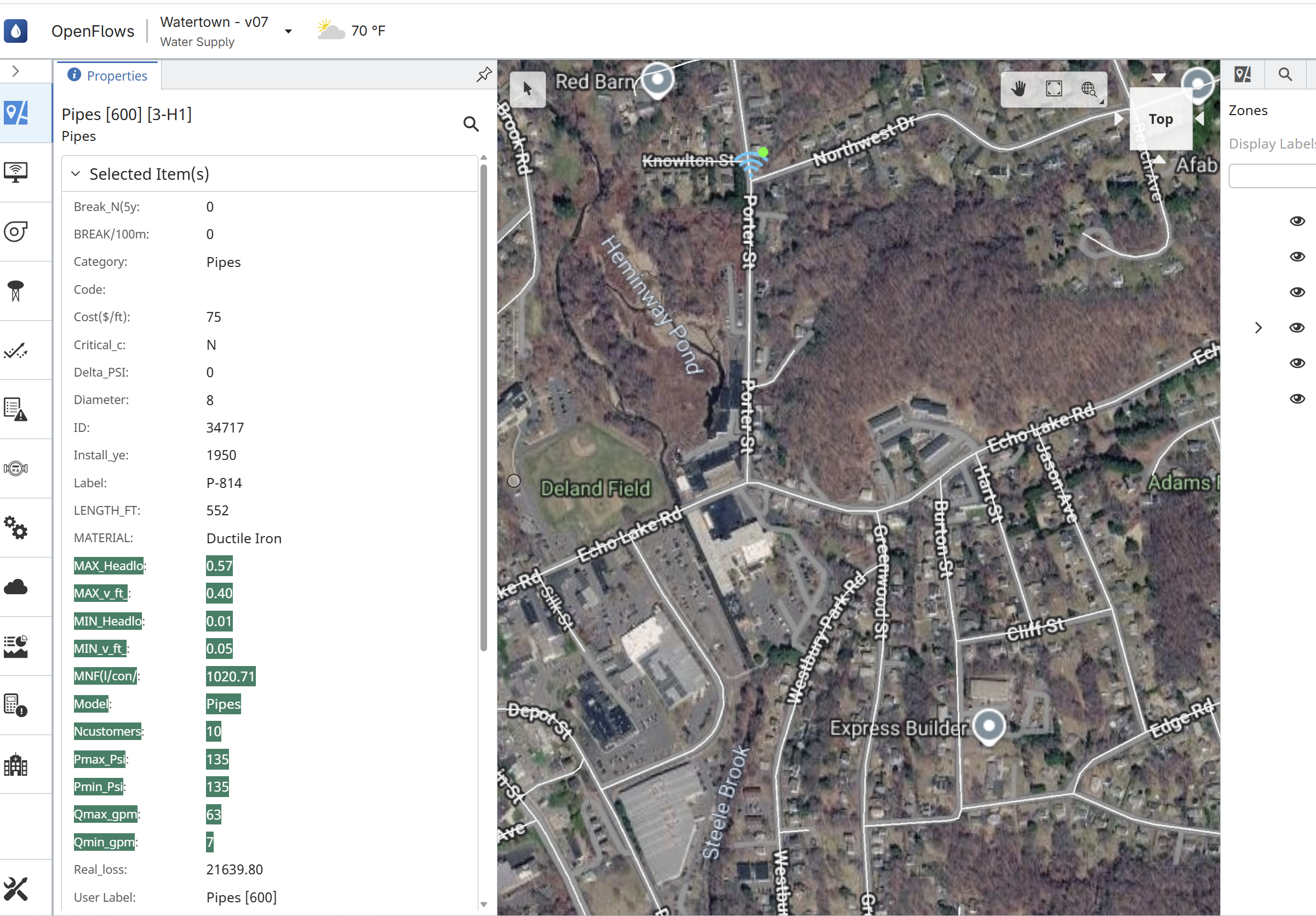

5 - After the process finishes, export the pipes shapefile, by clicking in the export button located in the pipes row. When opening the pipes shapefile you will see that additional fields were created for each pipe (max flow, min flow, max pressure, min pressure, change in pressure, max velocity, min velocity, max head loss and min head loss)
6 - You can also check those fields by directly accessing the Maps page and clicking in any pipe. The new model properties, directly calculated from the model, are displayed in the information side panel.

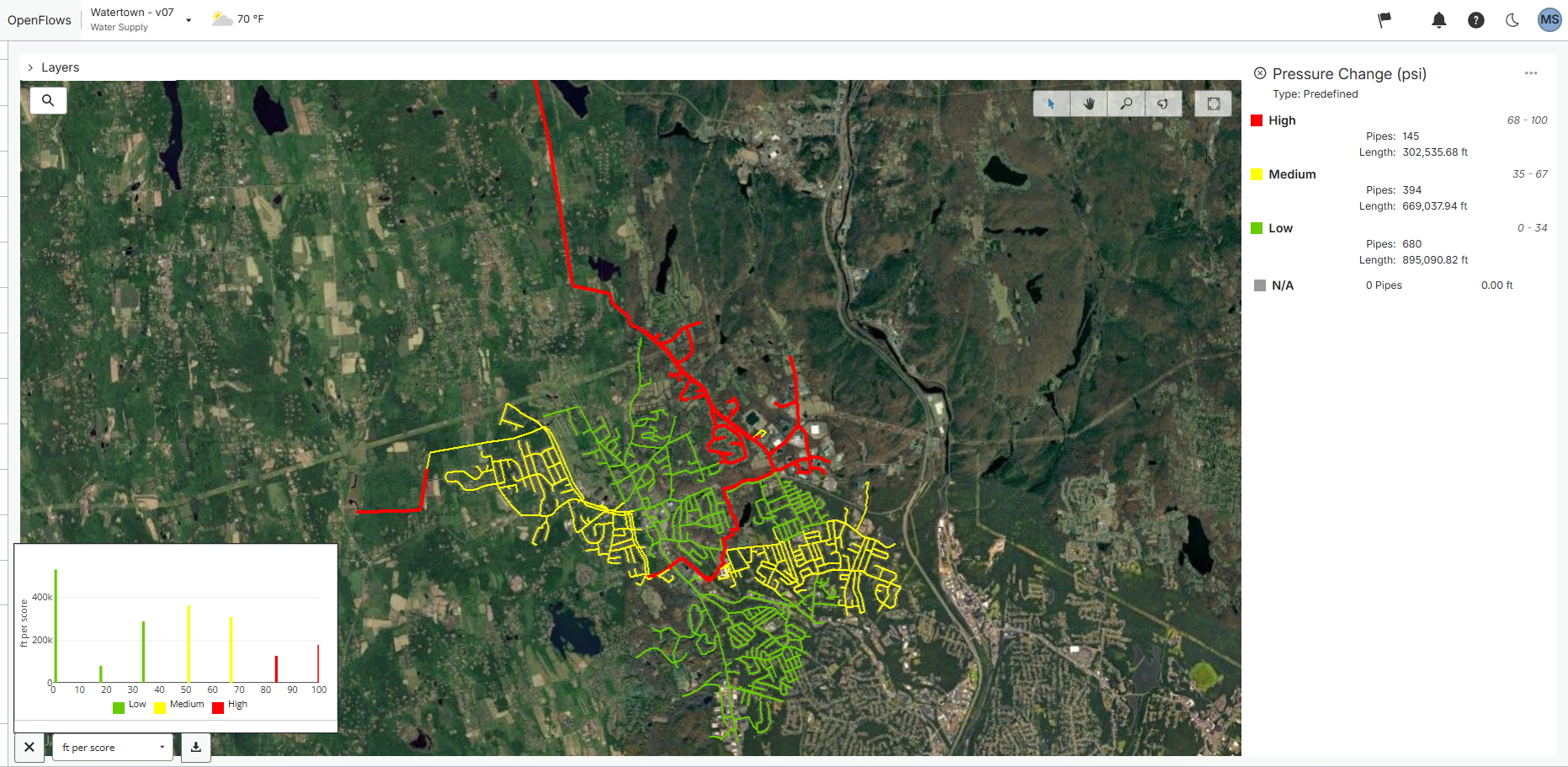

If a successful model run exists in WaterSight, a GIS pipe shapefile is uploaded, and the "Append Model Results" button is pressed (see above section), then it is possible to create your own modeled thematic maps with the maximum pressure or minimum pressures or flows by accessing the Capital Planning Module and then by creating Aspects. More information is available here.
