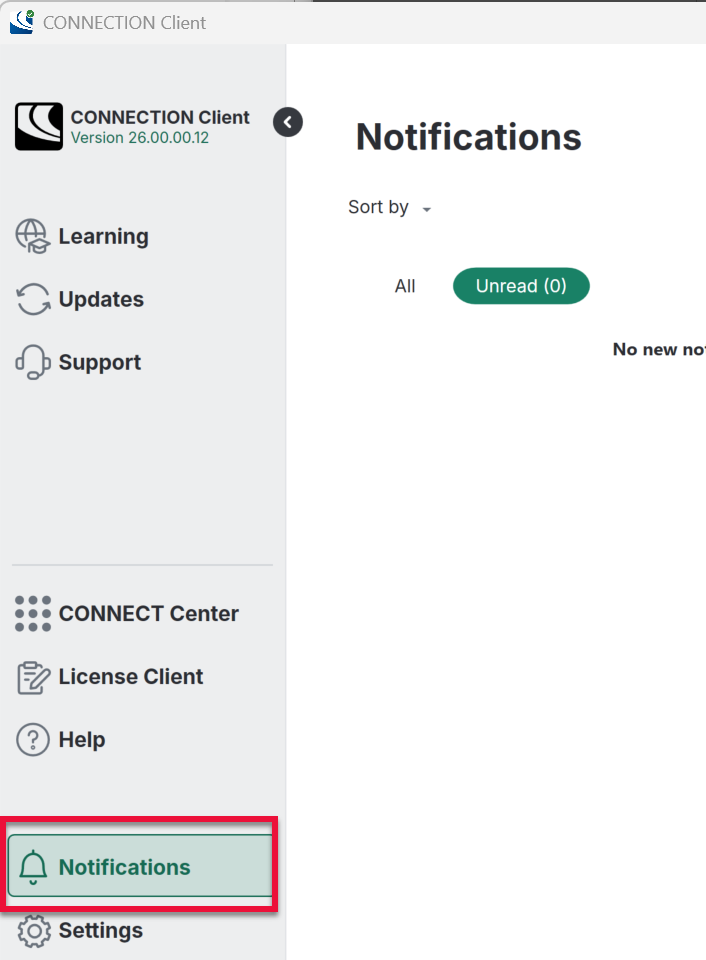

- Open CONNECTION Client and sign in using your Bentley credentials.

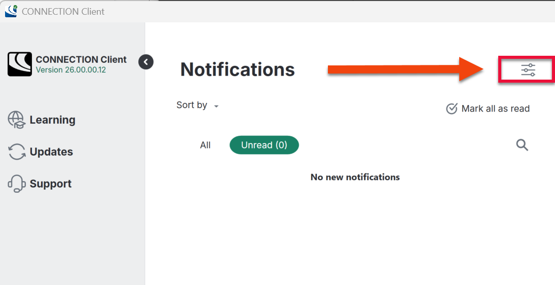

- From the left-hand side of the application, click the Notifications (bell) icon.
- Click the Settings icon within the Notifications panel (as shown below):

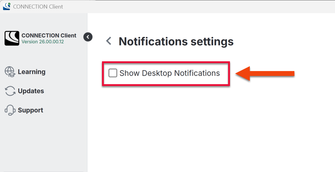

- Toggle Off the option "Show Desktop Notifications":
- Close Settings
- Notification settings are saved automatically.
- Close the Settings window to return to the main CONNECTION Client interface.
