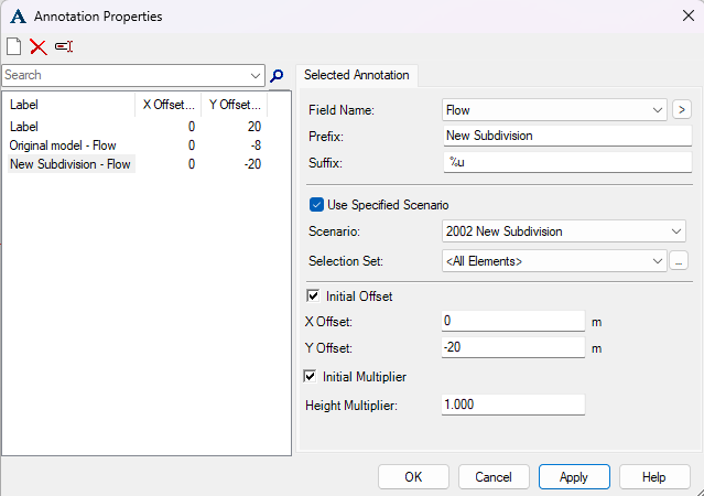

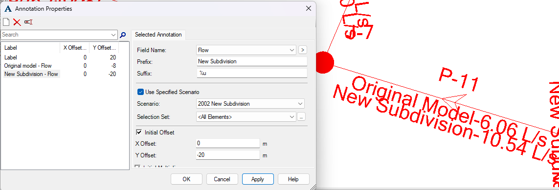

Set annotations for specific scenarios in Element Symbology
You can now set a specific scenario when using annotations in Element Symbology. This enables you to easily compare results between two scenarios in a single drawing. When you create or edit an annotation in Element Symbology, there is an option to select a scenario.
If you create another annotation for the same property field, you can select another scenario to display the results. In the screenshot below, you can see the flow results at a pipe for two different scenarios. Prefixes were used to help differentiate between the results.

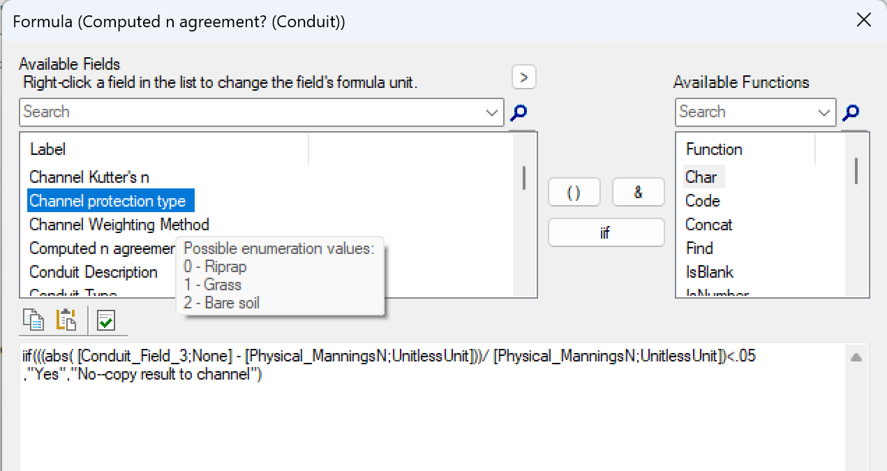

New "Text (Formula)" User Data Extension type
It is now possible to create a formula User Data Extension where the output is a text field. For instance, you could use the IIF (if-then) function to give a pass or fail value. It is also possible to edit existing text values using different text-based functions.
In the User Data Extension manager, create a new UDX and set the Data Type to Text (Formula). Click the Formula cell and click the ellipsis (…) button.
The properties for the element you selected will be displayed on the left. The available functions will display on the right. You will be able to build your formula using these.
Note: when using enumerated fields (dropdown list) in the list on the left side as part of your formula, you can hover your mouse over them for a tooltip preview of the numeric ID values corresponding to each choice, which you would use in the formula. This provides a quick reference so that you do not need to exit your formula editor to go check the available enumerated values.
See more here: Creating Formula-Based User Data Extensions

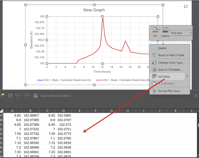

Export to Word feature added to Graph and FlexTables
A new Export to Word feature has been included for Graphs and FlexTables. When you open a graph or FlexTable, you will find an Export to Word feature. This will export the graph or FlexTable to a new Word document.
This functionality streamlines the process of creating reports and sharing model results, as you can now seamlessly integrate tabular data and graphical plots into your project documentation.
Furthermore, you can customize the appearance of the exported content using Chart and Table Templates. For graphs, the underlying data remains accessible in the Word document and can be edited via Excel, offering greater flexibility for reporting and presentation.
For graphs, you can also edit the data source by right-clicking on the graph in Word and choosing Edit Data, which will open the numerical data in Excel. For example, you could adjust the column header to display differently in the Word document compared to the graph in the OpenFlows product.
See this link for more information: How to Export FlexTables and Graphs to Microsoft Word

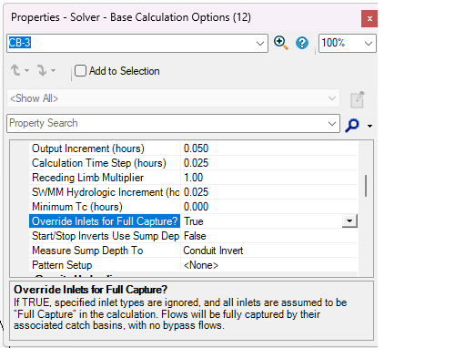

Ability to override inlet capture to be full capture
A calculation option has been included to allows you to override the catalog inlet capture efficiency to be full capture. This applies to the GVF-Rational and GVF-Convex solvers in OpenFlows Storm and OpenFlows Sewer. This option is helpful in situations where you need to quickly see results if all flow is captured, without having to set up a new alternative with all inlet types set to full capture.
To use this, open the calculation options in the Properties. Find the field “Override Inlets for Full Capture?” and set this to True. When this is done, all inlets will be considered full capture and there will be no bypass flow to connected gutters.

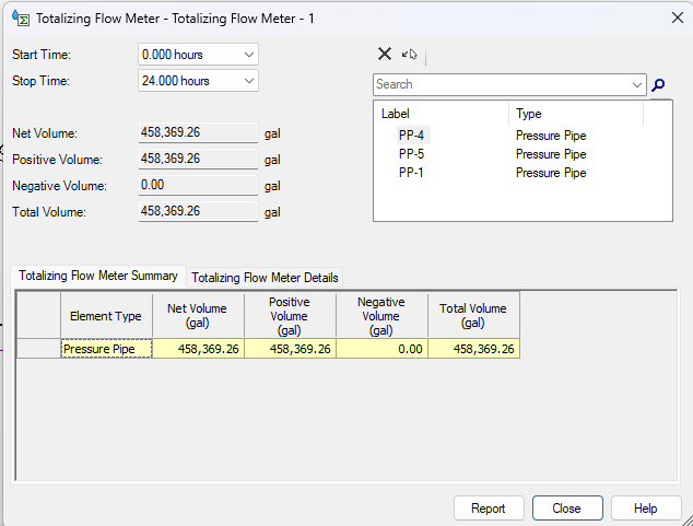

Totalizing Flow Meter
The Totalizing Flow Meter tool is now available to find the volume of flow for conduits when using the Explicit, Implicit, of GVF-Convex solvers. This tool can be access by going to the Analysis tab in the Ribbon interface and choosing More > Totalizing Flow Meter. Click the New button create a new item. You can then select elements you want to include. If an element is already highlighted in the drawing, it will automatically be included.
This can also be used for pressure pipes in the Explicit and Implicit solvers.
See this link for more information: Reporting volume of water through certain elements in SewerCAD, SewerGEMS, and CivilStorm

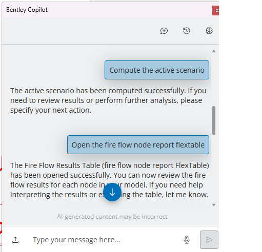

Bentley Copilot
Bentley Copilot is a new conversational artificial intelligence (AI) assistant that provides contextual intelligence, guides users through workflows, searches relevant documents, makes changes to model inputs, and analyzes data inputs and outputs through natural language conversation. By enabling users to "talk" to their hydraulic models and removing the need to memorize tool locations or complex query syntax, Bentley Copilot empowers users and accelerates project delivery, reducing the learning curve and enabling users to focus on engineering decisions.
To access Bentley Copilot, click on the Bentley Copilot item in the Home tab of the Ribbon interface. This will open a dialog where you can start the chat with Copilot.
Note: If you do not wish to install Bentley Copilot, it can be disabled during or after installation. See details in the article below.
Prompts can include asking for general information about the model (“how many pipes are there with a diameter greater than 12 in?), model functionality (“compute the active scenario”), how-to type questions (“how can I model a connection to an existing water main?), and more.
With this release, Bentley Copilot is offered as a Technology Preview, which means that it is still under development and may not represent the full functionality intended for a future (non-tech preview) release. Therefore, please use this feature for evaluation purposes. Please be aware that at some point, you may receive notice from Bentley that such use must cease or this Technology Preview will become unavailable to you. As we receive feedback, this Technology Preview may also be enhanced, updated or also discontinued without notice. As a Technology Preview, it is provided to you "as-is" without the benefit of any Bentley warranty, indemnity or support obligation.
More details can be found here: [Tech Preview] Using Bentley Copilot in OpenFlows Products

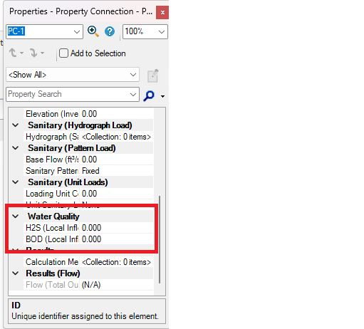

Hydrogen sulfide (H2S) calculation for Property Connection elements
Input for H2S calculation are now available for Property Connection elements. This includes input for H2S and BOD.

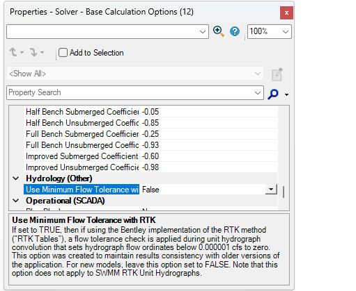

Bentley RTK compatibility mode
A Bentley RTK Compatibility Mode has been added to the calculation options. Using this option will apply a flow tolerance check that will adjust flow values less than 0.000001 cfs to be zero. This option has been included so that you can match results from earlier versions.
To use this option, change the calculation option property “Use Minimum Flow Tolerance with RTK” to True. For new models, it is recommended that this property be set to False.

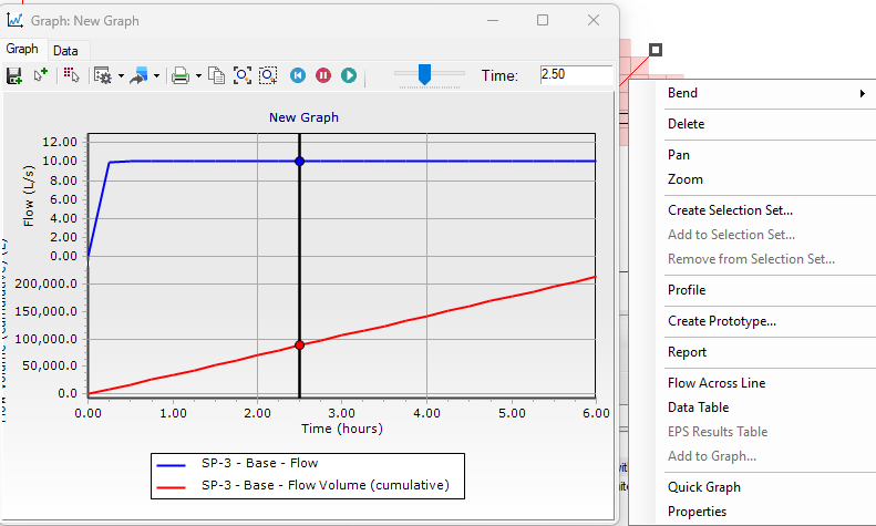

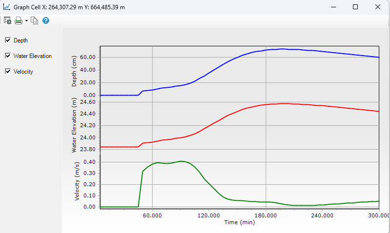

Create graph for any 2D cell
It is now possible to create graphs for any 2D grid cell. From the Grid Browser, click the Graph Cell button.
This will open a new dialog where you can view the depth, water elevation, and velocity at the grid cell.
If you click on another point in the grid, the data will update to the new location. Note that it is not possible to save a given graph. However, you can use Chart Options to view the data and save to an outside program, like Excel. You can also print the graph from dialog.
More information on 2D modeling can be found here: 2D Modeling in SewerGEMS and CivilStorm
