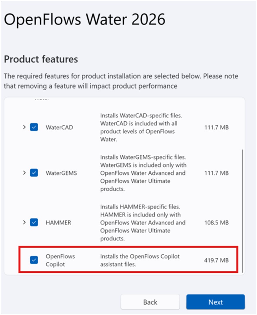

For users or organizations who prefer not to install the Bentley Copilot tool (for example due to company policy regarding AI tools or if you do not agree to the terms mentioned above, or for users in China), you can choose to exclude it during the setup process. To do so, proceed with the OpenFlows installation until you arrive at the Product Features configuration window. In this step, deselect the checkbox for the "Bentley Copilot" feature to ensure it is not installed. Please refer to the screenshot below for a visual guide.
If you are an administrator and need to deploy the OpenFlows product to multiple users with Copilot disabled, you can create a deployment image with Copilot disabled. See: Silent installation and Deployment Image for OpenFlows Products
Note: if you already installed the OpenFlows product with Copilot enabled and wish to disable it, you can navigate to the Windows "Installed Apps" (Programs and Features), click the "..." button next to the OpenFlows Water / Storm / Sewer entry, choose "Modify" and you will see the option to disable it (see screenshot below).

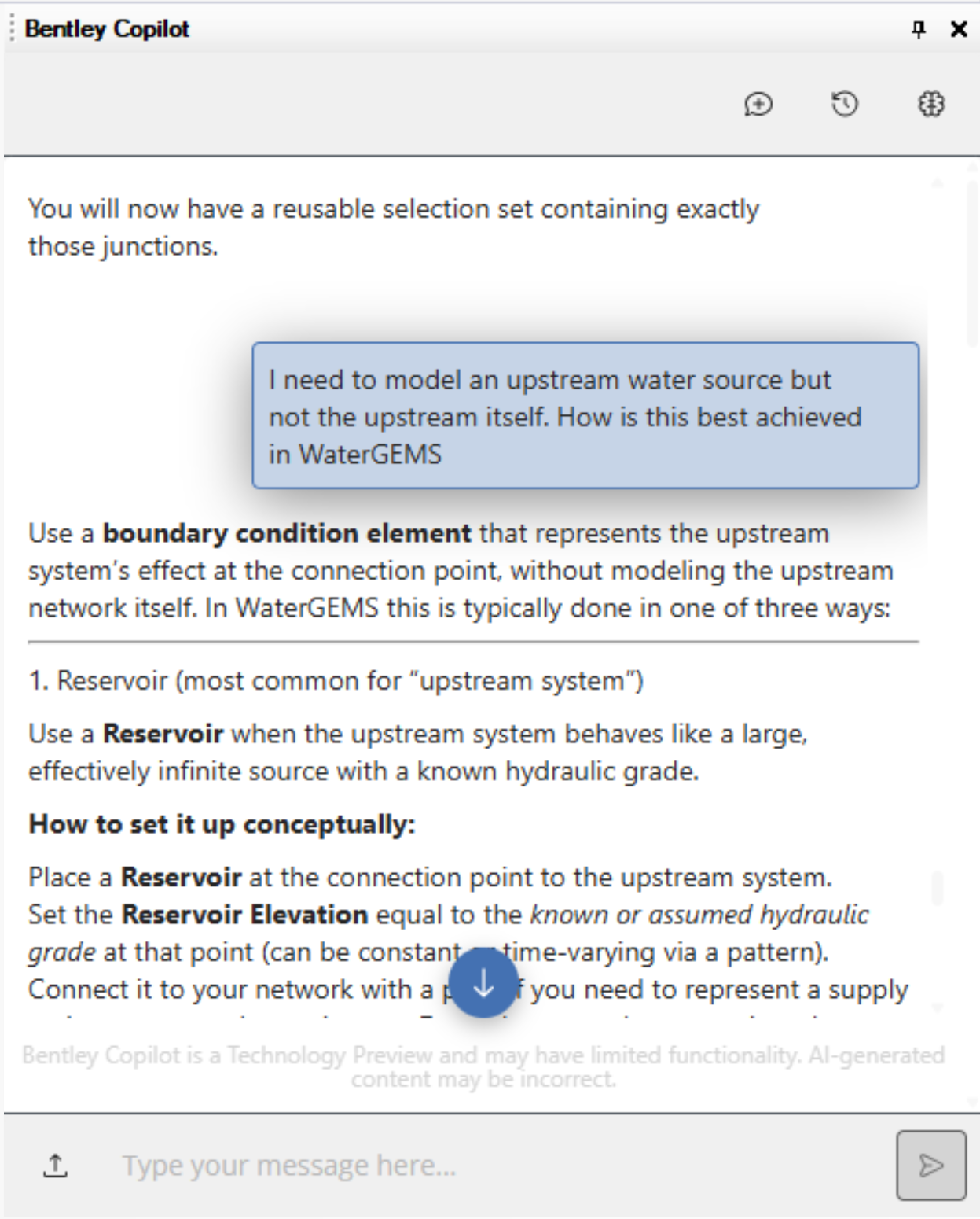

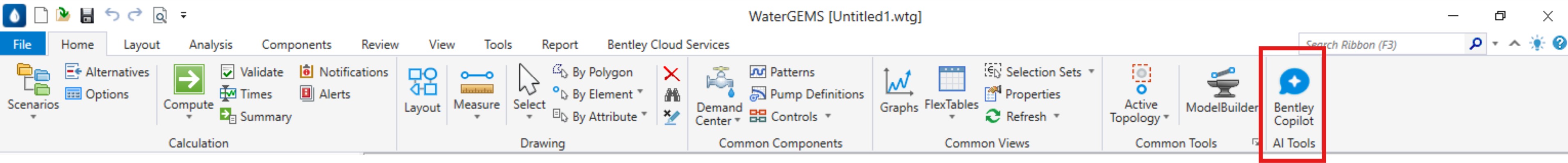

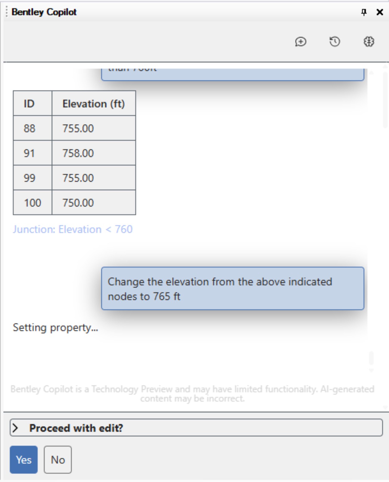

Bentley Copilot is presented as a dockable window within the OpenFlows interface. It can be found in the Home tab under Bentley Copilot.
Note: Bentley Copilot for OpenFlows products is currently only available for the standalone version (release 26.00.00.514). The integrated versions (ArcGIS Pro, Civil 3D, AutoCAD, and MicroStation) do not support Bentley Copilot for OpenFlows. Please note that when using the integrated version with MicroStation, the available Bentley Copilot feature is only related to MicroStation functionalities and will not work for OpenFlows-related interactions.

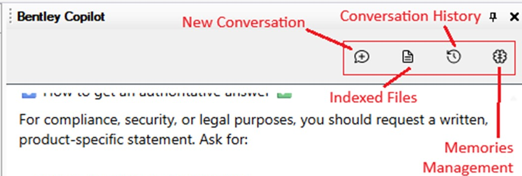

At the top right of the tool, you will find four icons from left to right: New Conversation, Indexed Files, Conversation history, and Memories management:
