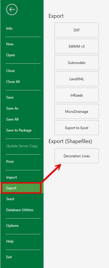

To export the element element connectivity lines (dashed lines), follow the steps below:
  1. From the main ribbon, navigate to the File tab.
  2. In the File menu, click on Export.
  3. Under the Export (Shapefiles) section that appears, select the element connectivity lines (dashed lines) option.
(The image below illustrates the menu path to access this feature.)
  1. A file browser dialog will open. Choose a location on your computer, enter a name for your shapefile, and click Save.
The resulting shapefile will contain the line geometry for all element connectivity lines (dashed lines) present in your model and can now be used in any GIS software for further visualization and analysis.
