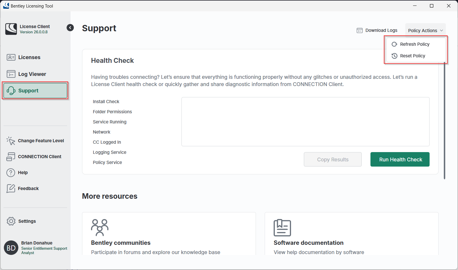

Refresh Policy and Reset Policy are available from the Bentley License Tool, under "Support".
This is for expired policies or when a new policy is needed manually (auto refreshed occurs every 4 hours).

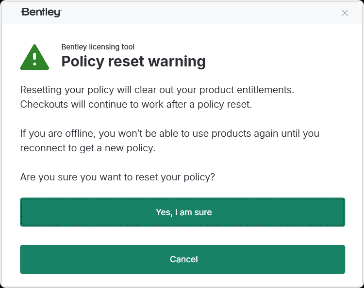

Resetting the policy will empty your entitlements tab and will force a new policy next time an application is used. This option is useful for license troubleshooting or for clearing old licenses.
Click the "Yes I am sure" button to proceed.
