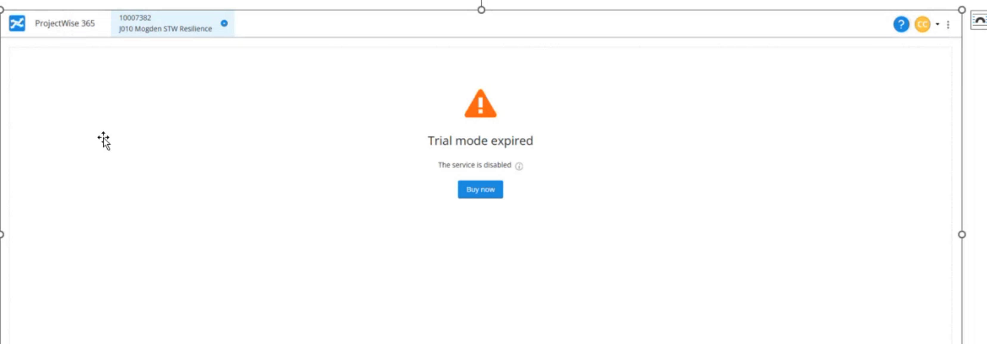

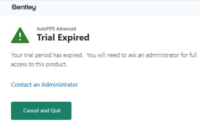

When signing in to a Bentley product or opening a project, users may see one of the following messages:
- “Trial expired”
- “Trial mode expired”
This message prevents access to the product or project.
Cause
Bentley product trials are time‑limited. Once the trial period ends, access is disabled unless a valid commercial license is in place.
This message can appear when:
- The trial period for the product or service has ended.
- The project is no longer operating in trial mode.
- A commercial license is required, but none is assigned.
- Licensing changes were recently made, but the system has not yet refreshed the user’s licensing policy.
Access can be restored by ensuring a valid license is applied and refreshing the licensing policy.
