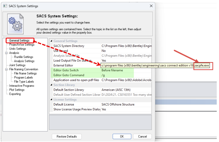

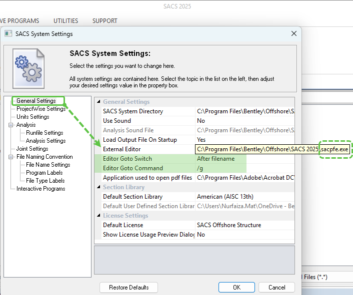

1. Open SACS System Settings.
2. Go to General Settings and locate the External Editor field.
3. Browse to the SACS installation folder and select sacpfe.exe (the Programmer’s File Editor). If sacpfe.exe is not present in your SACS 2025 installation folder, you may copy it from your SACS 16.1 installation folder and paste it into the SACS 2025 installation folder, then point the External Editor field to that executable.
Copy from SACS 16.1:
Paste the sacpfe.exe in SACS 2025 folder:
4. Set Editor Goto Switch to: Before filename
5. Set Editor Goto Command to: /g
6. Click OK to save the settings.
7. Close and restart SACS.

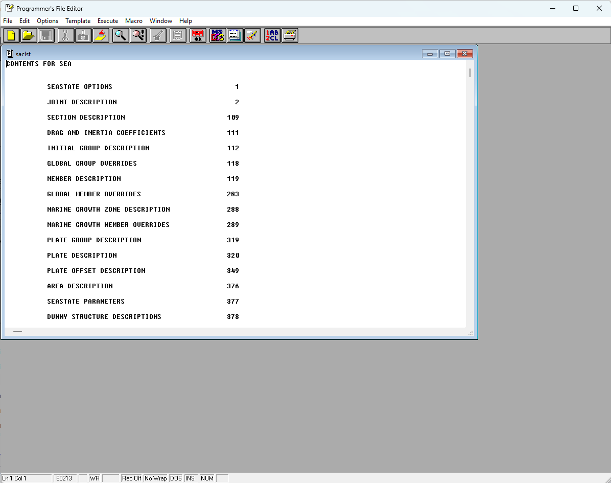

After restarting, output listing files will open in the SACS Programmer’s File Editor instead of the system text editor.
