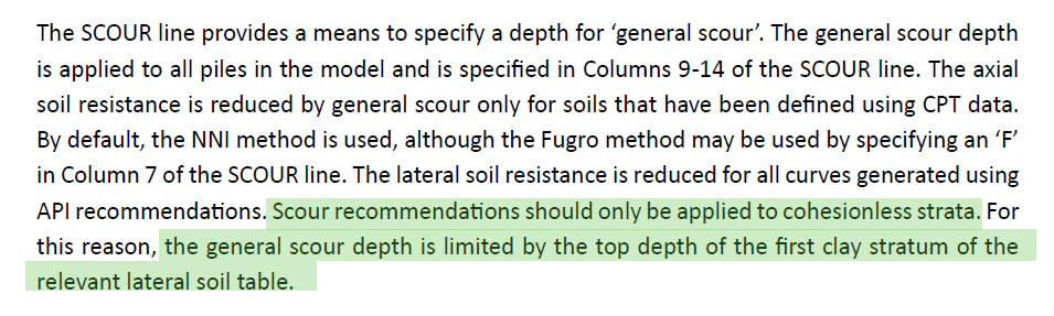

The behavior is governed by how API General Scour is applied in SACS PSI. According to the SACS PSI Manual, Section 2.4.3.6 – Applying API General Scour Recommendations:
Because the upper layers are clay, the scour depth does not meaningfully reduce the pile–soil stiffness. As a result, the foundation stiffness matrix generated for the superelement remains effectively unchanged, and therefore, the global eigenvalues and natural frequencies also remain unchanged.

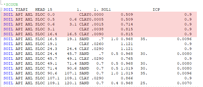

NO SCOUR, cohesive soils:

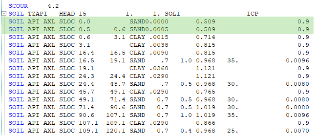

SCOUR 4.2m, cohesionless strata:

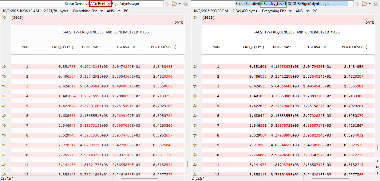

The results:
When the top layers are changed to sand (cohesionless strata), the SCOUR definition starts to reduce the API-generated soil stiffness. This leads to a small change in the equivalent foundation stiffness and, consequently, small changes in the extracted eigenvalues. The fact that the change is small is technically expected, since the affected soil thickness is relatively shallow (about 0.6m) compared to the full pile embedment, and the global modes remain largely structure-dominated.

1. Review the PSI soil profile: If the top layers are clay, SCOUR will have no effective influence on the superelement stiffness.
