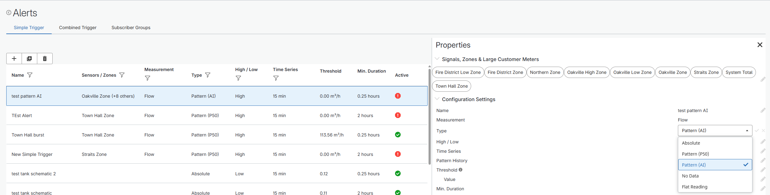

Alerting based on patterns generated by AI
In the administration >> Alerts it is now possible to define simple and combined trigger rules using as reference a pattern that is generated by AI. It is valid only when defining triggers for zones.
This new option will appear under the "Type" settings of the trigger with the name "Pattern AI", see example below. The Pattern (P50) refers to the traditional pattern, calculated using statistical analysis.
This new AI trigger type follows the exact same logic as the typical pattern (P50) trigger. Pattern based alarms are evaluated using the pattern as a reference and alerts are only generated if i) time series values are above or below percentile 95th or 5th of the pattern (depending if high or low type is defined) for the minimum duration defined and ii) at least one of outliers has a difference relative to the percentile 50th (absolute or relative/percentage value) higher than the threshold defined. More complete information about alert triggers can be seen here - Alert Administration.
More information about patterns and how AI is used can be seen here - Patterns and demand forecast calculation.

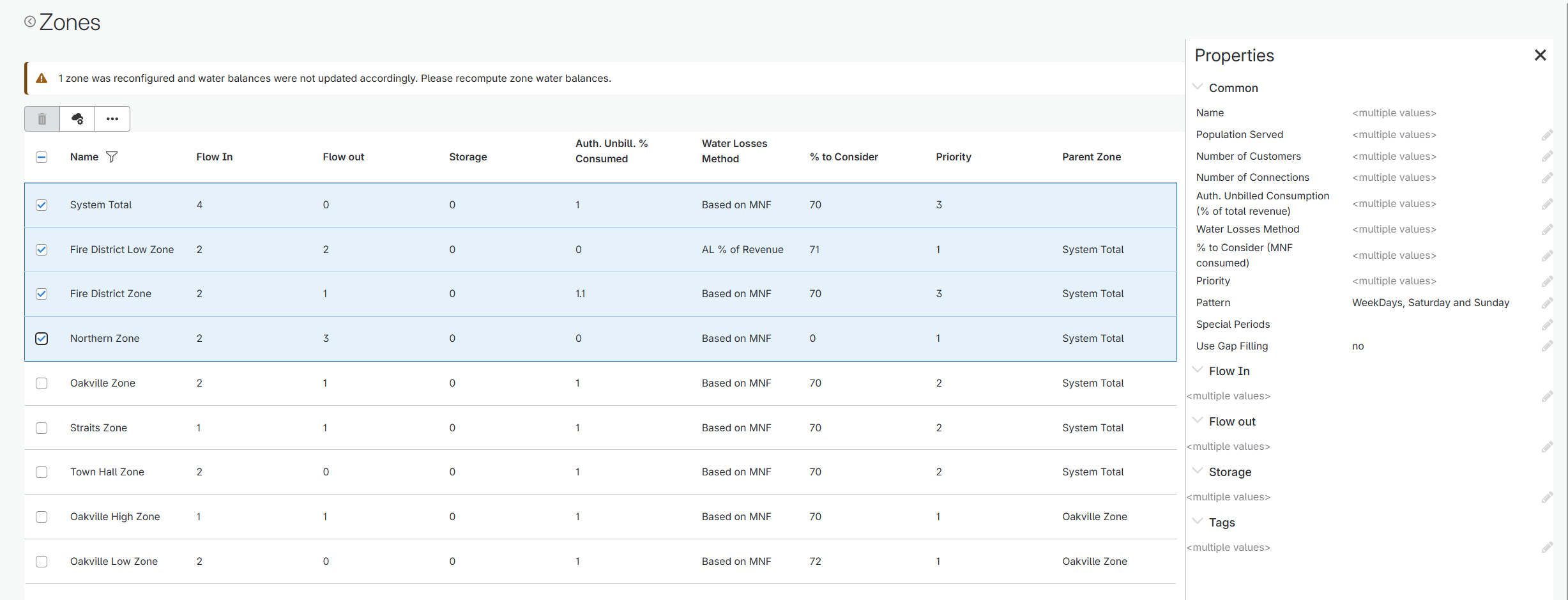

Multi-edit for Zones
Multi-edit for zones is now available (inside Admin >> Zones). The user can now select multiple zones and make several changes, all at once.

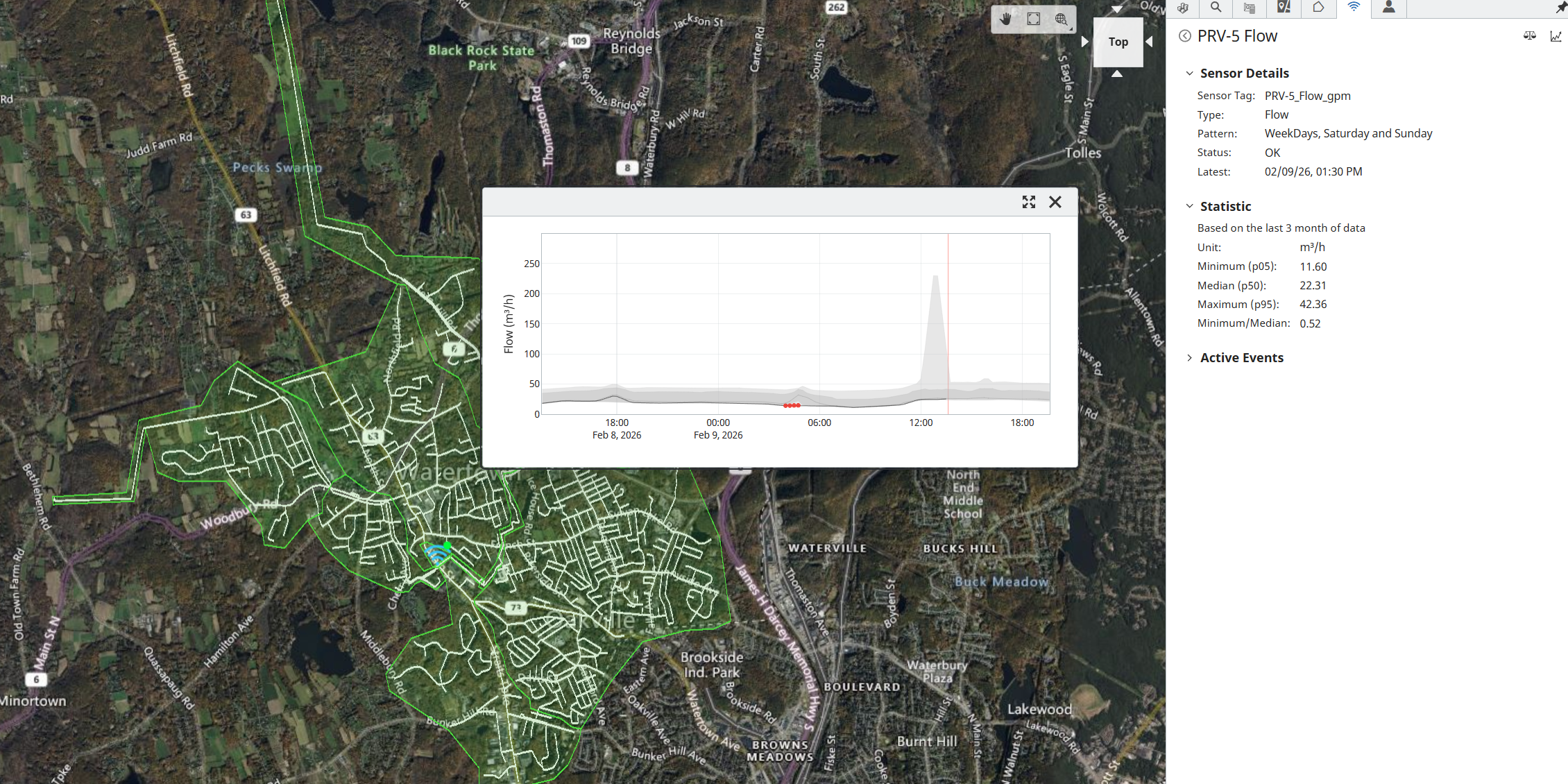

Map Improvements
Movable time-series graphs
The time-series graphs that are displayed when clicking on an element in the map (sensor, zone, large customer, model element) can now be dragged by the user.
Zoom-in and Zoom out improvements
Zoom-in and zoom-out functions were improved. Now only when user selects an element using the side panel, the auto-zoom in function will act. If selecting from the map, there is no change of the zoom extents.
