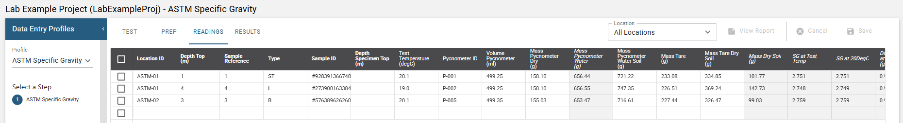

ASTM Specific Gravity by Water Pycnometer
ASTM D854-23
ASTMSGWP ASTM Specific Gravity

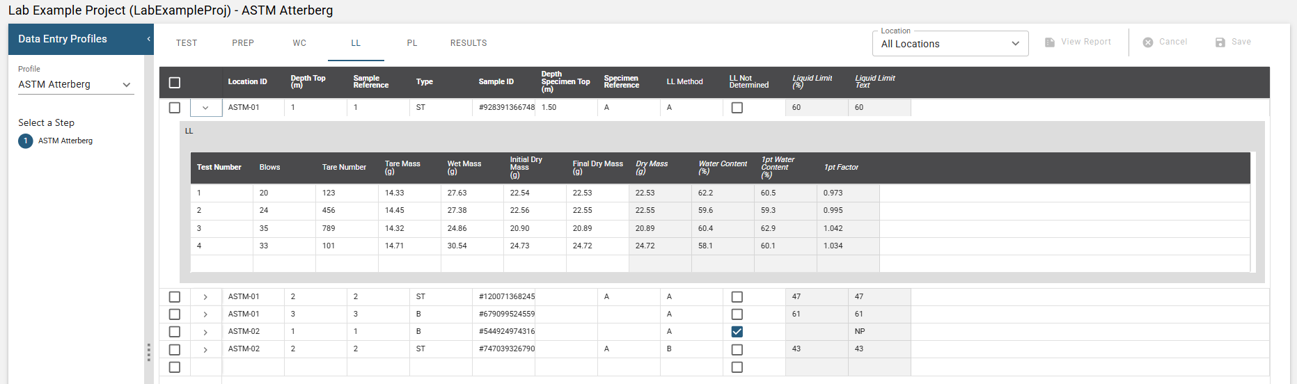

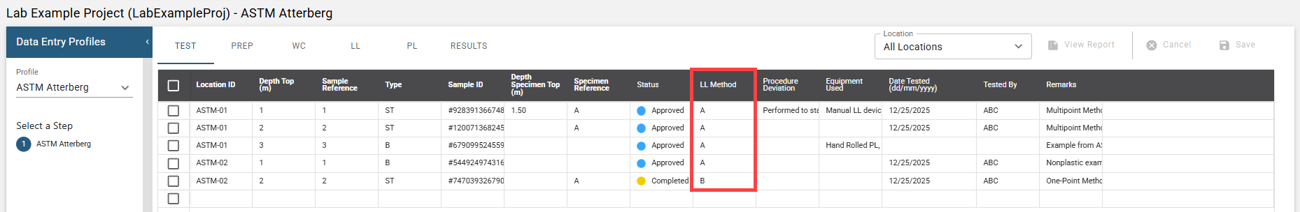

ASTM Atterberg

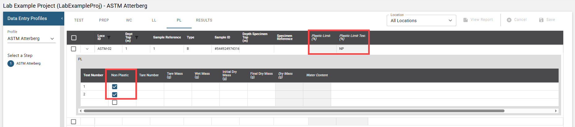

This test determines the Liquid Limit, Plastic Limit, and Plasticity Index of soils. The liquid limit is found using a standard mechanical cup device (Casagrande cup), while the plastic limit is determined by rolling a thread of soil to a specific diameter until it crumbles.
Both Method B - One Point and Method A - Multipoint from the ASTM D4318 standard are supported.
Liquid Limit readings are entered in the child ASTMAtterbergLL group. Plastic Limit readings are entered in the child ASTMAtterbergPL group. The final Liquid Limits and Plasticity Limits are calculated within the parent ASTMAtterberg group.
Both numeric and text values are calculated for the Liquid Limit, Plastic Limit and Plasticity Index. This allows reporting a test result as 'NP' (non-plastic).
If a Liquid Limit can not be determined, the 'LL Not Determined' box in the parent ASTMAtterberg group can be checked, which will report the Liquid Limit as 'NP' (non-plastic) in the Liquid Limit Text header and a numeric Liquid Limit will not be calculated.
If a Plastic Limit reading is marked as 'Non Plastic', then 'NP' will be reported in the Plastic Limit Text header and a numeric Plastic Limit will not be calculated.

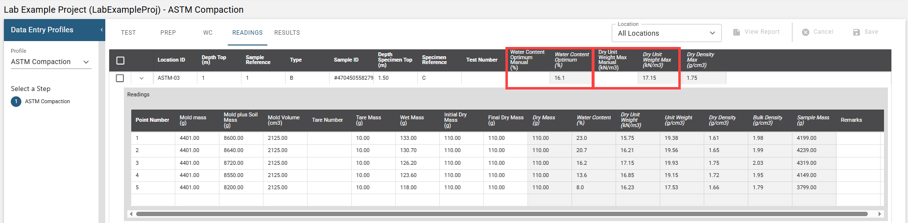

ASTM Compaction
These tests determine the relationship between the water content and the dry unit weight of soil. The method involves compacting a soil sample at varying water contents in a specific-sized mold in layers, with each layer receiving blows from a standard-weight rammer dropped from a set height.
Two separate sets of data model groups and data entry profiles are available in the Lab Configuration Pack. ASTM Compaction calculates final results in SI units. ASTM Compaction US calculates final results in inch-pound units.
Both ASTM ASTM D1557 (Modified Compaction) and ASTM D698 (Standard Compaction) are covered by the same groups/data entry profiles. The Test Type header can be used to record which procedure is being followed.
Readings for each compaction test point are entered in the child ASTMCompactionReadings (or ASTMCompactionReadingsUS) group.
The Water Content Optimum and Dry Unit Weight Max are automatically calculated from the child data using curve-fitting functions. There are also headers available to manually enter these values and override the automatically calculated values.

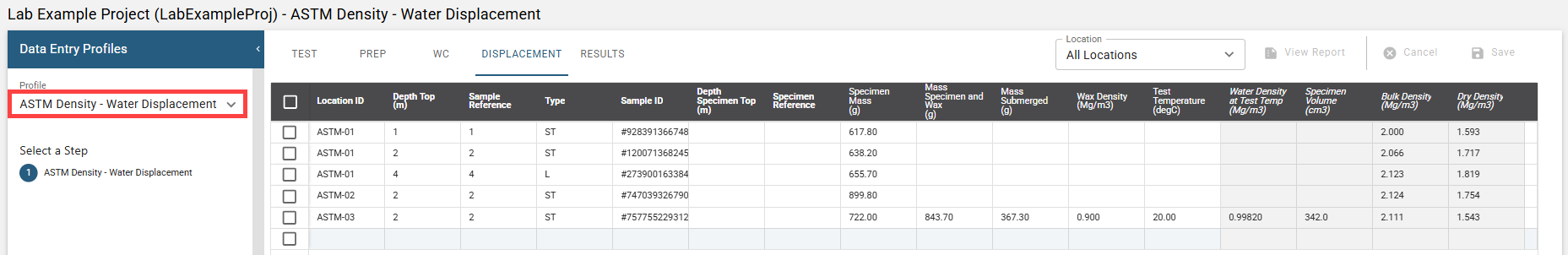

ASTM Density

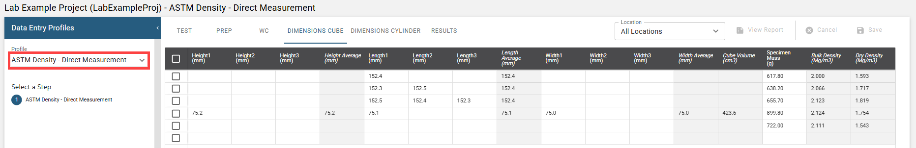

This standard outlines methods for determining the density and unit weight of soil specimens. The volume of the specimen is determined either by direct geometric measurement or by the water displacement method.
Two separate sets of data model groups and data entry profiles are available in the Lab Configuration Pack. ASTM Density calculates final results in SI units. ASTM Density US calculates final results in inch-pound units.
There are two separate data entry profiles for each of the test methods described in the ASTM D7263 standard: ASTM Density (US) - Direct Measurement and ASTM Density (US) - Water Displacement.

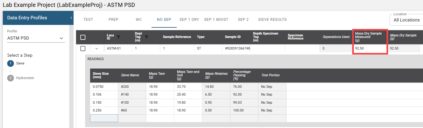

No separation sieve
This scenario is the simplest. The entire sample (specimen) is dried and only the Mass Dry Sample Measured needs to be entered, along with the masses retained on each sieve:

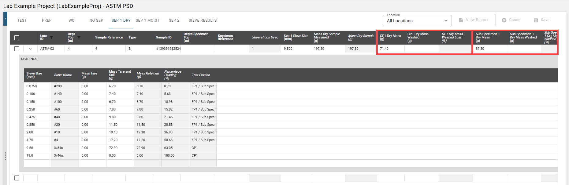

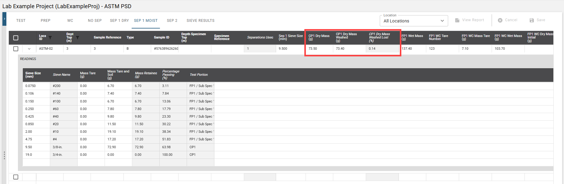

One separation – Dry
In this scenario, the sample (specimen) is in a dry state so the Mass Dry Sample can be measured and entered directly.
The sample is passed over Separation Sieve 1, which produces Coarser Portion 1 (CP1) and Finer Portion 1 (FP1).
CP1 is dried, optionally washed, and then sieved. The CP1 Dry Mass is entered directly.
FP1 would typically be split to produce a smaller Sub Specimen 1 that will not overload the sieves. Sub Specimen 1 is then dried, washed, and sieved. The Sub Specimen 1 Dry Mass can be entered directly.

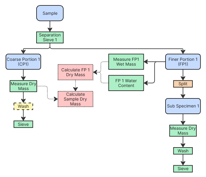

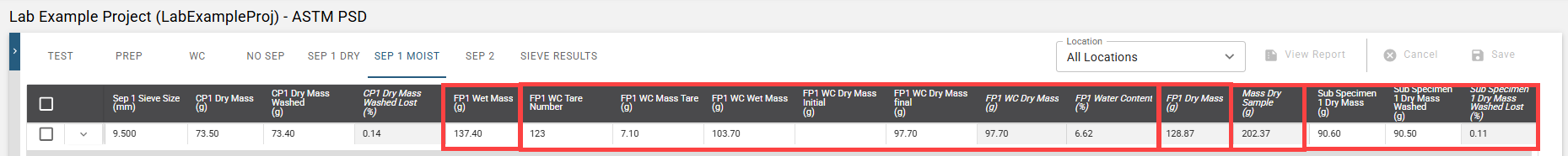

One separation – Moist
In this scenario, the sample (specimen) is in a moist state, and it is impractical to measure the Mass Dry Sample directly by drying the entire sample.
The sample is passed over Separation Sieve 1 producing Coarser Portion 1 (CP1) and Finer Portion 1 (FP1).
The FP1 Wet Mass is measured and the FP1 Water Content is determined. These two values are used to calculate the FP1 Dry Mass. CP1 Dry Mass and FP1 Dry Mass are added together to calculate the Mass Dry Sample.
FP1 would typically be split to produce a smaller Sub Specimen 1 that will not overload the sieves. Sub Specimen 1 is then dried, washed, and sieved. Sub Specimen 1 Dry Mass can be entered directly.

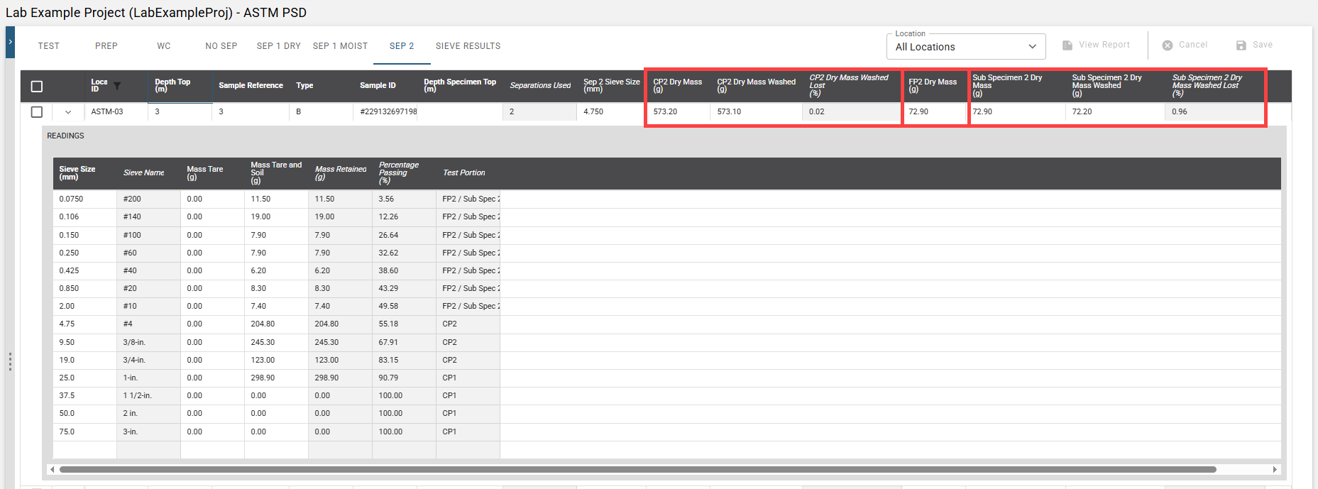

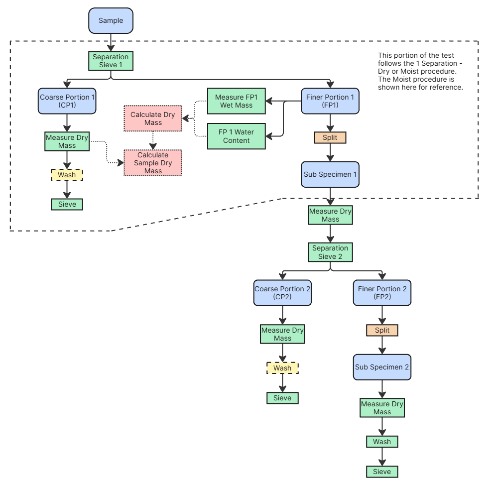

Two separations
In this scenario, the first portion of the test is conducted following the procedures for a single separation in either a dry or moist state (see above).
FP1 would typically be split to produce a smaller Sub Specimen 1 that will not overload the sieves. Sub Specimen 1 is then dried. Sub Specimen 1 Dry Mass can be entered directly.
Sub Specimen 1 is then passed over Separation Sieve 2 producing Coarser Portion 2 (CP2) and Finer Portion 2 (FP2).
CP2 is optionally washed and then sieved. The CP2 Dry Mass is entered directly.
FP2 is weighed and then would typically be split to produce a smaller Sub Specimen 2 that will not overload the sieves. Sub Specimen 2 is then dried, washed, and sieved. The Sub Specimen 2 Dry Mass can be entered directly.

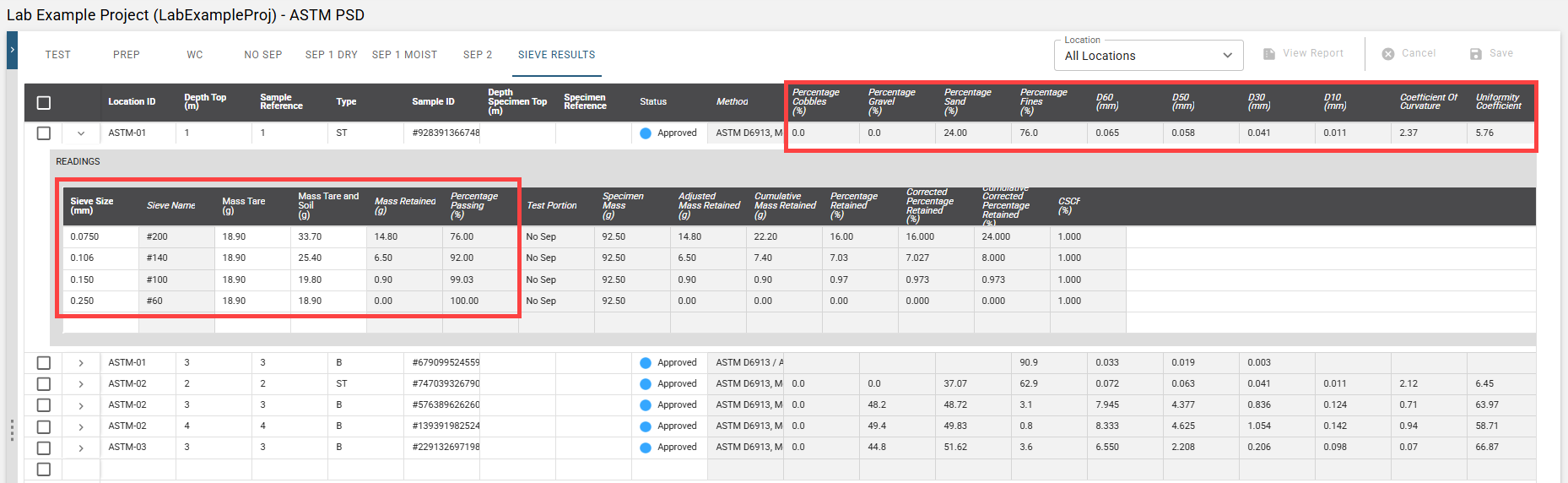

Results
For all sieve scenarios, the sieve readings are entered into the child ASTMPSDSieve group to calculate the Percent Passing each sieve.
Calculations are also performed in the parent ASTM PSD group to calculate percentage constituents, D# values, and other parameters.

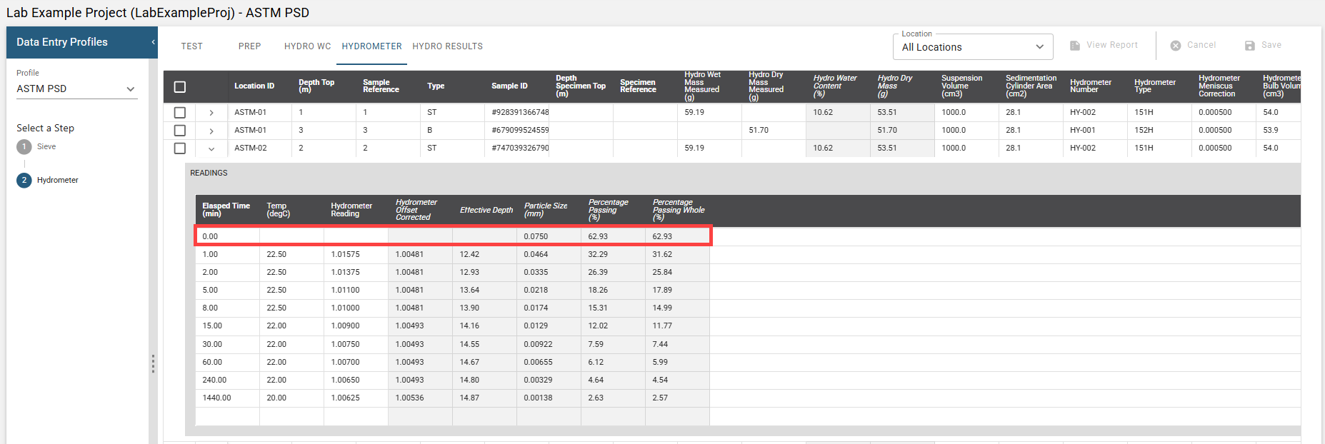

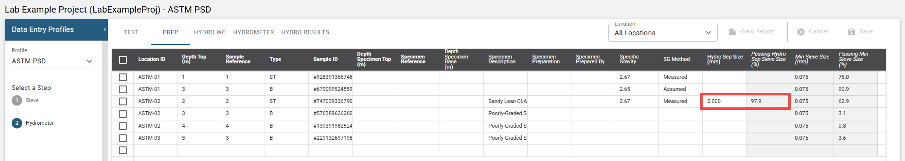

Hydrometer
Hydrometer correction and calibration values can be entered in the parent ASTMPSD group. These values are described further within the ASTM D7928 standard.
Hydrometer readings are entered into the child ASTMPSDHydrometer group.
If the hydrometer is performed in conjunction with a sieve, a “false reading” can be entered with an Elapsed Time of 0. The purpose of this is to draw a continuous PSD curve on reports that connects the sieve and hydrometer portions of the test. For this reading, the Particle Size will be calculated as the minimum sieve size, and the Percentage Passing will be the percentage passing the minimum sieve size.
Both a “Percentage Passing” and a “Percentage Passing Whole” are calculated. Percentage Passing represents the percentage passing for the hydrometer specimen after passing over a separation sieve. Percentage Passing Whole represents the percentage passing of the entire sample. If a Hydrometer Separation Sieve is entered, the calculations will attempt to look up (or interpolate) the percentage Passing Hydrometer Separation Sieve from the sieve portion of the test. If this value is available, the Percentage Passing will be adjusted proportionally to calculate the Percentage Passing Whole. If a Hydrometer Separation Sieve is not entered or the its percentage passing is not available, then Percentage Passing and Percentage Passing Whole will be the same.
This test determines the specific gravity of soil solids. The method involves measuring the mass of oven-dried soil solids and the mass of the water they displace within a pycnometer (glass bottle/flask) of a known volume.
Within the Lab Config Pack, the test data entry and calculations follow the ASTM D854 standard in a relatively straightforward manner.

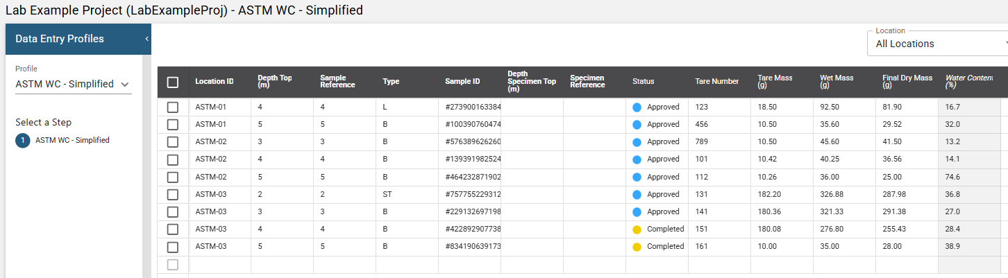

Two data entry profiles are included in the Lab Config Pack.
ASTM WC follows the standard pattern of the other data entry profiles with multiple tabs and a comprehensive set of grids for capturing various details and metadata for the test.
ASTM WC - Simplified is provided as an example of how data entry profiles can be streamlined for more efficient data entry to only capture the necessary details to perform the test calculations.
