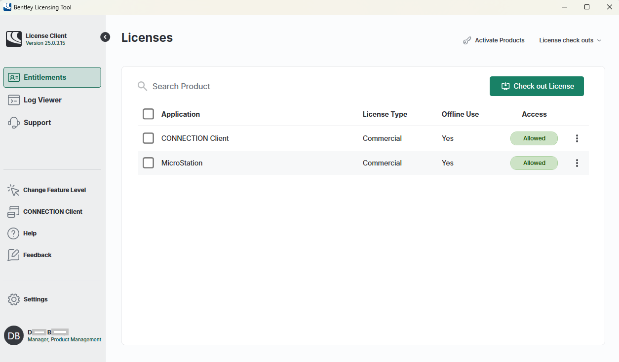

Upon opening the Licensing Tool, you will be presented with your list of local product entitlements and a navigation bar on the left side of the window.
In addition to the Entitlements tab, the navigation includes
The Entitlements Tab
When the Bentley Licensing Tool opens it displays the Entitlements tab. If the CONNECTION Client is signed in, a Bentley login will appear in the upper left corner. Products appear in the Entitlements list if they have communicated with Bentley before. i.e. products that have ever been started on the machine before, and not only the entitlements the user has. They will communicate the following information:

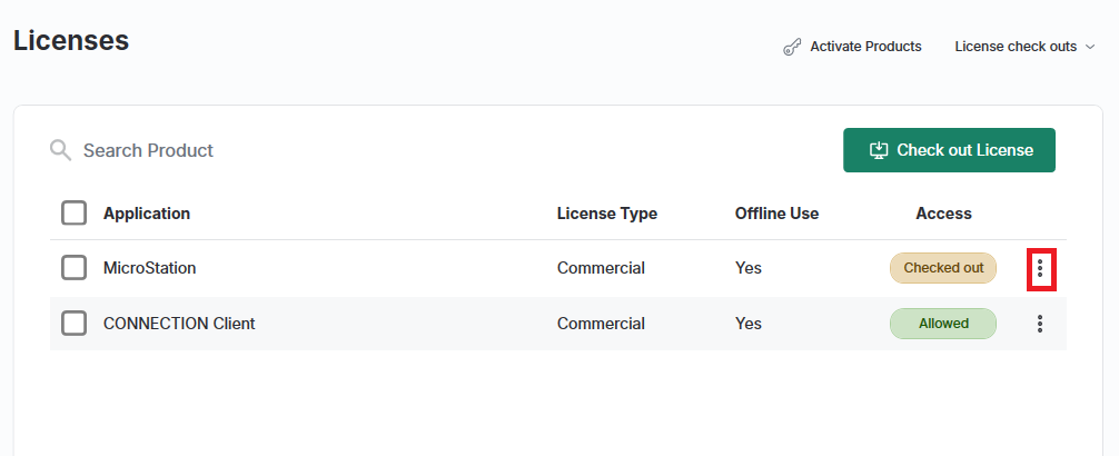

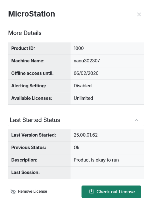

      Each license listed has an option button that provides more information about that license and additional actions that can be taken.
      Actions that can be taken include checking out a license of that product or removing the license from the list if that product is no longer needed on the machine.

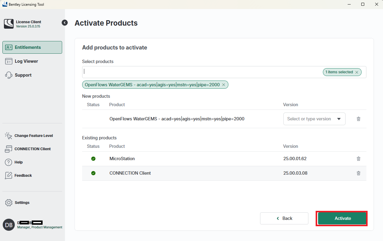

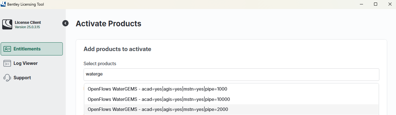

Activate License

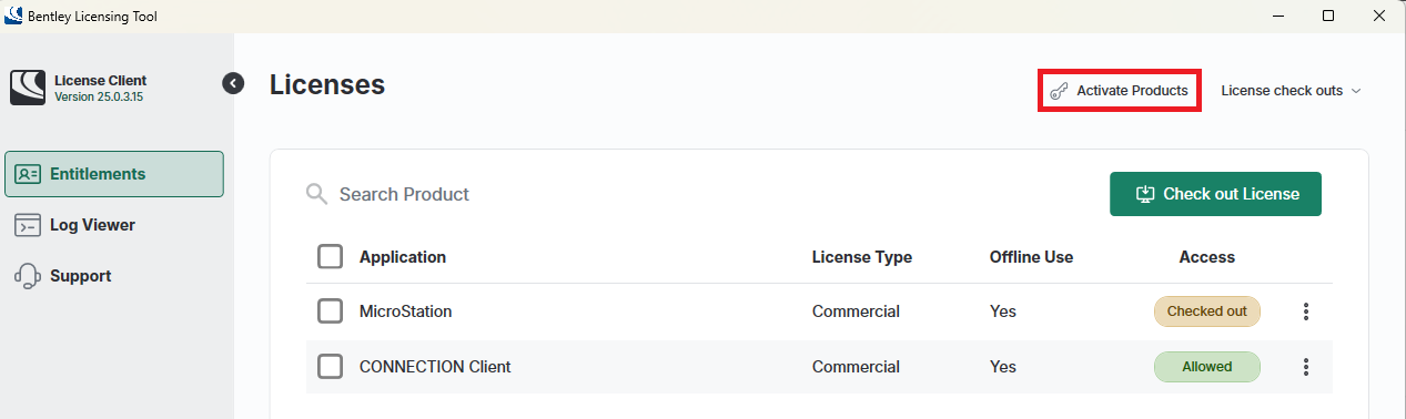

      To "pre-activate" or add licenses to the list before running the product, use the Activate Products button in the Entitlement tab.
      Use the Select Products field to find the products you want to activate and choose them from the search results. Use the version dropdown to pick the released version you want to activate or type in the version number.
      When ready, hit the Activate button.  When the activation is complete, there will be a summary page with the result and the new entitlements will show up in the License list.

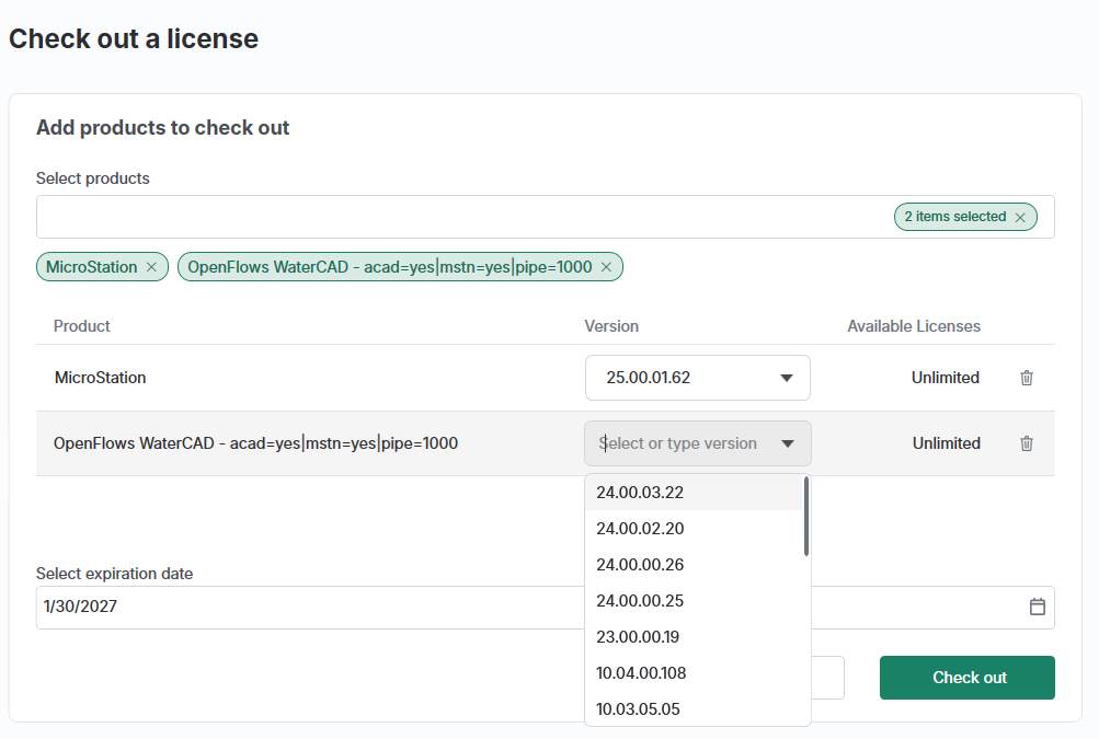

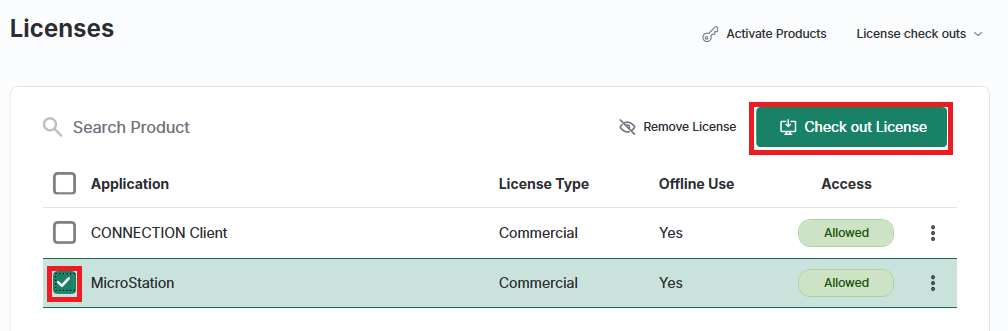

Checkout License
Product licenses can be locked to the computer if it is anticipated that the machine will be disconnected from Bentley Cloud services for an extended period. This results in a license usage for that user and machine to be logged for the duration of the checkout.
To check a license out for the machine, select the products you want to check out from the Entitlements tab and hit the Check out License button.
Alternatively, you can find Check out License in the option menu on an individual application license in the list.
To check out a license:

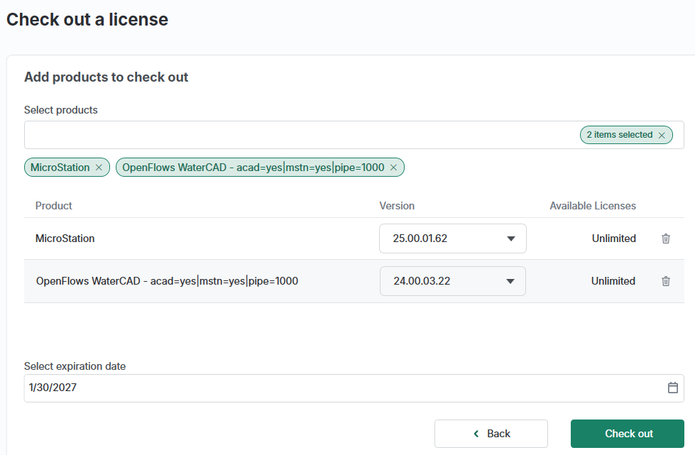

In the Check out a License form, you will be asked to verify the product, feature string (if required), the version to check out and the expiration date.
You can add more products by searching in the Select Products field and clicking on the product name in the search results.

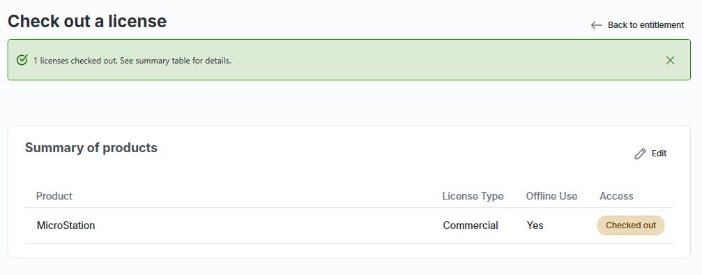

      Once all of the information for the checkout is correct, click the Check Out button. Successful checkouts will be shown in a summary page.

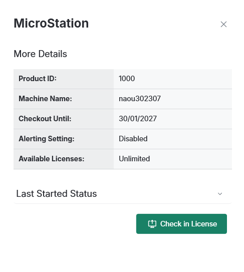

To check in (return) a license:
To return a license prior to the expiration date, select the option button in the Entitlements page, and click the Check in License button.

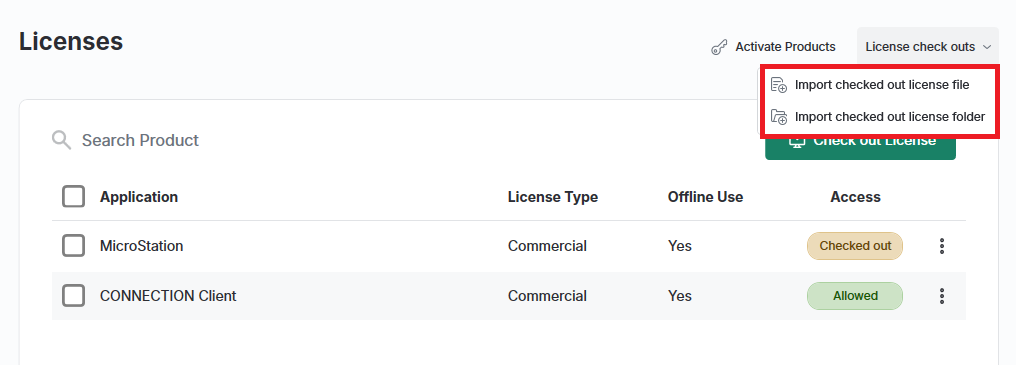

Importing a License
Licenses can be checked out from the Entitlement Management site on behalf of a user and saved as a file. The Licensing Tool provides two options to import checked out license files: Import Policy File or Import Policy from Folder
Option 1: To import a file, select "Import Policy File..." from the File menu, and select either a .belic file or a zip archive containing .belic files (generated from a bulk checkout). If there are multiple .belic files in the zip file, the import will search for the current machine name in the .belic file names to decide which license file to import.
Option 2: To import from a folder, select "Import Policy Folder...: from the File menu. Use the browse dialog to choose the folder where the checked-out license files are stored. Again, if there are multiple .belic files in the fold, the import will search for the current machine name in the .belic file names to decide which license file to import. This folder does not need to be a local file system folder; it can be on a shared network drive.

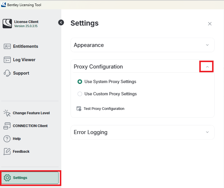

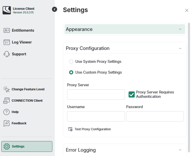

Configuring Proxy Settings
Licensing Tool Proxy settings let you configure communication of Bentley products, including CONNECTION Client and the Licensing Tool, utilizing system proxy settings as configured in the Internet Options control panel or manually configured proxy settings.
1. Select Settings from the Navigation menu and drop down the Proxy Configuration section.
  1. It's recommend to use the "Use System Proxy Settings". For server or test environments where proxy settings must be manually configured, choose the "Use Custom Proxy Settings" radio button instead.
2. If specifying custom proxy settings, enter the computer name of the proxy server. If a port must be specified, append the server name with a colon (:) and the port number (i.e. ProxyServer:8080). To determine what proxy settings (if any) are in use, please refer to the following wiki, specifically the section titled "Determine whether a proxy server is in use."
Note: PAC files are not supported in custom proxy settings.  If you need to use a PAC file, please apply that in the System proxy settings.
3. If user authentication is required as well, select the second checkbox, and enter user credentials.
4. Click the Test Proxy Configuration button to confirm proper configuration.
5. If the configuration test is successful, click the Save button to save changes.

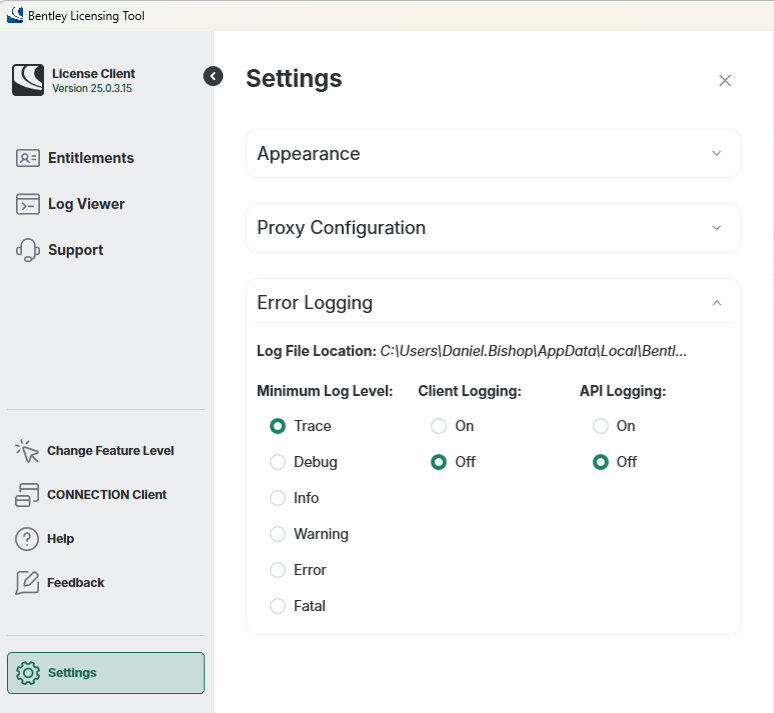

Configuring Error Logging Settings
Subscription Entitlement Service provides diagnostic logging to assist with troubleshooting efforts. By default, the Bentley Licensing Tool maintains a detailed rolling log that is sufficient for most troubleshooting, but configuration options can optionally be configured using the following steps within the Bentley Licensing Tool:
1. Select Settings from the Navigation menu and use the arrow to drop down Error Logging section.
2. The Minimum Log Level shows the level of detail to capture. Trace is the default selection which captures all diagnostic information. Each selection below Trace captures less diagnostic information. Lower levels allow diagnostic information to be captured over a greater time span before the oldest diagnostic data is deleted.
3. Client Logging and API Logging are disabled by default. Enable them to capture additional diagnostic information for each Subscription Entitlement Service application.

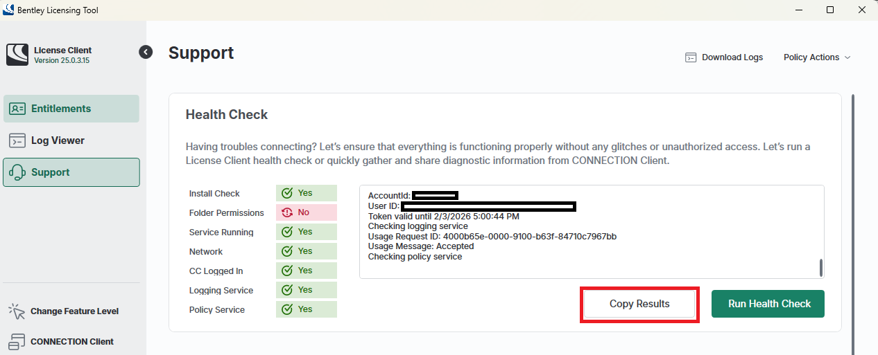

      Health Check Tool

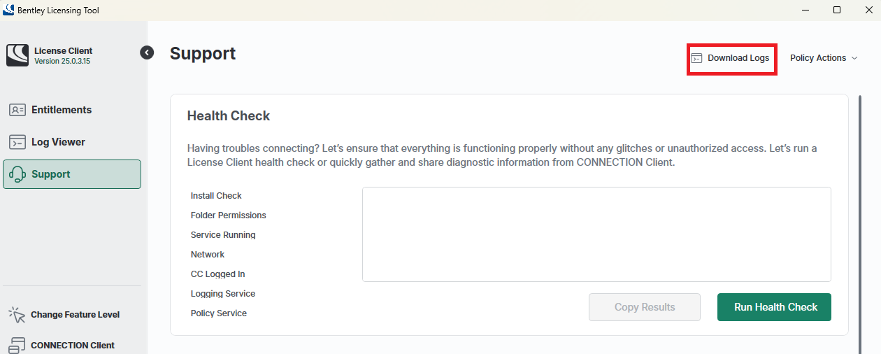

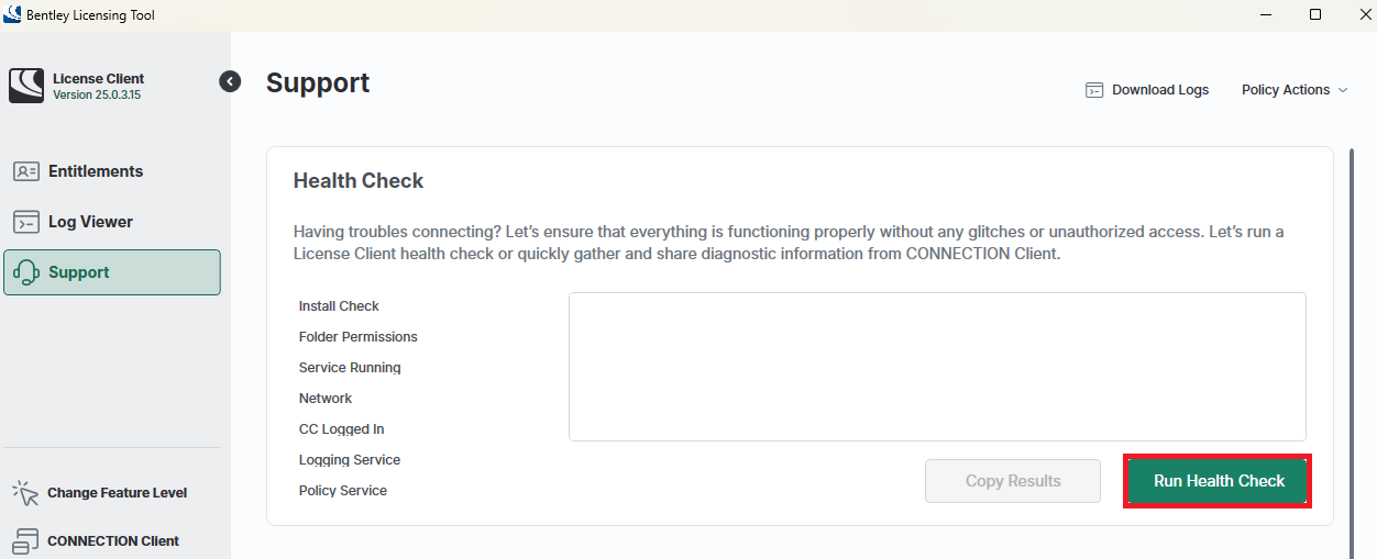

      The Health Check Tool gives Bentley Support valuable information about the current state of CONNECTION Client, Licensing Tool and the machine's connection to Bentley Cloud services. Click the Run Health Check button to initiate a run. All the tests being run will be displayed.  To easily retrieve the results to send to Bentley Support, use the Copy Results button.

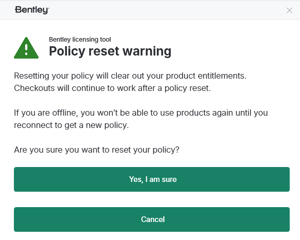

Resetting the policy will empty your entitlements tab and will force a new policy next time an application is used. This option is useful for license troubleshooting or for clearing old licenses.
Click the "Yes I am sure" button to proceed.

      Use the Download Logs button in Support to gather all the logs that may be necessary to diagnose and troubleshoot issues.
