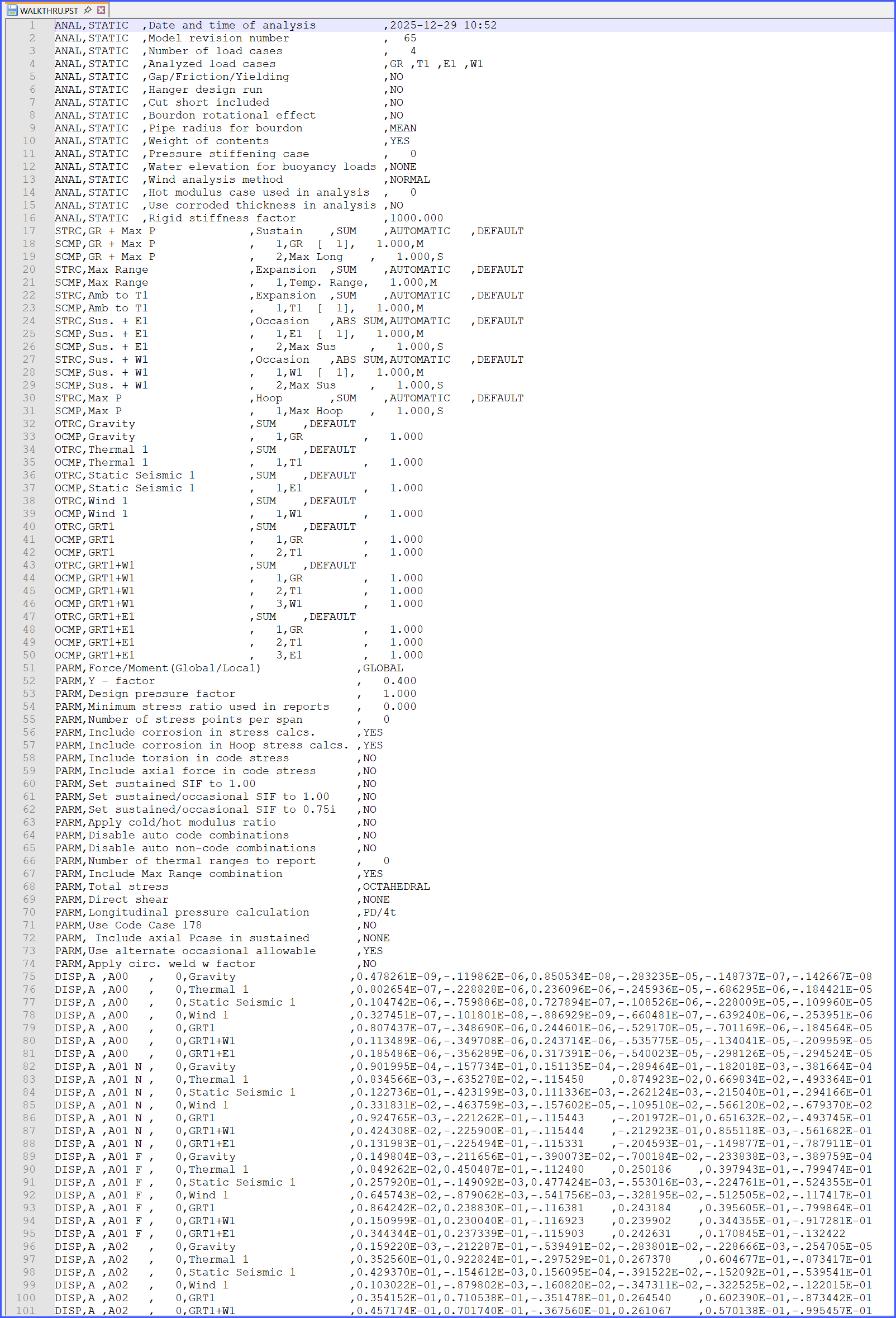

A PST file is a comma-delimited text file generated by AutoPIPE after performing an analysis and creating a quick output report. It contains key analysis results and can be opened in any text editor or imported into spreadsheet applications for further processing.
Example:

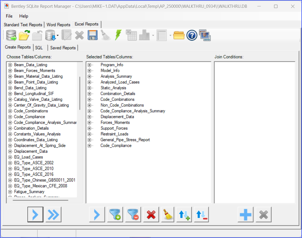

- Excel Reports (Result > Report Manager > Excel Reports), see example below that maintains PST order with more data than the original

Example PST file
