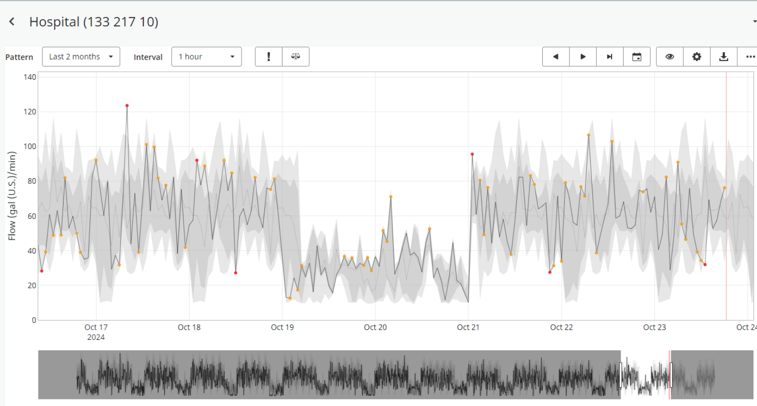

The Large Customer detail graph will show detailed chart for a specific sensor. By default the a 3 month signal history will be read.
The chart displays initially a time-window that covers the current day plus some hours into future, with the range-slider below the main graph turned on. This view is particularly useful to monitor network parameters and to easily spot any anomalies (that can represent internal leaks, anomalous consumptions, etc) in real time. The pattern confidence bands are represented by a grey band, while real (re-sampled) values are represented as a black, red or orange circles. Whenever real data (re-sampled) goes outside the pattern confidence bands (above percentile 95 or below percentile 5 of the pattern), an outlier is identified and the real value is colour coded with a red circle. The user has also the option to navigate in the time history series to understand past behaviours or have access to future expected behaviour (short-term forecasts), by moving the range-slider below the main graph.
Figure 1 - Large Customer detail graph

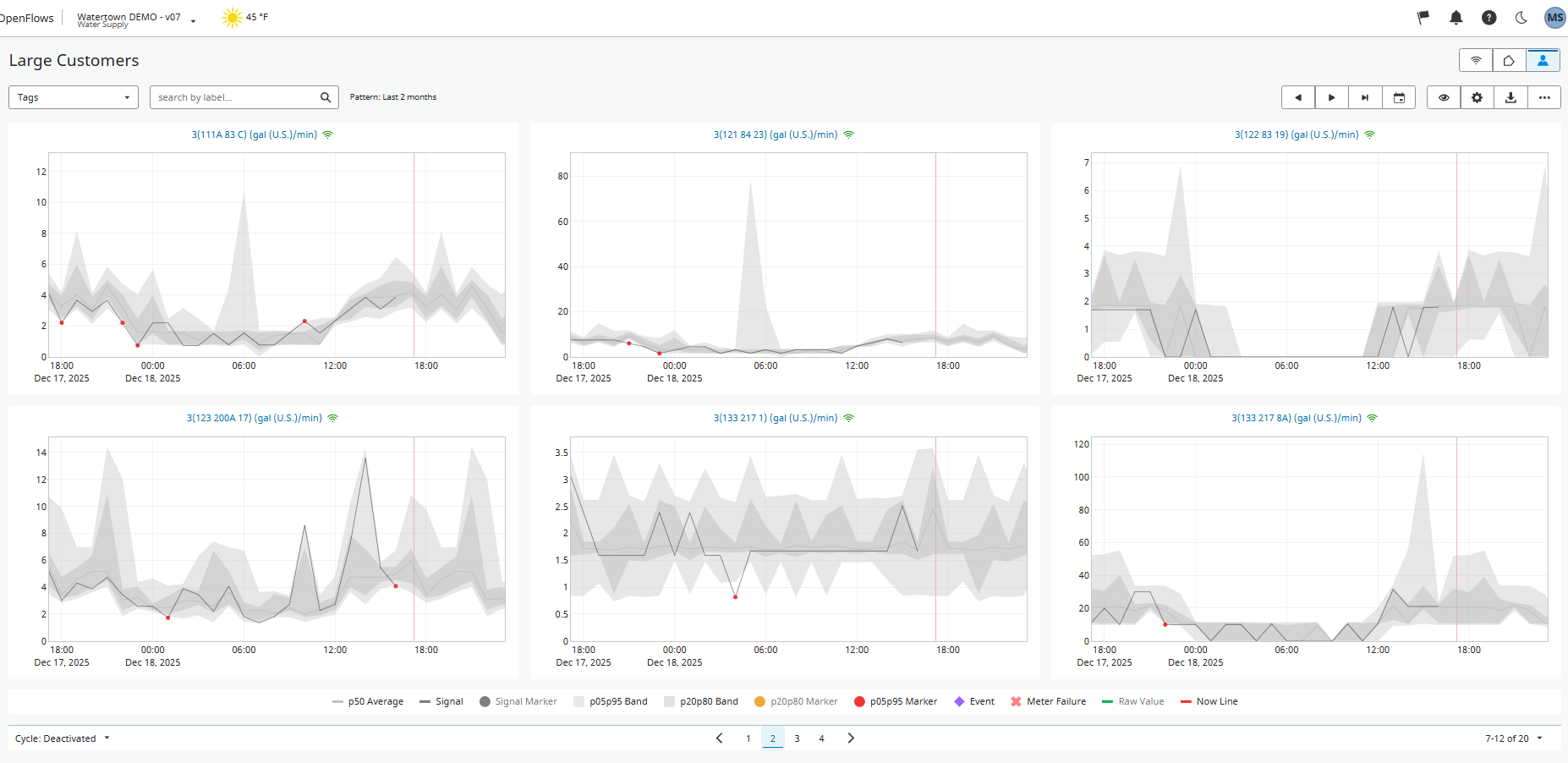

Figure 2 - Large Customer Overview page

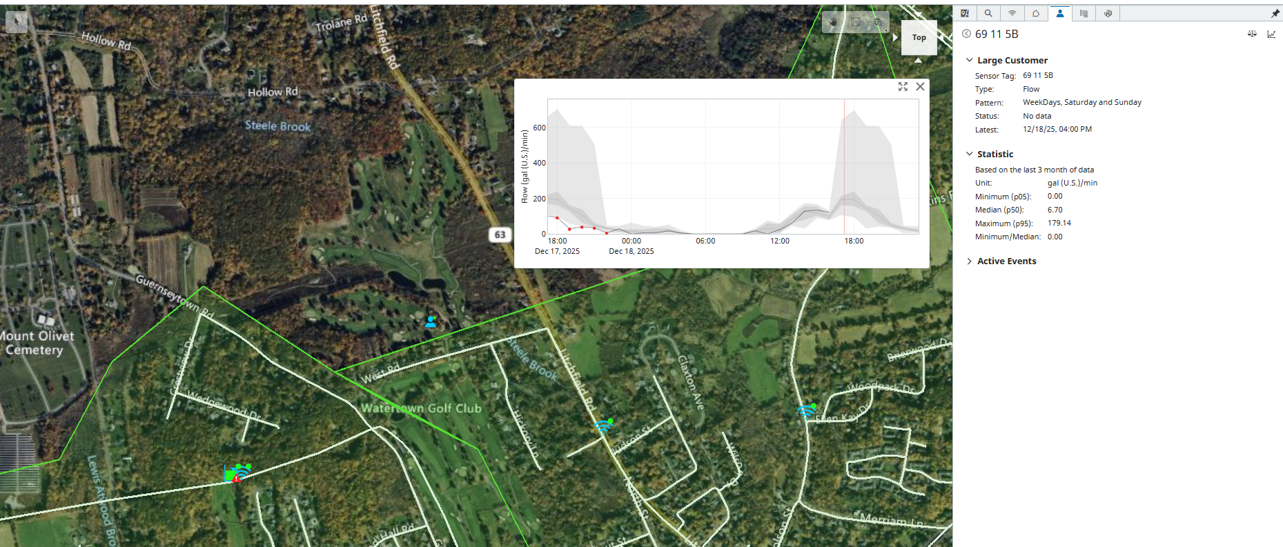

Figure 3 - Large Customer Map view

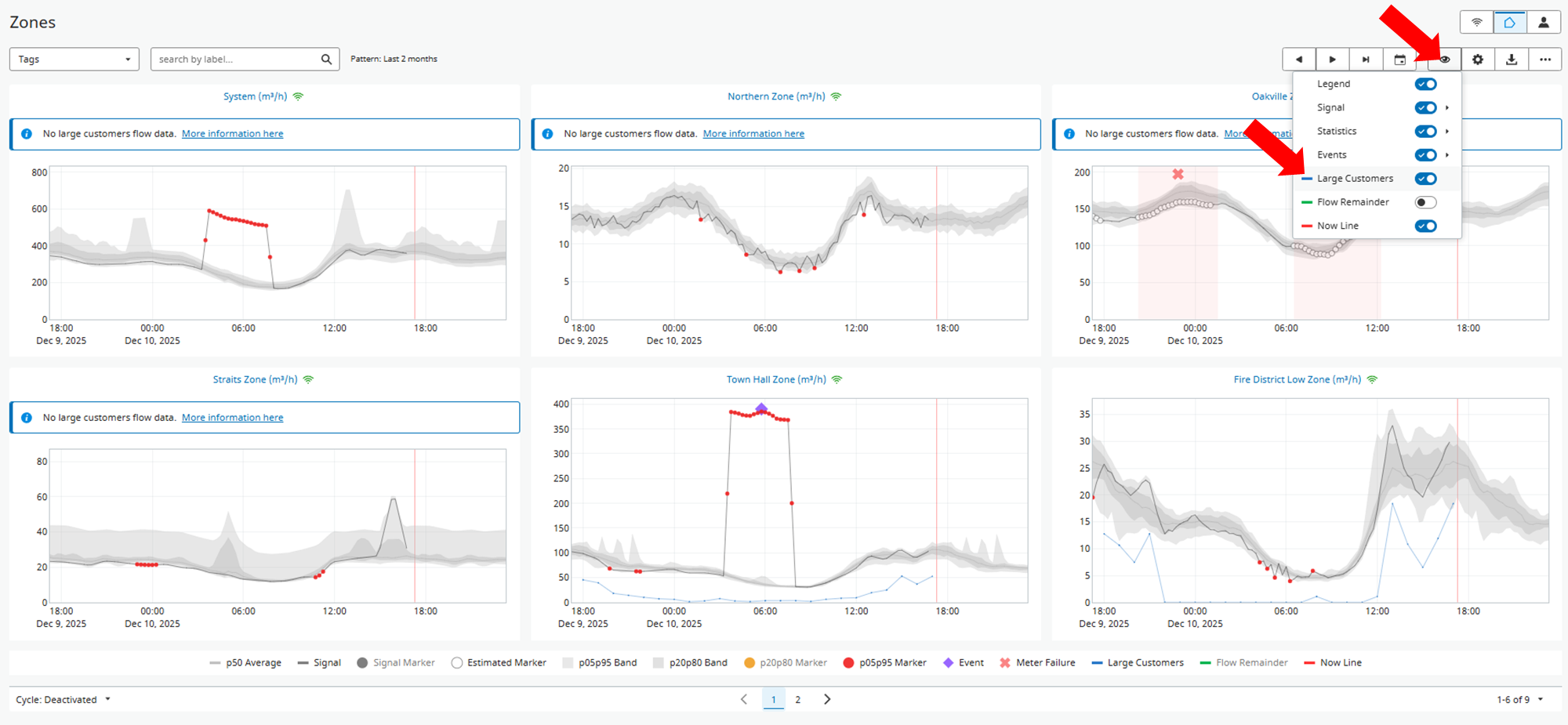

The total large customer flow can be obtained by summing each individual smart meter belonging to a specific zone and be displayed directly on the zone graph. By default the total large customer flow is disabled, but the user can enable it from the Zone overview page or zone detail graph page, by clicking on the visibility button and enabling large customer flow, which will be represented with a blue line (check figures below).
This is particularly useful to more efficiently analyse if zone flow events might represent real bursts or leaks or the zone flow increases are just due to large customer consumptions.
Figure 3 - Enabling large customer flow in the zone overview graph
Figure 4 - Enabling large customer flow in the zone detail graph

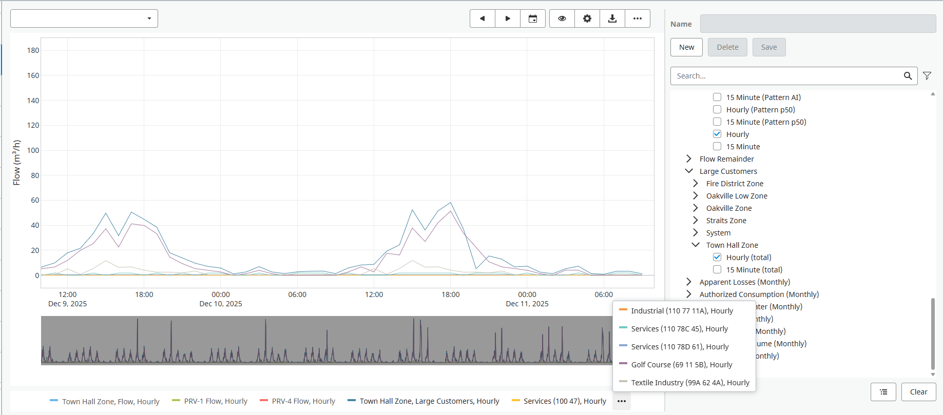

The Flow Remainder time series can also be enabled and represents the difference between the total zone flow and the total large customer flow series.
The Total Large Customer Flow and Flow Remainder time series is also available under the Graph Comparison:
Figure 5 - Enabling large customer flow in the zone detail graph.
When accessing the comparison page directly from the zone graph detail (by pressing the comparison shortcut above the zone graph ) , automatically the inflow and outflow sensors of the zone as well as the total large customer series will be displayed. To quickly access those time series in the right side panel, press the "show selected in series-tree" button, located on the bottom of the side panel.
From the comparison page the user can also easily disaggregate the Total Large Customer Flow series to analyse the contribution of each individual large customer belonging to the same zone. To do this, press the graph icon located on the right side of the total large customer series, as shown below:
After that the graph will automatically populate with each individual Large Customer series (for that specific zone), as shown below. This can be useful to understand if in case there is a big large customer flow increase, which is the main responsible customer.
Figure 6 - Displaying each individual Large Customer series belonging to the same zone.
