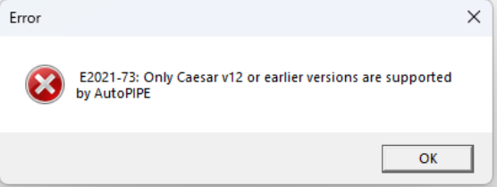

E2021-73: Only caesar v12 or earlier versions are supported...error message in AutoPIPE
The following is displayed when running trying to import a CII into a model consistency check report in AutoPIPE:
* * * E R R O R * * *
 E2021-73: Only caesar v12 or earlier versions are supported by AutoPIPE
How to avoid it?
Currently, AutoPIPE supports importing caesar CII files up to version 12 (AutoPIPE See KB article here). Unfortunately, caesar does not provide backward compatibility for newer versions, which creates significant challenges for interoperability between our products.
