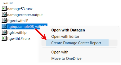

To generate the Center of Damage report in SACS, simply right-click on the Fatigue input file and select Create Damage Center Report.
You will then be prompted to define the scatter diagram units (Feet or Meters).

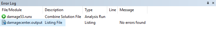

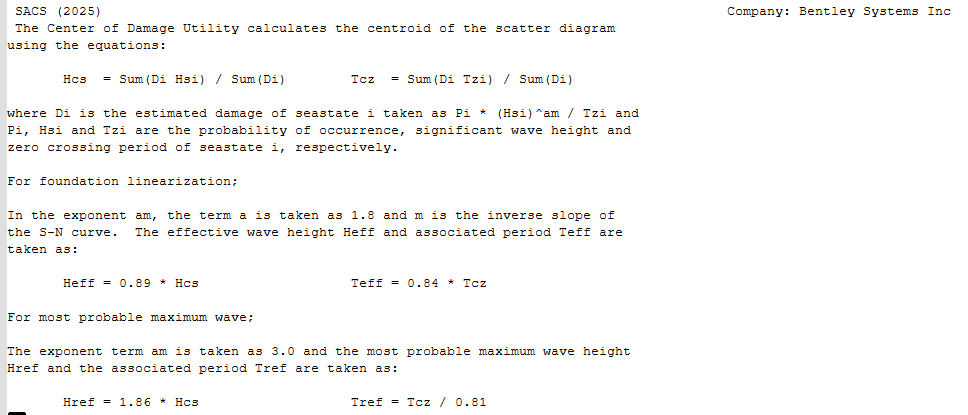

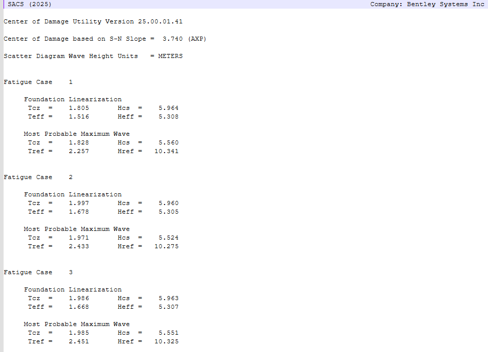

Once confirmed, SACS automatically executes an analysis run file (damage53.runx) and produces the listing file damagecenter.output. This file contains the full Center of Damage report, including Hcs, Tcz, Heff, Teff, Href and Tref for each fatigue case.
The output format will match the sample shown (Sample 07 FTGINP), and can be viewed directly by opening the damagecenter.output listing file.
