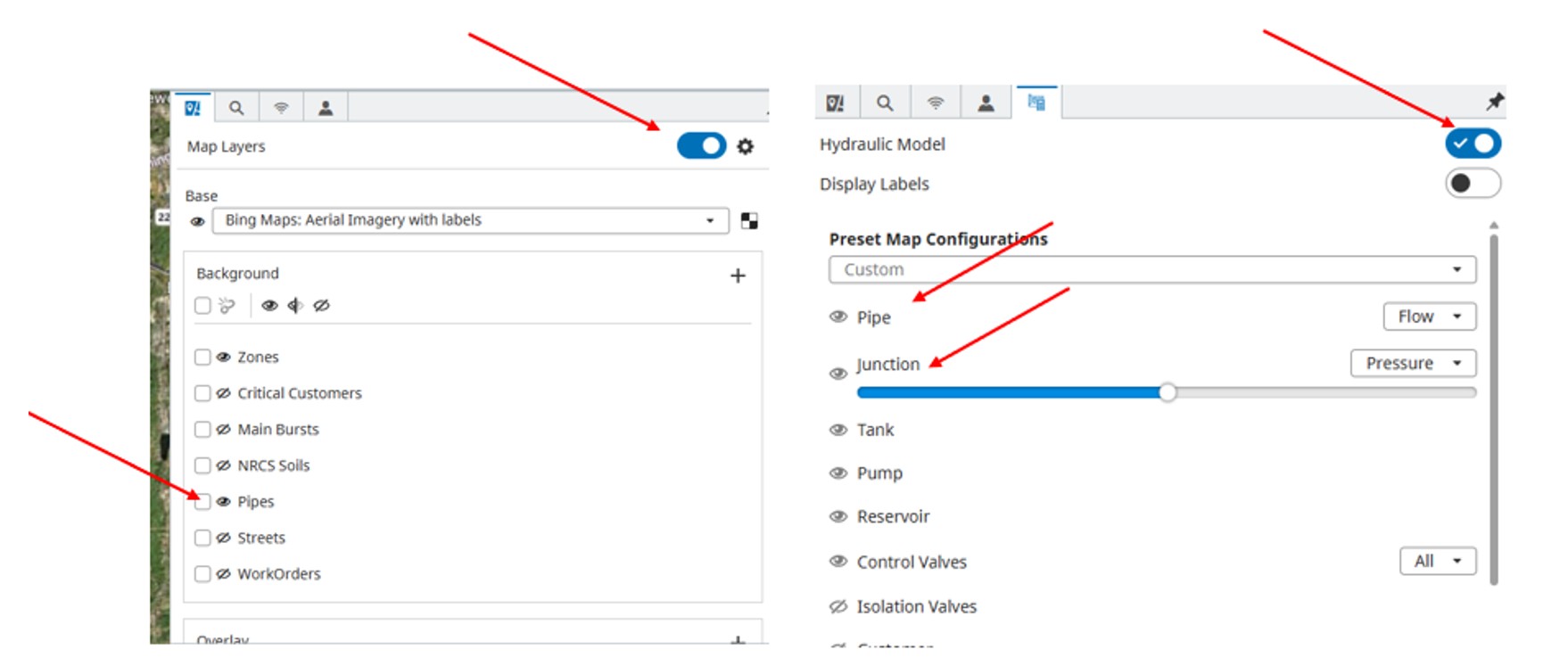

If your model or GIS elements are not displayed in WaterSight, try the following resolutions:
1) Refresh your browser page.
2) Try accessing the model in a different browser.
3) Make sure the element layers are set to visible in the panel on the right side of your screen.
