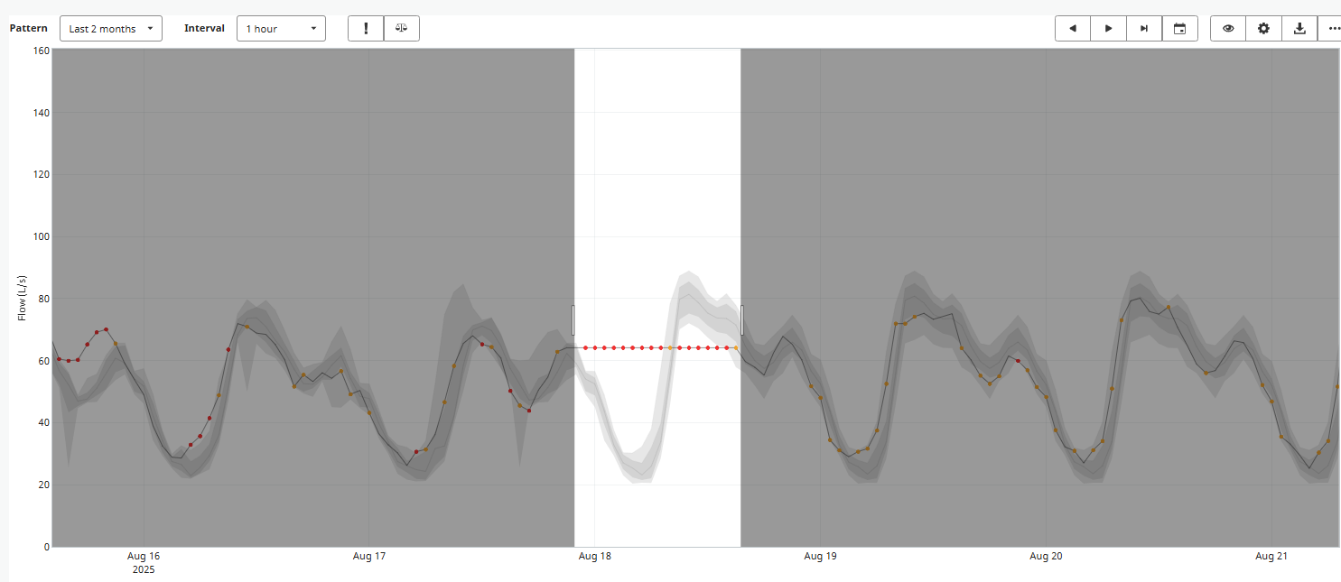

A particular case can occur with flat reading events. The goal of flat reading events is to detect when the sensor stops to measure correctly, by marking always the same value (figure below).
Figure 1 - Flat Reading measurement

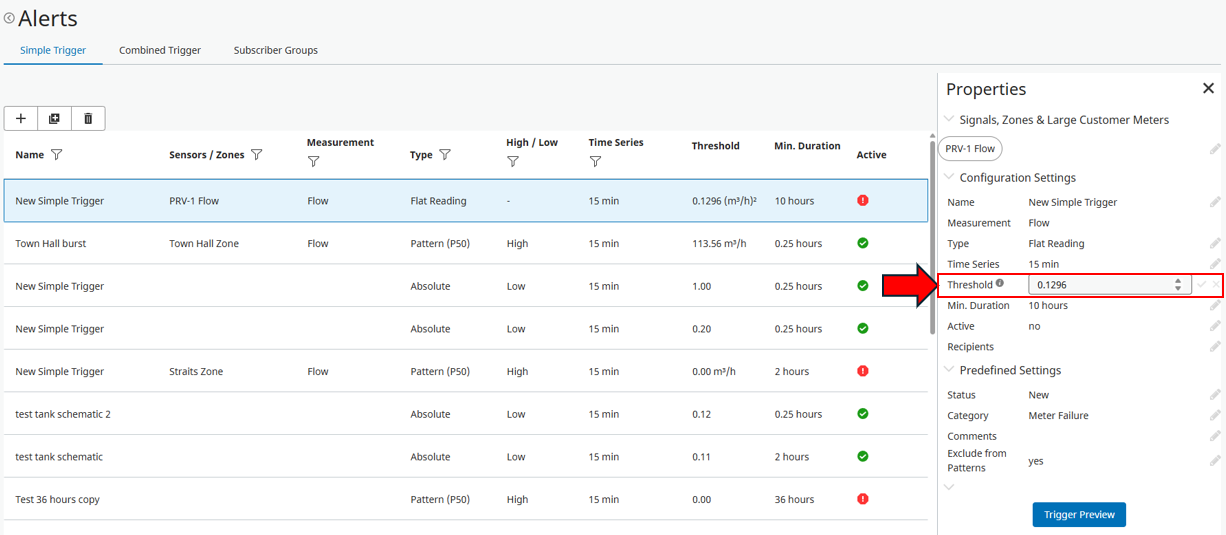

After the user has configured those type of alerts in the administration, it might happen that in particular cases false flat reading alerts are being generated (when it shouldn't) or too many flat reading events. If that is the case, the admin user should change the threshold value (or variance) that is defined in the administration alerts page (figure 2). WaterSight already assumes default values, and those should only be changed in case flat reading events are not being properly generated. User should consider the following:
Figure 2 - Updating flat reading threshold
