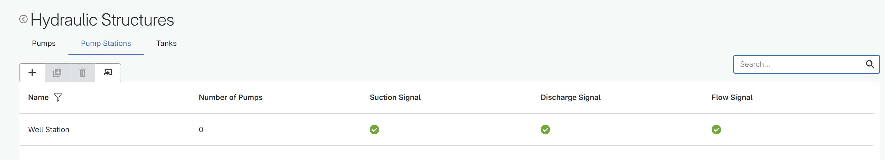

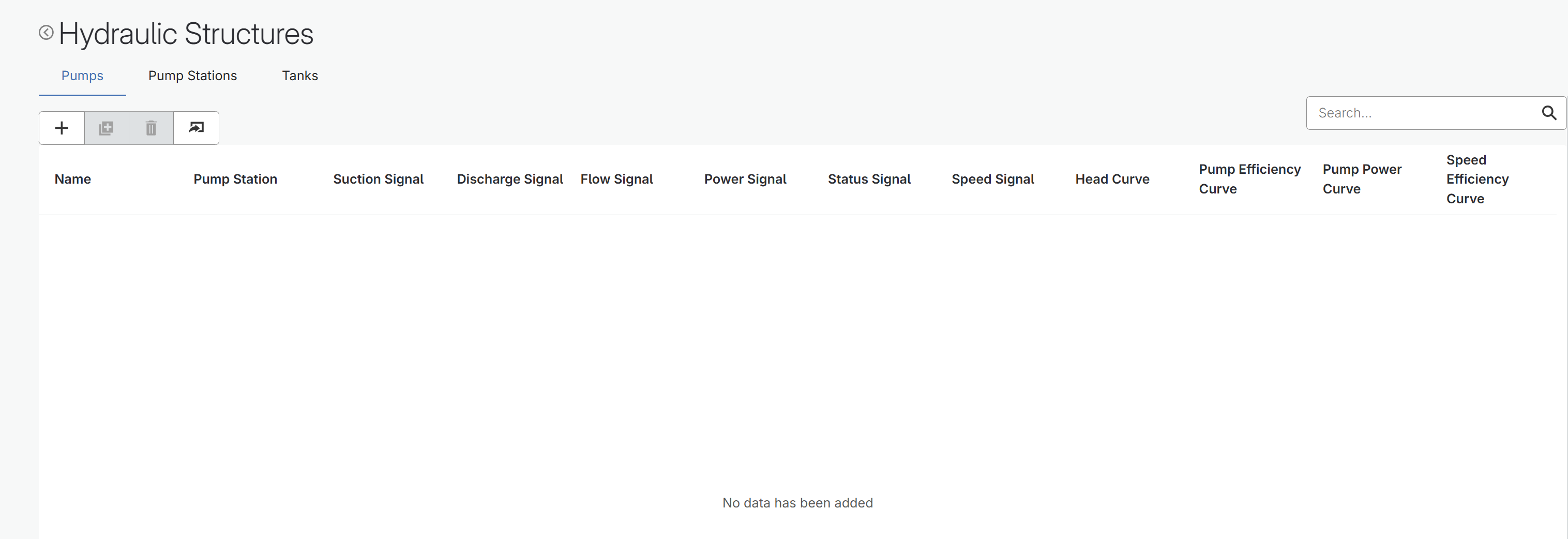

If the status signal was not integrated into WaterSight, then all the values calculated are related to the all pump station and values for each individual pump are wrong and should be ignored. Just in case the pump status signal for each pump is not available and in case the flow is shared between all pumps, it is suggested to:
- in the Admin >> Hydraulic structures leave the pumps tab empty
- only fill the pump stations tab.

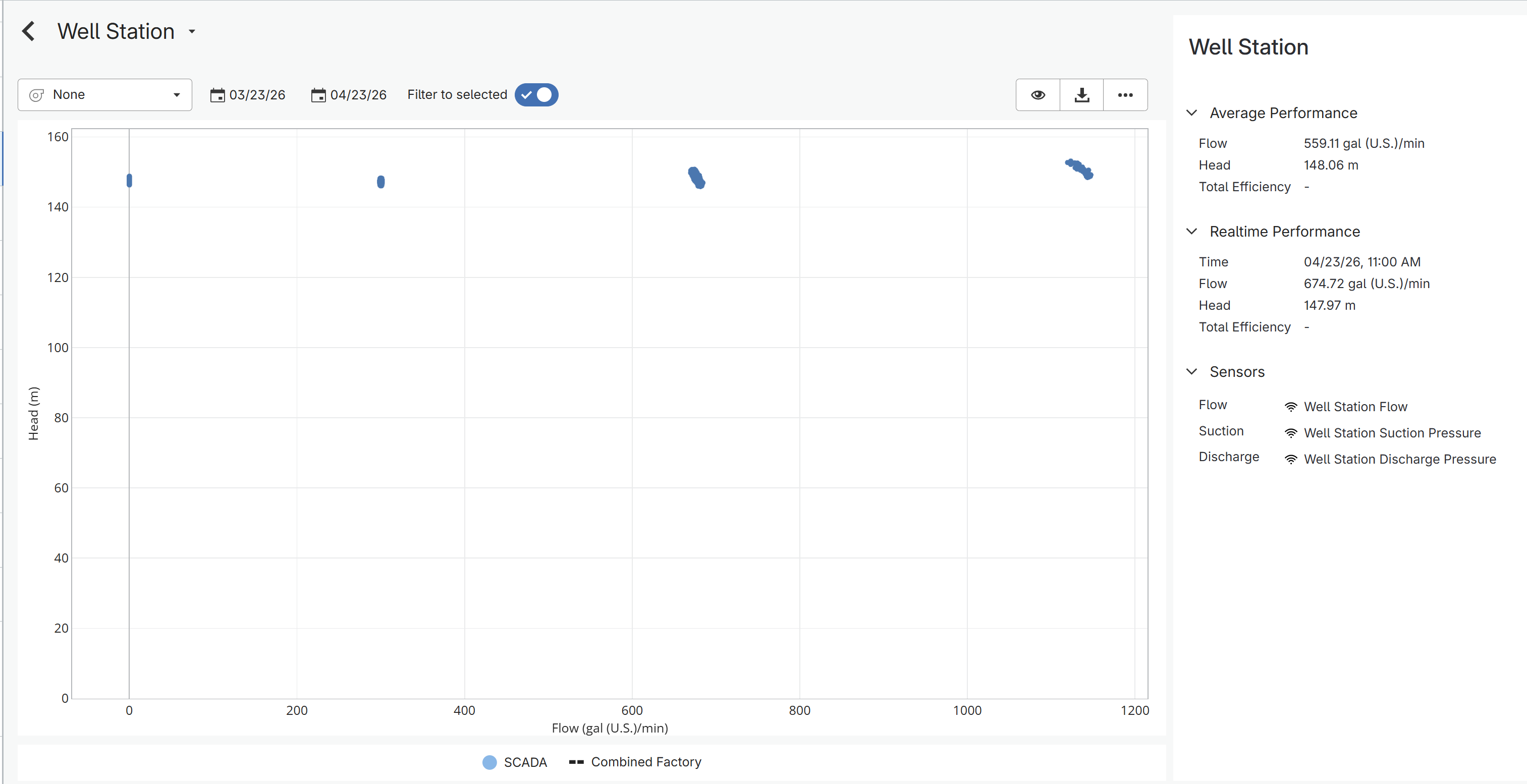

- in this case Pumps page will be empty and only Pump Station details page will show the pump station operating points but no efficiencies will be calculated neither the combined pump curve (example below)
