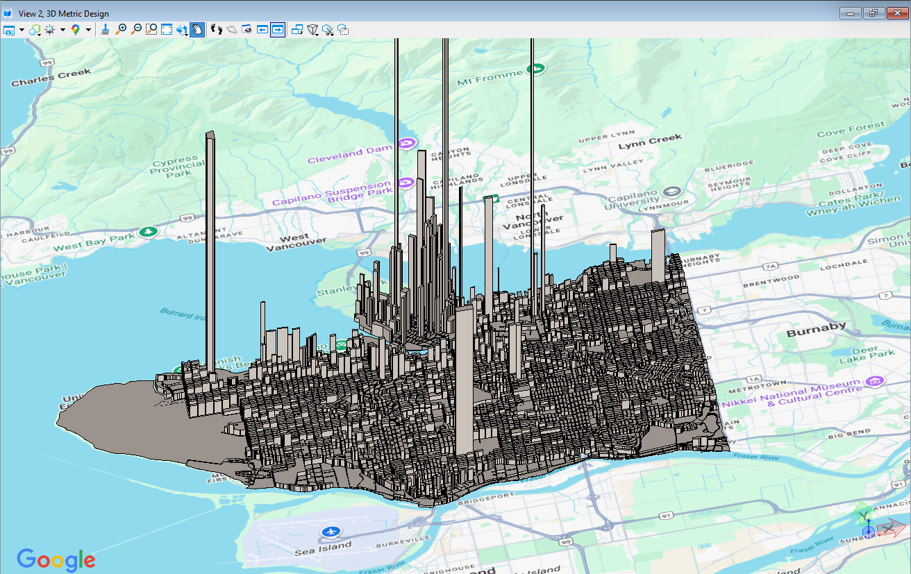

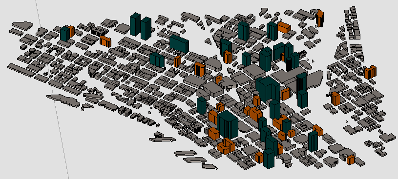

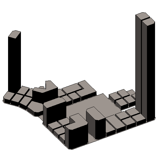

Run/Execute project
Load the project "ImportGJson.py" from the Python Editor dialog and Run/Execute the python script.
When prompted, select the following GEOJSON files: Parcels.zip
Boundary.geojson
parcels_2D.geojson
parcels_3D.geojson
The script will read these files and create the corresponding elements.
