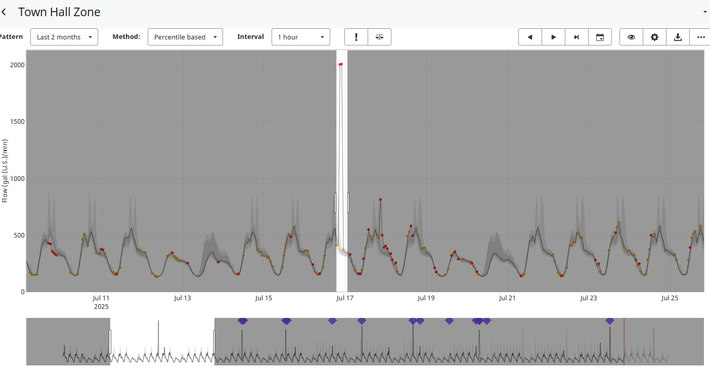

- Navigate to the sensor, zone or large customer graph detail, by acceding the Maps menu or the Network Monitoring menu.
- In the graph detail, navigate to the correct time of the event. It is recommended to change the time series Interval to "15 Minutes".
- In the main graph window make sure to zoom to the right period of the event (using the mouse over the main graph), which should includes start and end date (figure below).

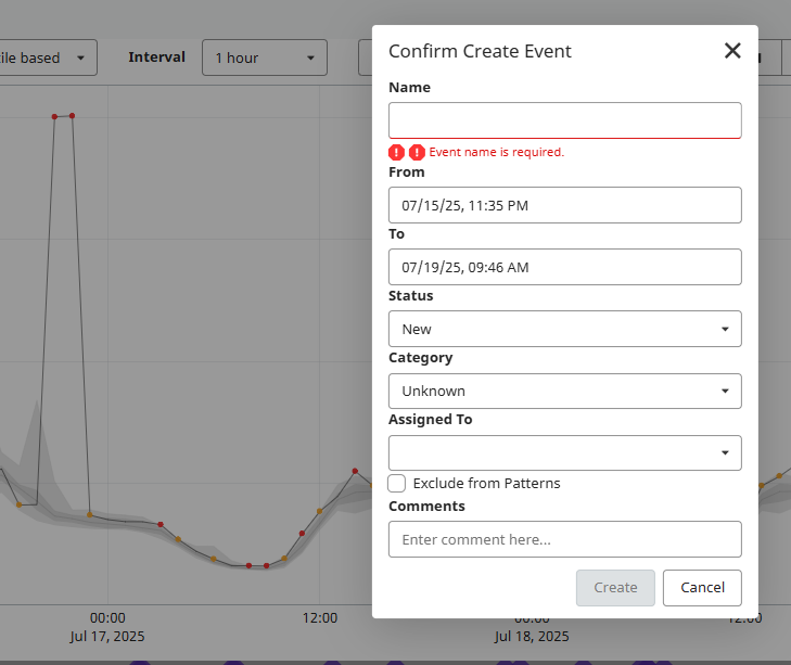

5. Click on the create event button (
). Give a name to the event, and make sure to correctly adjust the start and end date of the event. This is very important when running the leakage geolocation. Categorize the event and update the status. Click Create.
6. Once clicking create, the event will be added to the graph and represented with a pyramid purple symbol. Click over the event symbol to enter the event details graph.
7. This event will also be available directly from the Active Event list and highlighted in the Maps (represented with the warning icon near the sensor or zone) in case its status is open (New, Open, Field Work or Under Investigation).
