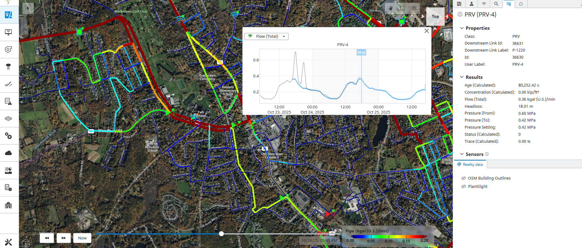

In the Map page, turn on the hydraulic widget. You will notice pump, tank, valves and wi-fi icons represented with a dot/circle. The dot/circle indicates that those model elements are connected to a sensor element. Green color means that the sensor has good data, red means that the sensor has no data or data is delayed. Yellow/orange means partial data. Click on that model element and you will be able to see in the side panel the name of the sensor displayed. In the small graph that gets displayed you will also be able to see the model value at blue, and the sensor value at black
Directly comparing these two lines at some points of interest allow the user to understand how calibrated and accurate the model can be. Using the measurement dropdown located on the top left of the graph allows to change the measurement that is displayed in the graph for the specific selected element.

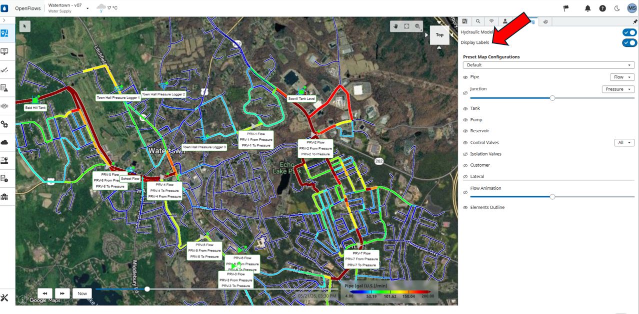

If the display labels (toggle located on top of the side panel) is on, that you will be able to see all the sensor names associated with model elements in the map.
Another important note: if the black and the blue line match the exact same value for the initial time step of the model run (when the blue line starts), then it means that sensor data is being used to set the initial conditions for the model run. In case there is a gap between the value for the initial timestep of the model run and the sensor data, then the sensor data is not being used to actively set the initial conditions of the model.
