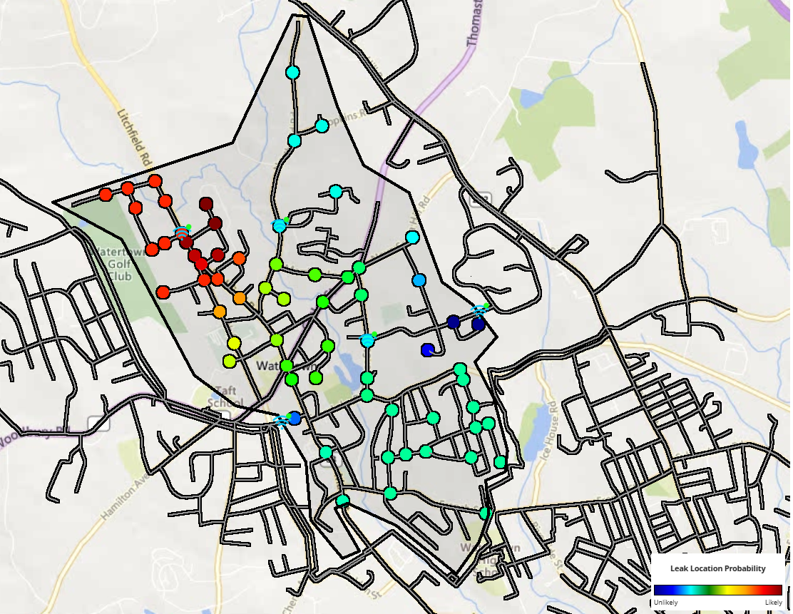

WaterSight can monitor in near real time each zone flow and pressures and automatically alert for any potential leak or burst in the system. Once an event is generated or manually created by the user, the platform can effectively narrow down the search area by pint-pointing in a map the most likely hotspots (at red) inside the zone/DMA, as shown in figure below.
Figure 1 - Map with the most likely (at red) and unlikely (blue) spots of potential leakage inside the DMA (DMA boundaries are represented with black polygon).

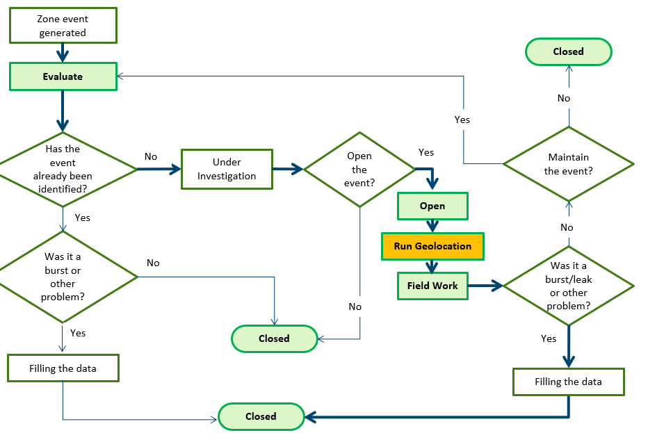

The geolocation is triggered from a zone event, that can be either generated by the software, or manually created by the user.
If an automatic event is generated, the user should always first validate the event and discard potential false positives. Only if there is a chance to exist a leak, the user should trigger the run geolocation to understand most likely location. A typical workflow is represented in figure below.

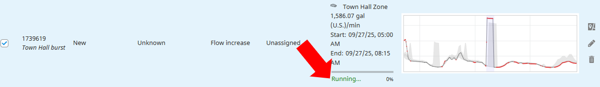

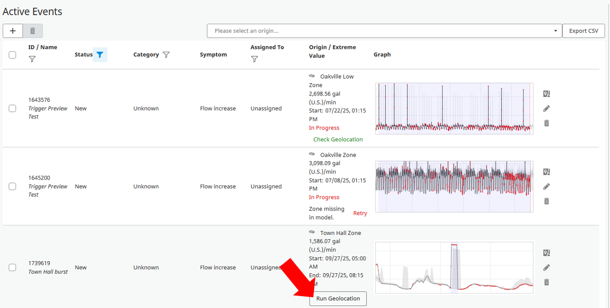

  2. Once a zone flow event is automatically triggered it will be automatically listed under the Active Events list. Note that not all automatic trigger events might represent real leaks or bursts in the system, so it is always important for the user to first validate the event. In case there are high chances that the event is representing a real leak, then the user can immediately click on the "Run Geolocation" button in order to trigger the geolocation run to help narrow down the search area. Note that this button is only available for flow events assigned to zones.
          3. Wait until the geolocation run finishes, or access the temporary (in progress results) by directly clicking on the link "Running..."

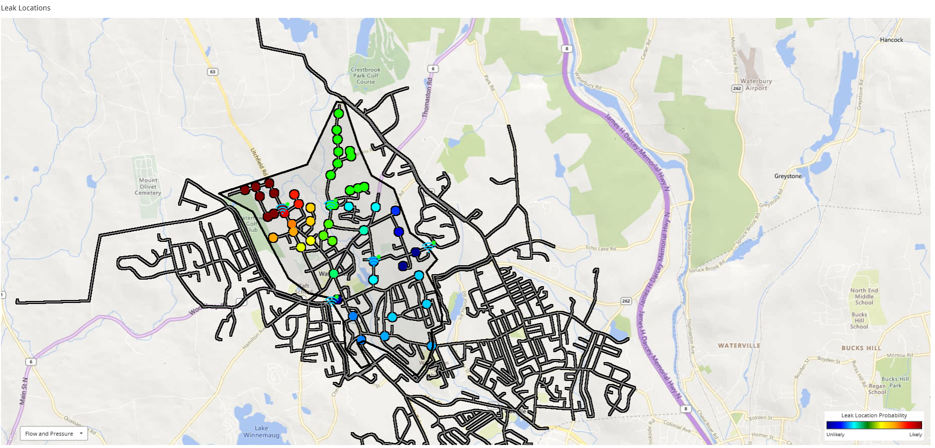

         4. Once the run finishes, click on "Check Geolocation". The most likely nodes locations for the leakage will be colour coded red and orange, while the most unlikely nodes location will be colour coded blue (Figure 1).

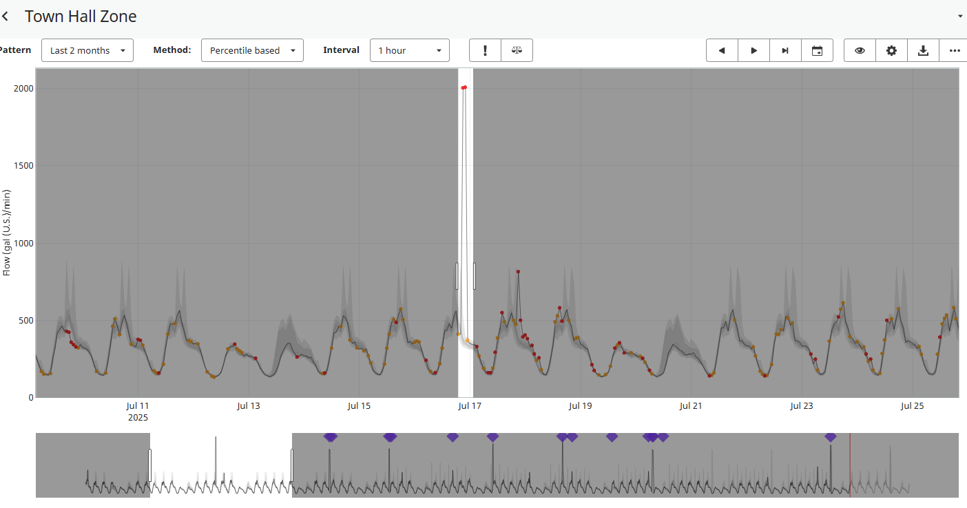

  2. Navigate to the zone graph detail, by acceding the Maps menu or the Network Monitoring menu.
  3. In the Zones graph detail, navigate to the correct time of the event. Make sure to change the time series Interval to "15 Minutes".
  4. In the main graph window make sure to zoom to the right period of the event (using the mouse over the main graph), which should includes start and end date (figure below).

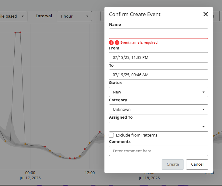

         5. Click on the create event button ( ). Give a name to the event, and make sure to correctly adjust the start and end date of the event. This is very important to make sure that the leakage geolocation results are maximized. Categorize the event and update the status. Click Create.

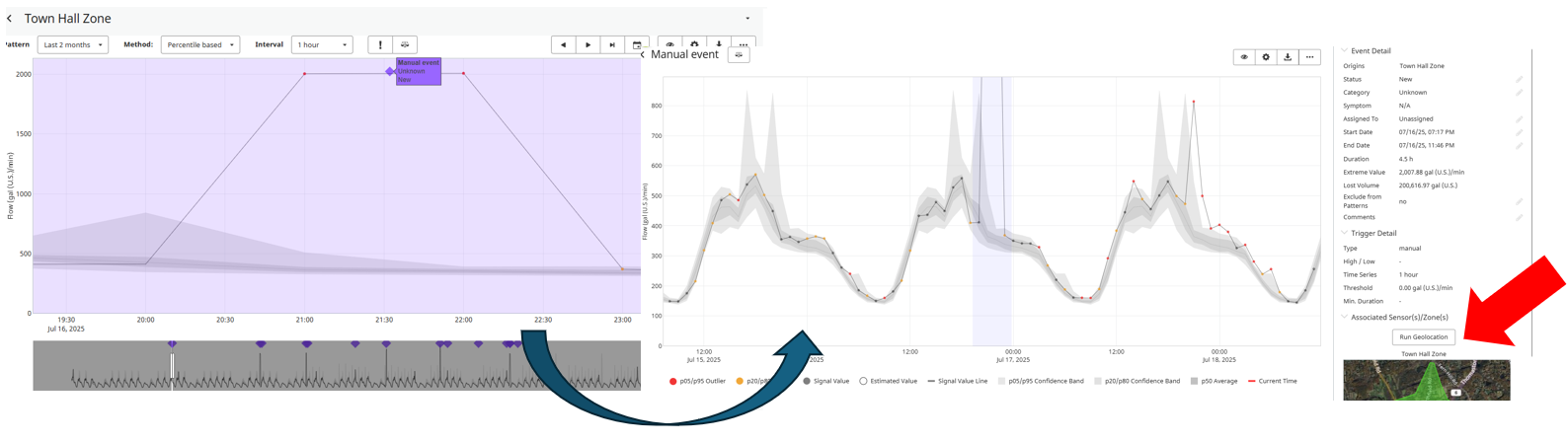

        6. Once clicking create, the event will be added to the graph and represented with a pyramid purple symbol. Click over the event symbol to enter the event details graph. From there, on the side panel, click in the "Run Geolocation" button. This event will also be available directly from the Active Event list
      7. Wait until the geolocation run finishes, or access the temporary (in progress results) by directly clicking on the link "Running...". Once the run finishes, click on "Check Geolocation". The most likely nodes locations for the leakage will be colour coded red and orange.

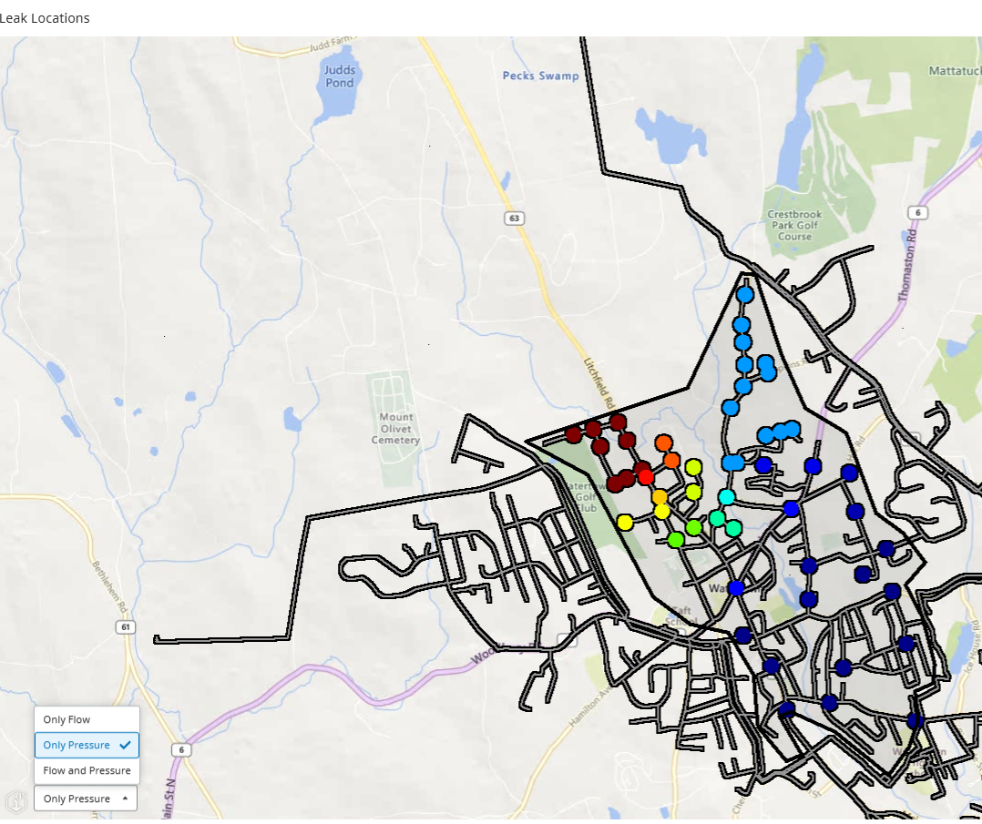

The results will display the nodes with higher leak probability inside the zone. Nodes with higher leak probability will be displayed with red colour, while nodes with less leak probability will be displayed with blue colours.
By default final results are always calculated based on influence of both zone flow and zone pressure (on the bottom left of the map, "flow and pressure" dropdown is selected).
However the user can further analyse and investigate the results just considering the influence of pressure sensors inside the zone (in the dropdown select "Only Pressure") or just considering the influence of flow sensors (in the dropdown select "Only Flow") and results will update accordingly.

The geolocation results (Figure 1) include a map with the nodes colour coded by likelihood of leak as well as the identification of all flow and pressure sensors used in the geolocation run.  Check that all the inflows and outflows into the zone are being considered as well as all pressure sensors within the zone.

In case you run the geolocation, and you obtain a very big likelihood area (represented with red nodes), most likely that there are not enough sensors to allow a further narrow down of the search area. Usually this occurs when only two sensors (flow and/or pressure) are available for each DMA/zone. Ideally three or more sensors per DMA/zone are required in order to get better results.
