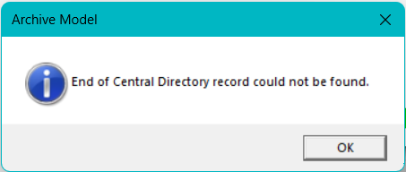

End of Central Directory record could not be found... message found when opening model in AutoPIPE
The following was found when opening a APC file in AutoPIPE:
Archive Model
OK
Archive Model
DAT file not found.
OK
why and how to avoid the issue
This message was only reported one by one user and was attributed to an invalid *.APC file.

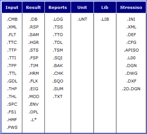

Test if *.APC file can be opened by AutoPIPE:
      1. Open the folder location where the *.APC file is located.
      2. Copy the *.APC file to a different folder.
      3. Open the new folder location where the *.APC file was copied too.
      4. Rename the file extension from *.APC to *.ZIP.
      5. Extract the *.ZIP file.
      6. Open the extracted folder and view the files.
Question: Does the folder include a *.DAT file or a *.DAT file with one or more of the files listed below:
Answer:
If No, this is not a valid AutoPIPE *.APC file and cannot be opened by AutoPIPE
If Yes, there may be an issue with the file, please log a new technical support case and send the *.APC File for review.
