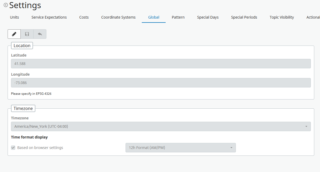

Patterns are offset in relation to sensor data
Patterns are automatically calculated by the solution for each sensor and zone and are represented in the graphs as grey bands. It is important to make sure that the right time zone for the digital twin is defined under  Administration >> Settings  >> Global so that the patterns can be set with the correct time zone.
