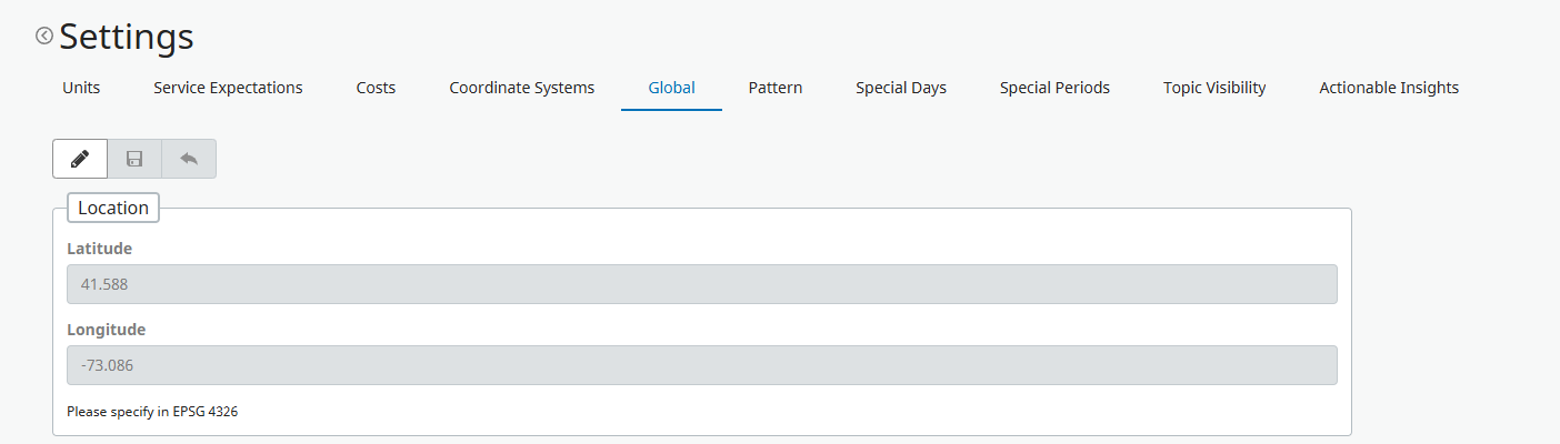

WaterSight can automatically bring weather data such as temperature, precipitation, wind and other variables for any specific location in the world (WaterSight can automatically connect to an IBM service to bring weather data). This weather data can then be used in WaterSight for visualization purposes and also to improve the zone demand patterns and forecasts calculations.
In order to correctly bring the weather data, it is required that the user correctly defines the coordinates of the digital twin (central place), in the Administration >> Settings >> Global. Only one location per digital twin is supported.
