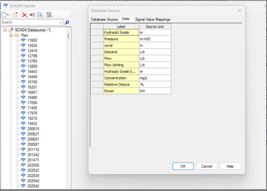

To check in WaterGEMS: go to WaterSight >> Numerical Models >> Previous Simulations. Download latest model. Open in WaterGEMS and go to SCADA signals, click on edit data source and go to units tab. If units are wrong, please update, save the model, and reupload again in WaterSight. Please note that these are the units for which measurements are being registered in the database and might be different than the display units!

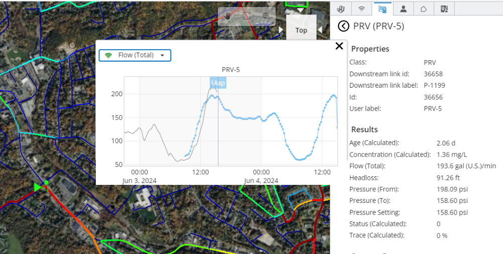

Fig 1 - Model value at blue does not match sensor measurements (black line) for the PRV boundary element due to mismatch of units defined in the hydraulic model and in the sensor configuration template
