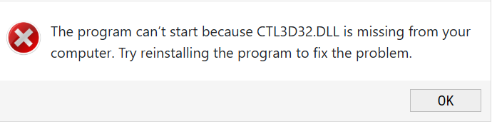

During start up the following message appears:
autopipe.exe - System Error
The code execution cannot proceed because CTL3D32.dll was not found. Reinstalling the program may fix this problem.
OK
or
'The program cannot start because CTL3D32.DLL is missing from your computer. Try reinstalling the program to fix the problem'
One of the most frequent issues encountered by Windows users is the absence of a DLL file. There can be many reasons why a specific DLL may have be moved / deleted
Example: Microsoft has discontinued support for 32-bit applications and software. Consequently, a recent update (Aug 2025) to Microsoft Windows, identified as KB5064081, seems to have removed CTL3D32.dll.
As this is a 32-bit Windows DLL, it only impacts all 32-bit versions of AutoPIPE (versions 23.00.00.230 and lower).
