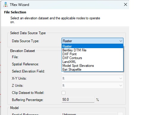

Raster file support for TRex
Raster files are now a supported source file type to import elevation data using TRex.
This was previously supported in the ArcGIS Pro integrated versions, but is now available in Standalone. More information on using TRex can be found here: Using Terrain Extractor (TRex) to assign elevations.

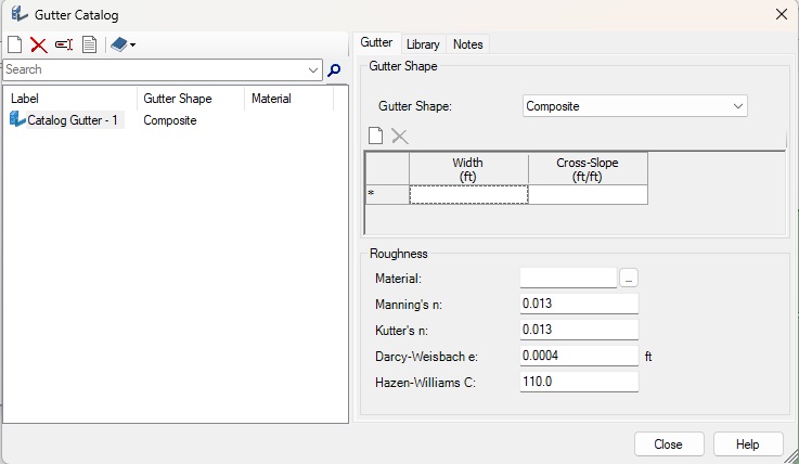

Composite Gutter Support
Composite gutters are now supported in the Gutter Catalog. If you select the Gutter Type to be a catalog gutter, you will see a “Composite” option for the Gutter Shape. In the Gutter Catalog itself, the composite gutter type will display a table with the gutter width and the gutter cross-slope.

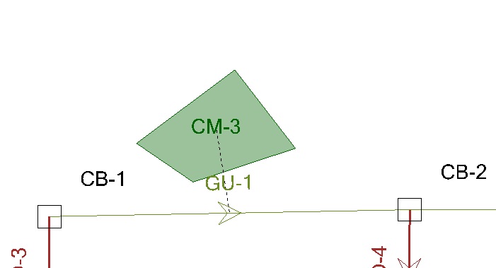

Support for gutters as catchment runoff elements
Gutter elements can now to selected as the Outflow Element for a catchment in the StormCAD (GVF-Rational) solver. When you use a gutter as the outflow element, the runoff from the catchment will apply directly to the gutter.

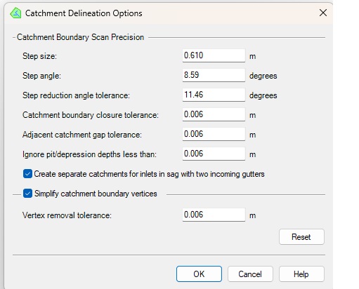

Automated delineation between two catchments to inlet in sag with two incoming gutters
When there is an inlet in sag with two incoming gutters, the Catchment Delineation feature in the Terrain Model manager will now create two catchments. To facilitate this, the catchment delineation properties in the Terrain Model manager as a new option called “Create separate catchments for inlets in sag with two incoming gutters”.

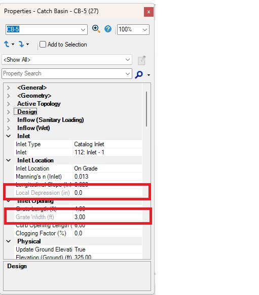

Catalog Inlet input available in Catch Basin element properties
The input for catalog inlets is now available as read-only fields in the catch basin properties. Since these are read-only fields, you will need to edit the catalog inlet, you will need to open the Inlet Catalog.

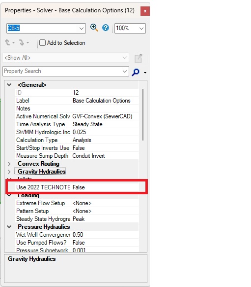

Support for HEC-22 TechNote for efficiency calculation of curb inlets on grade
Support for the calculations for the HEC-22 ”Technote Curb Opening Inlet On Grade” has been included for the GVF-Rational, GVF-Convex, and Explicit solvers. In the calculation options, you will now see an option called "Use2022TechNoteForCurbInletsOnGrade". If this is set to True, the calculations from the HEC-22 Technote will be applied to the calculation. For information on the Technote, see this link.
