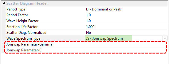

When using the SCATD input line and selecting the JS (JONSWAP Spectrum) option, the Gamma and C values:
SACS does not automatically recalculate C if the user modifies Gamma. Both values are independent input parameters.
Example
To run fatigue analysis with a Gamma value of 2.1, the user must explicitly enter the C value to be used in the analysis. If only Gamma is changed and C is left blank, SACS will still apply the default C = 1.525, not a recalculated value. Both parameters should be defined by the user if different values are intended.
